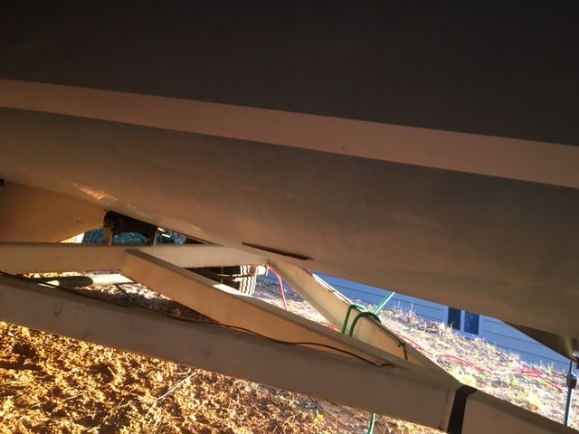

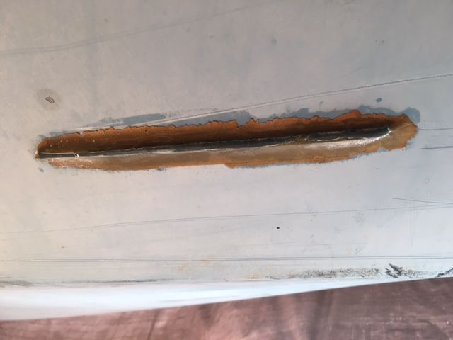

I've been ignoring this, it's been epoxied in place on my 1974 o'day daysailer, and was there when I purchased the boat. Its about 4ft from the bow on the starboard side, 5" long (ish). There is a mystery wire in the cuddy so I'm assuming its some kind of transducer? Any suggestions?

Doesn't look like any transducer I've seen. The picture doesn't really provide context. What are we looking at? Outside the hull, inside?
7,771
It helps. I'm sorry I can't be of more help. If you stick some sort of metal blade in there is there any softness? Is that the centerboard on the right side? Does it deploy from forward to stern?
10,153
my guess is botched repair.. it isn't purdy but if the boat doesn't sink.. it might be sufficient.

It seems solid, I'm going to see if its magnetic and check for soft spots. If it doesn't 'do' anything I'll probably just epoxy over it to be on the safe side.

Possibly a grounding plane to direct lightning strikes. Does it go through and attach to anything inside?

OK, I think I figured it out, Bud Gates wins the prize, there's a wire that feeds up from it and attaches to the mast. It's only about 1/8" thick so not sure it would really work but seems like someone was trying to rig a lightening grounding plane. I'm going to leave it alone and hope I don't get zapped. Thanks for everyone's input.

Well, the first picture doesn't show anything too clear to me. However, the second picture does seem to place this mystery attachment at approximately near the spot where it appears the lightning bolt that hit my boat 31 years ago exited through the bottom. Bolt must have come down mast, jumped the gap below cuddy interior decking and burned a half-Dollar-sized mark on the inside of the bottom of the hull. Boat developed a small leak after that, previous owner patched hole. Bolt also traveled down the shrouds and fused all the strands of the cable together as it passed over the spreader tips. Previous owner had to replace standing rigging after the shrouds broke at that fused point. That was how my boat got upgraded to the 1/8" rigging she should have had originally.
That happened in 1985, thankfully.. I've had no repeat strikes since I bought the boat in 1996. Well, except that weird experience a couple of years ago, when I was sailing on a clear day with threat of a T-storm. With the storm still a few miles away, I had a sudden sensation of electrical charge in my left arm as I held the tiller (wasn't touching any large metal objects, rudder is solid fiberglass ,tiller is wood). You can bet that my Dad and I quickly lowered and furled the sails and powered home! It took a few hours for the slight tingling to stop in my arm......
