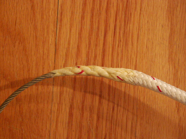

At the cross over point on a wire to rope halyard there is the stuff coating the rope portion. It is translucent pale yellow, flexible and slightly sticky. I would guess that it prevents the rope from unraveling. Does anyone know what this stuff is called and where it can be purchased? Thanks.
I have a rope/wire halyard on my genny and have had to dampen the slapping on the mast when the wind pipes up. The PO must have bought it new cause it was in good shape. The coating could be some liquid whipping. Here's a link...... http://store.hamiltonmarine.com/browse.cfm/dip-it-whip-it-clear-4-oz-131975/4,8542.html

I think you came up with the product I was looking for. It seems to fit my description. Thank you.
