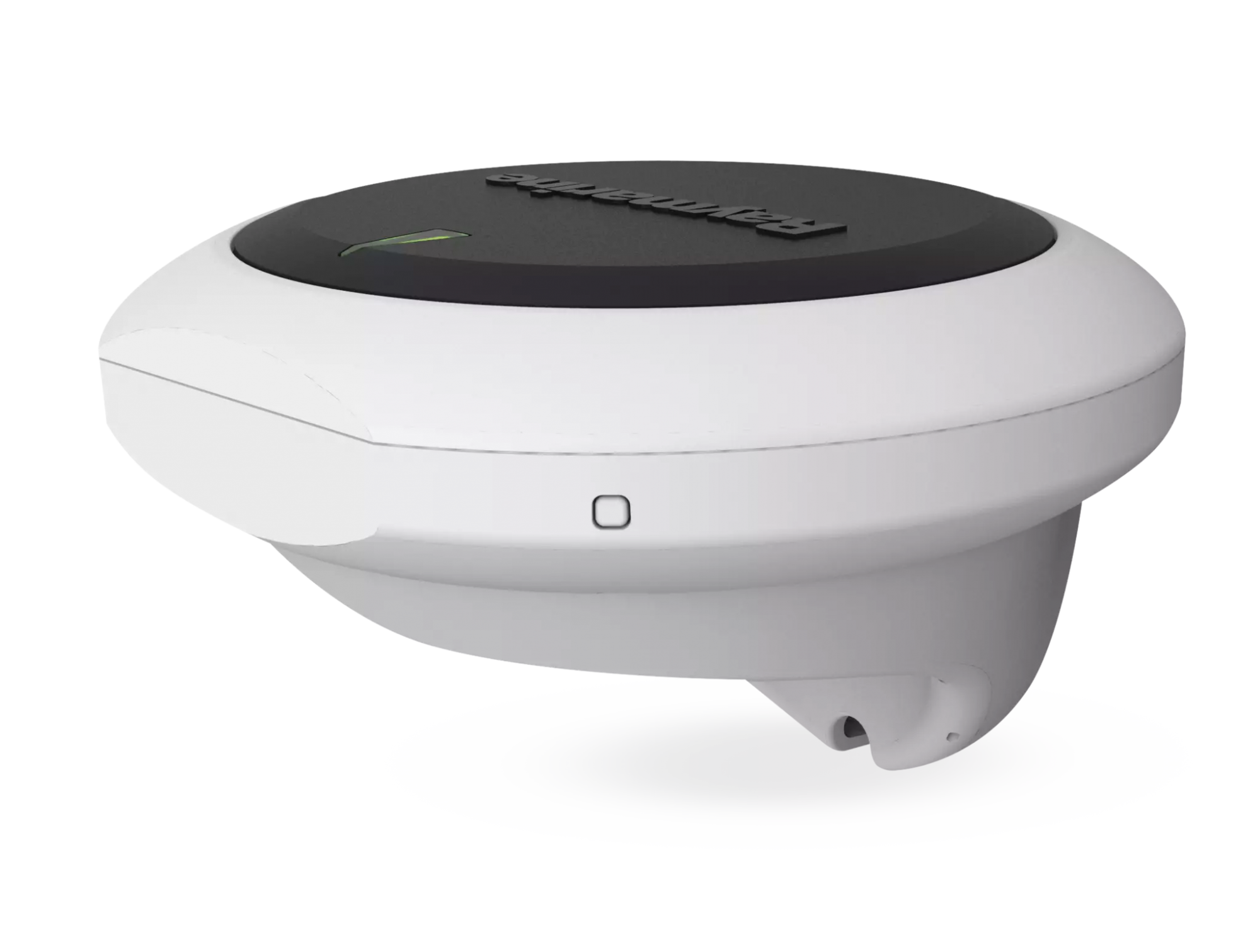

I have the EV100 installed. It serves as a cost effective tool. Don't put a magnet or metal mass near the compass sensor (the thing that looks like the space ship Enterprise).
Your AP will begin to make your boat do Crazy Ivans. The voice of experience.
