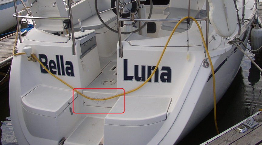

I am not planning to seal off the floor panel, just screen the slots. I may have it done later today. I looked at the other H30T in the yard. It's one year later than mine. He has the same setup. I think it's a dumb design personally
This is an older pic. I am attempting to show what little gap exists for crap that drops thru the slots to exit out the rear of the panel.

Looking at your picture, that is slightly different. I was on my boat this Saturday attempting to see what needs be done about replacing the deck hatches, and I did take note that yes indeed, I have a cut out slot at the bottom in the rear for water drainage, that seems to be lacking on your boat there.
Being the good sailor-to-be however, I failed to snap a picture of it to post here and went on about my business at hand. I will attempt to take that picture all the same this coming Saturday, but it likely matters not. If the design doesn't work for you, then fix or modify it. You own the boat after all.
