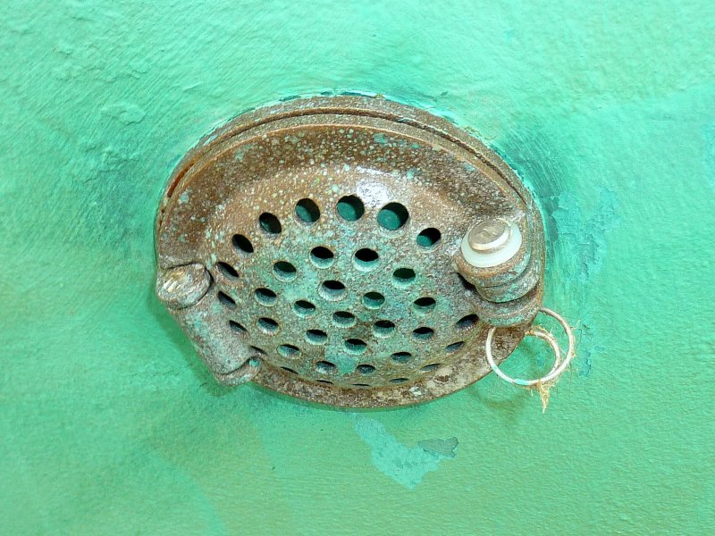

We have found that loss of a prime to the heat exchanger pump is not a function of plumbing in a rough seaway. It happens most often when we are beating into square seas at relative high SOW (say above 9 knots +) and occasionally getting some (as they say in skiing,) "air".
The AC pumps are not positive displacement pumps and eventually we "shake-out" the water between the pump and the raw water strainer. In my opinion, having a scoop facing forward on THAT intake (which is NOT the intake for either the engine or the head intakes) promotes maintaining the prime in the line.
As I said, we don't have scoops on any other raw water intakes. We also have robust and accessible strainers that we can inspect and clean on all but one head intake supply.
