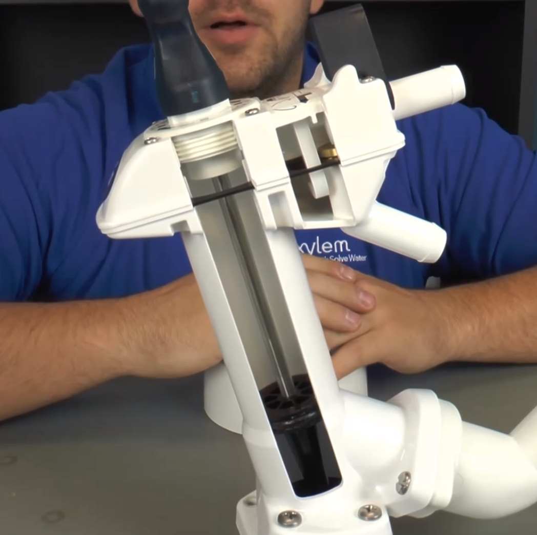

This is probably a dumb question, but on the standard lock/twist model of the manual Jabsco toilet, what is the twist feature for?
It shows a lock and an unlock. What am I unlocking?

From the Xylem website, form 2008:
The new ‘Twist ‘n' Lock' manual toilet system launched by Jabsco at METS found favour with the Judges who awarded the innovation a ‘Special Mention' in the ‘Interior Equipment' Category.
This simple, easy to use, development ensures that even on a poorly installed toilet system, water and waste cannot backflow out of the bowl. The design uses a remodelled piston in the pump-out assembly. At the end of normal pumping out, at the bottom of the pump stroke, the user simply turns the handle through 90o which locks the piston down onto the base outlet valve, keeping it securely shut. Turning the handle to the normal operating position opens the lock again."
I can't locate my owners manual- must be on the boat. I do believe that valve is actually an inlet valve to the pump, from the bowl. The piston rod holds the INPUT valve closed so stuff does not back up into the bowl. It works in concert with the joker valve. Personally, I don't think it works that well.

It locks the piston in the down position, and a central 'rod' below the piston seal presses/holds the bowl outlet flapper valve pressed against its seal. In operation this only seals when the pressure of a pump down-stroke pushes waste out the joker. If un-pressurized waste flows backwards on the old setup, the lack of adequate pressure lets it by the flapper and into the bowl. You can see the rod in the cut-away pump.
You have it backwards...it keeps back flow (waste left in the toilet discharge line because it's either way too long, runs uphill, insufficient pumping or all of the above) from getting back INTO the bowl.
I wouldn't want to be the person who leans over the toilet to flush it and unlocks it when combined with a blocked tank vent that's caused the system to become pressurized.
