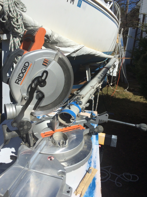

Much success with all of your great feedback. Lots of prep but a perfect cut! Thx for the last tip on alodine. I will find some. Only regret is marking the line with blue tape since it baked on after the cut. Nothing some acetone can't handle. Now on to remounting the mast step with one inch shim.

How did you cut that straight with the saw set to 45 degrees? Just kidding post pics of your 1" shims
