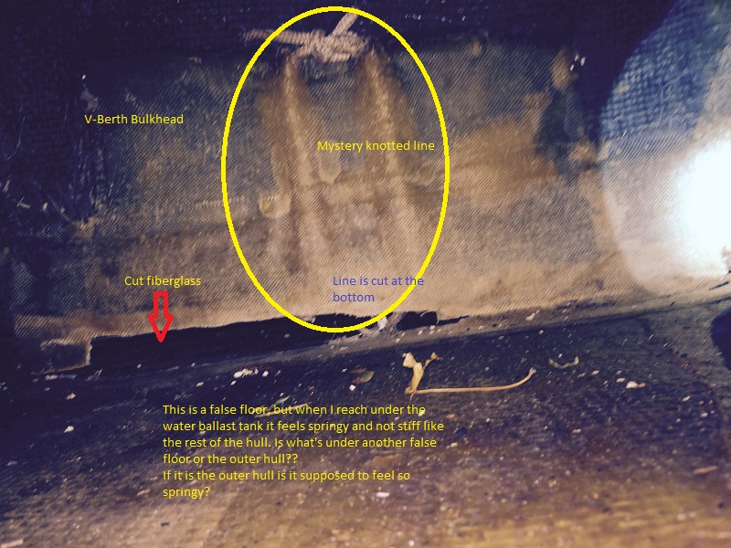

Good evening fellow sailors. I decided to take advantage of the balmy weather here in Montreal (6C!!) and survey the inside of Egret, my 1991 26S purchased last spring.
Since I am planning of adding double batteries under the V Berth I decided to take some measurements to see if I could insert two batteries without cutting off more surfaces. Anyway... I was surprised to find a strange rope running through two fiberglass channels attached to the rear bulkhead of the V Berth.
The rope is knotted on the top but cut at the bottom (see picture) and as it is, it serves no purpose whatsoever. Since it looks like a factory install I assume that at one time it must have served some purpose like, i don't know... maybe holding the whole boat together :).
The second mystery is the cut fiberglass where the floor joins the bulkhead just forward of the water ballast. Not only is the false floor in that spot springy but when I reach under it to touch what I assume is the actual outer hull, that too is very springy though, when in the fall I went under the boat to test the hull, it felt hard enough but I'm not sure if I was in the right spot...
I really would like to solve these mysteries, perhaps some of the old timers who have done major surgery in that spot can enlighten me.

Perhaps the rope was to give shape to those short stringers- to give some stiffness when fiberglass is laid over it?

Summer might have nailed it but I'm still puzzled by the floor. I'm asking myself how many layers of floor are there before we reach the hull? Impossible to answer without major surgery. I'll probably pour some epoxy between the layers and re glass the floor to the bulkhead before installing the batteries.

I agree with sumner, lift point for assembly.
The floor of the vberth is the top of the water ballast. its thin. couldn't hurt to build it up.
-I added a layer of mat before I used it for cooler storage.

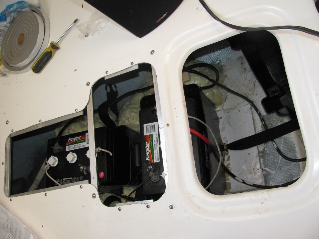

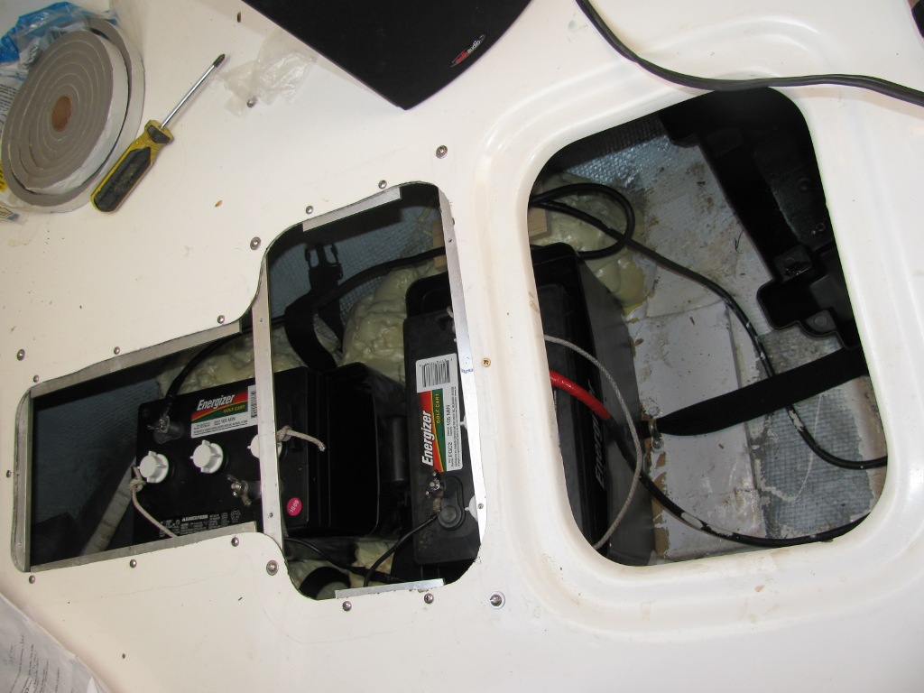

I also put my batteries (two golf cart 6V) up in the V berth as far forward as I could get them. It a good place for the weight sailing wise, definitely a great place for balance of weight for trailering. If I had to do it again, I would do the same. I dont remember anything that seemed soft in that area but I did add a piece of plywood over the ballast tank area to distribute the weight of the batteries. The plywood is glued to the hull glass plus I put a layer of glass over the top of the plywood. Epoxy is always the best glue for strenght but in this case Im pretty sure I just used polyester resin at least for the extra layer of glass/resin over the plywood. I did this maybe eight years ago.. Going sailing today, maybe I will take a peek in that area to see if I can find that same soft spot. I also added extra access specifically for the batteries so that its not such a pain to add distilled water.

The plywood is glued to the hull glass plus I put a layer of glass over the top of the plywood. Epoxy is always the best glue for strength but in this case I'm pretty sure I just used polyester resin at least for the extra layer of glass/resin over the plywood. View attachment 118751
Thanks for the picture. I was looking for a solution for re-mounting my battery bank since the set up that was in the boat was rotting away. I like the idea of bonding a piece of plywood to the hull to reinforce the area.
Is that expandable spray foam around your batteries?

The picture I posted earlier is still the best I could find. My two batteries are in the plastic boxes specifically made for batteries. You will eventually spill a little acid in that area (maybe while putting water in the battereis or??) but I didnt want any screw holes in the bottom of those boxes to either corrode the heads of the screws or have a way to leak acid. Before the load distribution plywood was glued/glassed/anchored to the hull tank, I had put some backing plates on the bottom of the plywood so that the eye straps are strong and the plastic box's are just held in place with straps and the eye straps (but with backing plates). For a little extra horizontal stability, I did put in that expansive foam that is both bonded to the hull in the at area and the plastic boxes. Its held up well for all these years with a fair amount of sailing in about every condition you can think of but the boat also has never lived in a area where I have to worry much about that expansive foam absorbing any water.
FYI, with the batteries forward like that (and weight centered), I still put drinking water up in that area but in one gallon jugs. I think I can get about 15 gallons up there of so (more than I well ever need with this boat). I just pull out one or two gallon jugs at a time when needed. I haven't used that capability for years now since Im mostly marina sailing and camping for just a couple nights so good to not be carrying around the weight for something Im not using.
