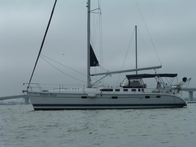

Geez, now that I review what I wrote maybe I need to trade up. That H46 I chartered in St. Pete has all those features. As seen below in front of Marina Jack's. :)
