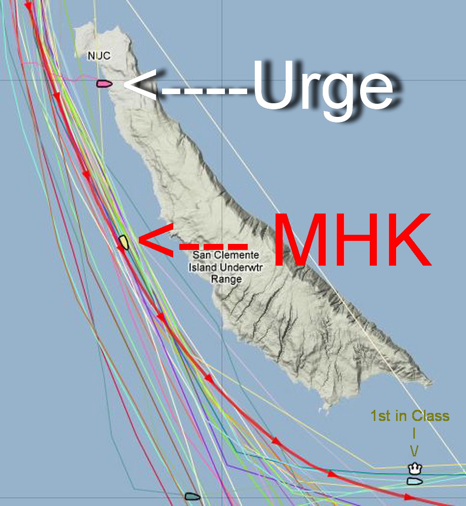

It is really easy to 2nd guess. But I'd like to see their course/plot line with that weather to see how much leeway they allowed San Clemente. Of course, no one considers a broken rudder, were extra they aggressive in theiir route planning considering weather conditions?

As you can see, they were on about the same line as all the other boats when it all when wrong. The boat was full of great sailors, including the boats designer. They felt they had enough time to sort out a jury rigged steering system.
As others have noted, all the tricks that they teach you in ASA102 are pretty much worthless in the sea state they were in. The only good option is a full-on emergency rudder, in a transom mounted cassette as shown below. Sadly they didn't have one.
