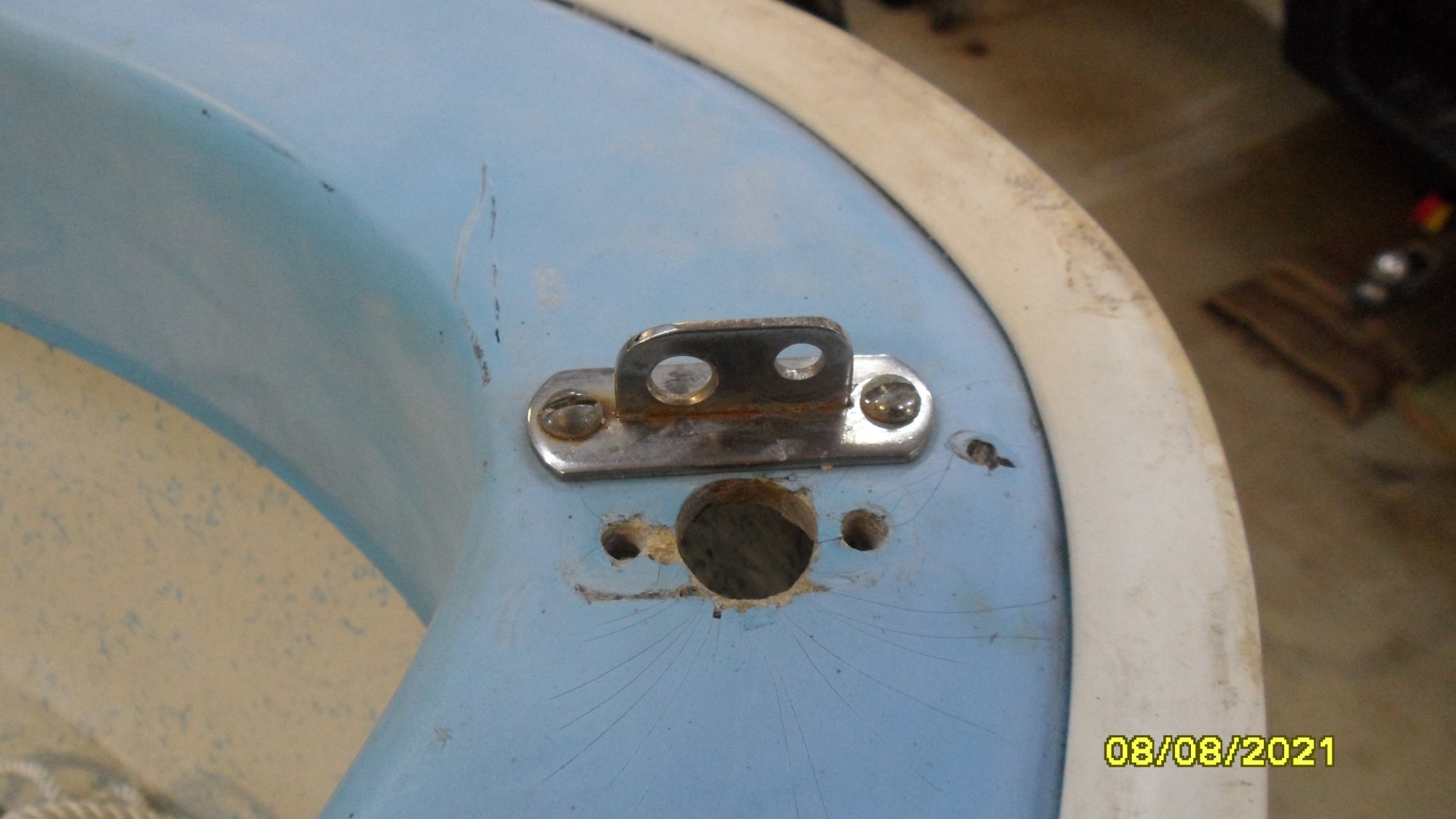

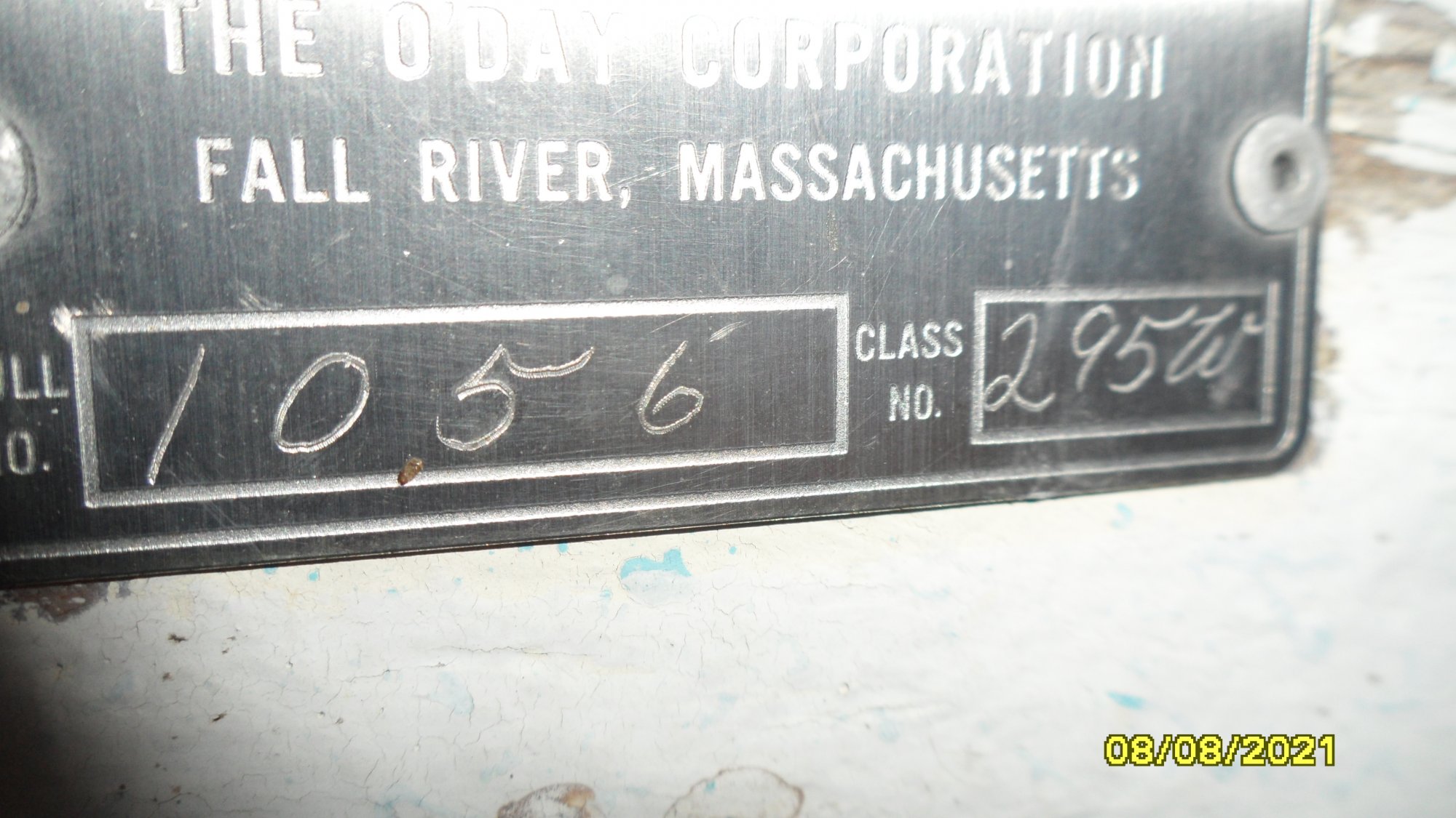

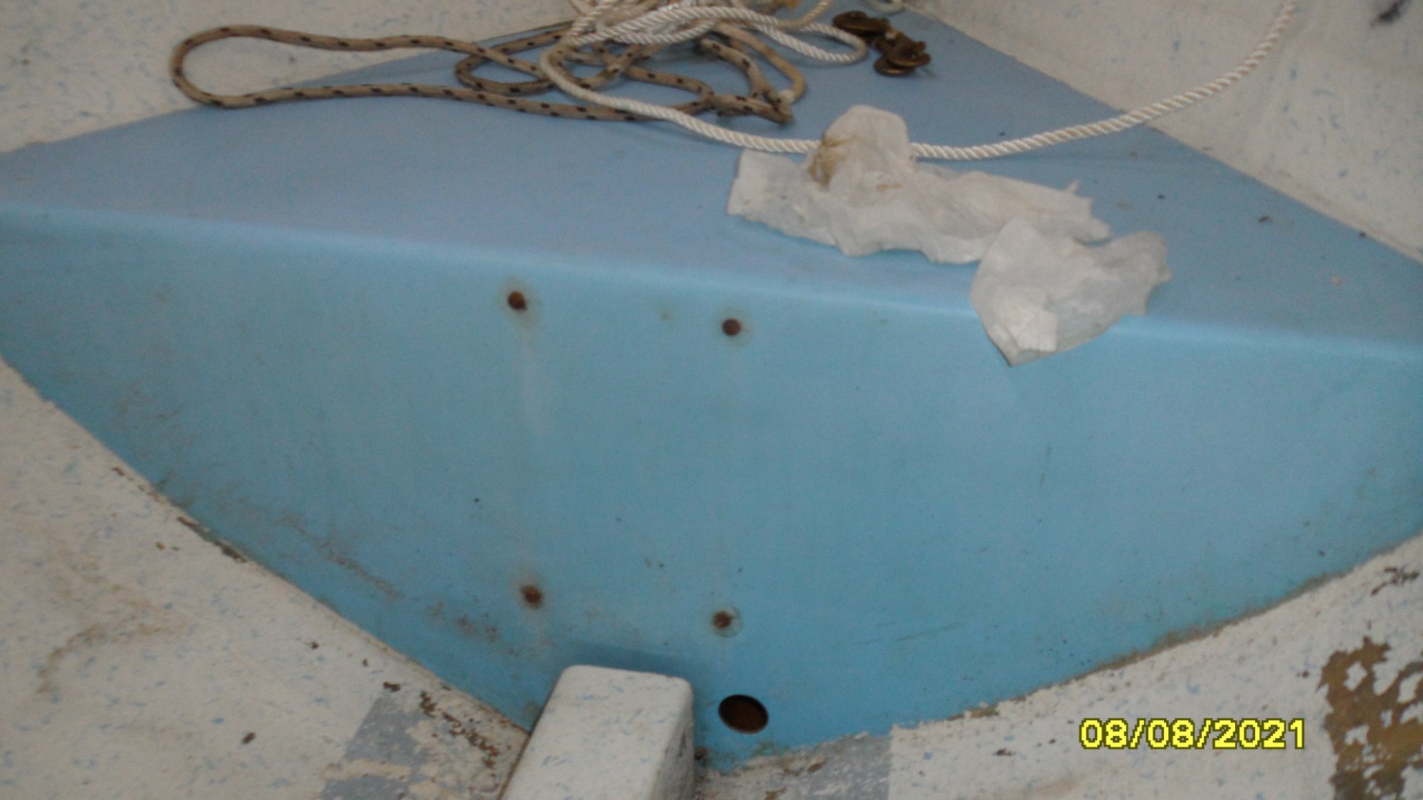

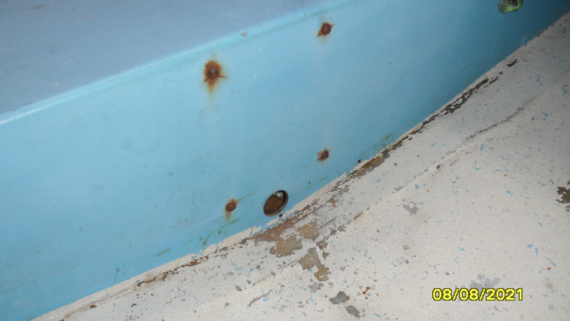

I have several Questions I am new to Widgeons what are these screws for, they are fore and aft they are probably not stock to the boat , 2nd What year is my Widgeon hull # 1056 and the class is 295W just wondering. 3rd Does anyone know what this hole is next to the forestay Bracket. Does any one know where I can get parts? Thanks for your help in advance

1. My best guess is previous owner screws installed for an unknown reason as an internest search on "O'Day Widgeon images" did not see these. Suggest removing the rusty screws to see what they connect to and replacing them with new stainless screws or if not functional filling the holes then gelcoat to make them dissappear.
2. I assume the boat does not have a hull number and built before November 1, 1972. Year is likely 1965 based on Hull ID Help - Mariner Class Association (usmariner.org) .
3. Again my best guess is previous owner holes drilled for an unknown reason as an internest search on "O'Day Widgeon images" did not see these. Suggest filling the holes then gelcoat to make them dissappear OR create a new function for them.

I used to have a 1969 (might have been a 1970?) Widgeon, do your boat looks familiar. I'd place the age at 1963, maybe 1964, possibly from the first year the Widgeon was built! HULL# refers to total O'DAY production (all models) Class# refers to that class (Widgeon in this case). You have the 295th Widgeon built, so she must be an early one! Mine was Class# 1791.
The rusty screws in both forward and aft seats/flotation tanks are definitely not factory stock, but it is interesting that they appear the same pattern, like there was something mounted in both locations that matched? Hole don't look big enough to have been for fittings for a lifting setup, and I can't think of anything that would be inside those areas to match the screw hole pattern. Hmmm?
The hole where it appears some kind of fitting was located next to the stemhead fitting (forestay chainplate/jib tack connection) might have been for some kind of jib downhaul line? I think it can be filled in without worry.
