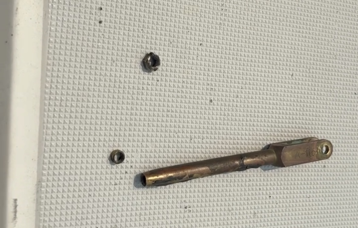

I was taking my 1988 O’Day 322 out for a sail yesterday. Light winds, but I was hoping to make a go of it.
I got the boat ready, and even cast off the lines before I started the engine. Winds were so light, the boat barely moved in the slip…
I started the engine, and moved the shifter from Neutral to Reverse to back out of the slip...when BANG…something broke in the pedestal and the shift lever just dropped limp. All I can say is I’m glad the transmission didn’t engage in Reverse before the shifter broke. As it was, I could jump on the dock and tie the boat up so I could figure out what happened.
But I did think about it afterwards….what if the transmission would have engaged, and then the shifter broke? Would I have had the calm nerves to just back out to the fuel dock and tie up there? Or head for the open lake and cut the engine and drop the anchor? Or would I have panicked and hit the boat behind me? I will never know, I guess. But good food for thought.
After investigating and removing the compass from the pedestal, I found that the Edson “fork” linkage broke. The fork connects the transmission lever to the Morse cable. The Morse cable threads into the fork and in my case, the cable was only threaded in about 2-3 threads…and the tip of the fork linkage broke right off.
In this photo, you can see the fork, the broken tip and the lock nut that keeps the cable from backing out of the fork. I am assuming the cable was never threaded in correctly as the locknut was tight against the broken off threaded tip.
The good news is that:
1) I was able to thread the cable into the remaining threads on the fork linkage and it is was more engaged than it was…and I can use Tally Ho
2) I found a new fork on eBay for $15 and it is on its way…probably just become a spare for now, but it will be available if / when I need it.

In this case, I was in no danger of hitting another boat or a dock since the cable broke BEFORE the transmission engaged. That would have been a whole different story.
And yes Stu, I will install the new one when it comes (and I will check the thread engagement if the throttle cable too).

I just shudder when I think that I could have been coming into the slip under power, and at the point I usually slow the boat down, boom…the cable breaks. Yes drop the throttle, but I am still going to hit the dock!
New part is in the mail :yikes:

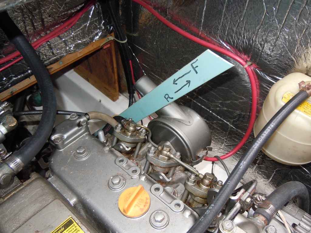

It all comes back to me now. July 4, 2012 we were just leaving the slip in Alameda to participate in the 60th annual Boreas Race from San Francisco to Moss Landing. I shifted into forward and crunch, the entire Merriman plastic control head under the compass fell apart. No more shifting, but at least the throttle side still worked. My wife took over the controls and I could reach over the running engine carefully (long arms) and shift the lever right at the transmission based on her directions. We made it to the start line in time. Also, concurrently we were the cruise leaders for our annual Oakland Yacht Club Bluewater Cruise to Monterey for a week with a fleet of 4. We weren't going to let that stop us. That year for the first time the race was split into two days to avoid people sitting out in the ocean with no wind all night long. Our first stop was at the Half Moon Bay Yacht Club. We crossed the finish line in Half Moon Bay in second place at 8:30pm and took a slip for the night in the harbor. The race did not resume until 10:00am the next morning so I had time to rummage around the boat and find a large batten that I must have been saving just for this purpose. A new shifter extension was made and it worked perfectly for the rest of the week. And by the way, after the next day's results were tallied, we won the entire race. With all the extra rules in place for offshore racing that race has never been run again. So after 14 years we are still the reigning champions of the 60th annual Boreas Race. Boreas is the Greek God of the North Westerly wind. All downwind, which was ideal for our Hunter 34. We surfed at 11.3 knots and had to dodge whales. Luckily our Dutchman Boom Brake prevented any disasters with a few accidental jibes. Our friends on a Hunter 466 weren't so lucky and snapped their boom in half on the way down. They were just on the cruise portion, not the race.
Here is the link to my Merriman Control Head repair. This was before Phil was able to source them again for the store. After what I went through to fabricate a new one, it's worth every penny for what they sell for.
