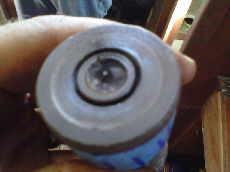

Also, I got two of the three injectors out. i had to use a pry bar and keep bumping it w my hand til it finally came out. the last one is stuck hard. i pb blasted it before i left. the i dont know what they are supposed to look like, but they looked brownish/rusty but smooth. there was some carbon on the tips. i attached a poor pic. before i left, i poured Marvel Mystery Oil in the two open injector holes. it took the whole bottle and then all of a sudden it started pouring out of the air intake. is that normal? i guess the valve was open. i closed the decompression levers and it still poured out. the middle injector held half a bottle. i filled it to the top of the opening. guess i didnt really need to.
