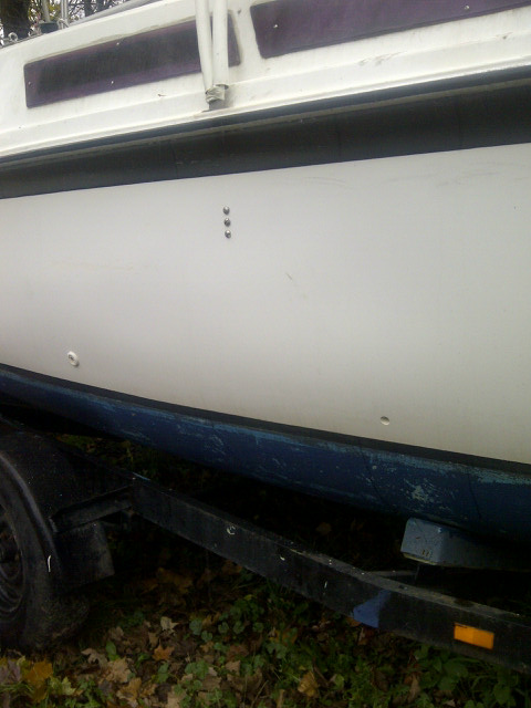

Sadly on my boat someone just got the paint out and went at it. It's flaking off ware it was applied over the dirt... The other spots are so thin you can see the other color coming through.
I'm planing a full hull and top strip and repaint this spring.
