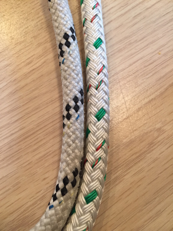

Anyone know what type line the black flecked line is?
The green fleck is Samson XLS Yacht Braid.
The difference I see is that the black fleck is braided using a 2 strand line instead of 3 strand and the braid is much tighter/smaller than that on the green fleck line.

The Marlowbraid is close but does not match but that did lead me to the Marlow Doublebraid with 24 plait cover that looks very close except for the fleck pattern. I don't care about the pattern, just looking for the same type of line.

right side looks like Samson xls yachtbraid. The red/green tracer line lead me to their mfr site......the other I haven't seen.
no need for am exact replacement, get a suitable size/type from reputable manufacturer and you will be fine. Each site will have recommended lines based on application.

In 2005 the in mast roller fuller line was 10mm. I had to replace the line on my 2005 H44 recently and initially thought that the 3/8 line felt a little thinner as compared to the 10MM so I tried the 7/16 which was a little thicker at 11mm and would not run through the blocks after splicing. I contacted Selden and they recommended to use the 3/8 line which is 9.5 mm and specifically Sampson Yacht Braid. The 3/8 line seems to work just fine.

The line on the right is Samson XLS Yacht Braid.
The line on the left came off my Furlex 100S.
I just spoke to a Furlex dealer who said you can't get what they originally used and now they just recommend Samson Yacht Braid as Marc said.
