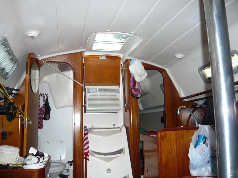

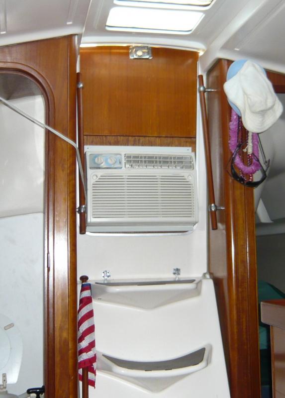

I put one of the free standing units in a 28' Beneteau. The exhaust hose put off so much heat that it defeated the cooling . I subsequently cut a second set of hatch boards to accommodate an inexpensive window unit and it worked fine. See photo. Another advantage of the window unit was I didn't have to move or secure it when I sailed.P1000073.jpg
