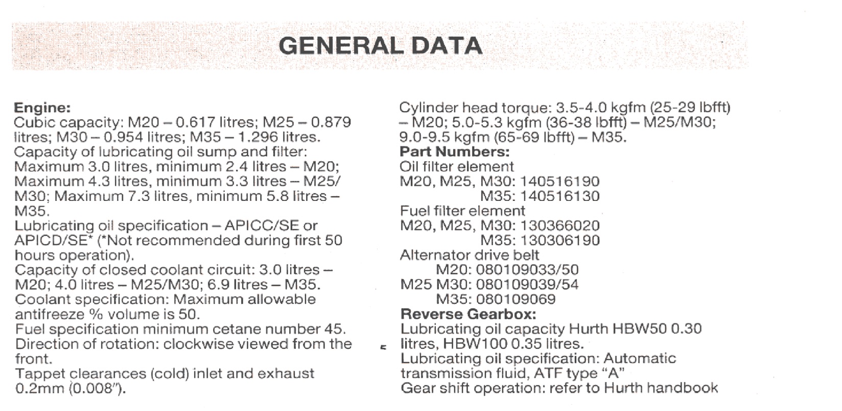

jssailem SBO Weather and Forecasting Forum Jim & John Oct 22, 2014 24,817 CAL 35 Cruiser #21 moored EVERETT WA Jan 24, 2021 #2 From the Marine Diesel Perkins manual you would use ATF TYPE "A" transmission fluid. Then there is this info about Type A and other fluid options. Tech 101: Type A Automatic Transmission Fluid | Rx Mechanic Here, we shall learn more about Type A Automatic Transmission Fluid, have a glimpse of other types, and how to choose proper oil. rxmechanic.com Likes: sail sfbay

C captcoho . Oct 29, 2012 358 Catalina 30 TRBS MkII Milwaukee Jan 26, 2021 #3 jssailem said: From the Marine Diesel Perkins manual you would use ATF TYPE "A" transmission fluid. View attachment 189517 Then there is this info about Type A and other fluid options. Tech 101: Type A Automatic Transmission Fluid | Rx Mechanic Here, we shall learn more about Type A Automatic Transmission Fluid, have a glimpse of other types, and how to choose proper oil. rxmechanic.com Click to expand After reading through the Tech 101..... It would seem to be clear as mud. The HWB-50 in 1988 called for Dexron lll
