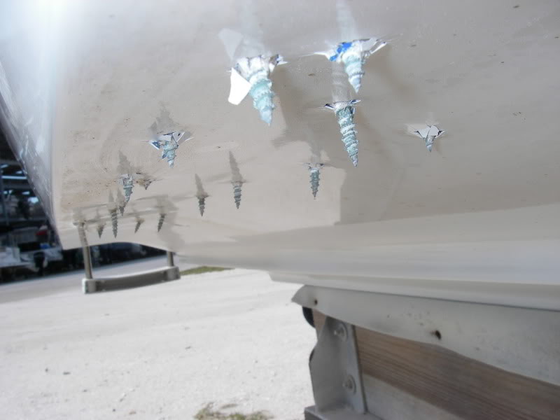

14,193
I'd love to hear the story behind that photo. What were they thinking?
Mar 23, 2015
259
Catalina 22 MK-II Dillon, CO
I first saw this pic many years ago but don't have any background. Whatever they were doing, at least it is firmly affixed ...

24,793
I think they abandoned the idea of laminar flow and decided on the disturbed look.

You can right-click over the image and "search Google for image" to see that several sights have used the picture as a warning to others. Makes me think of this poster -
