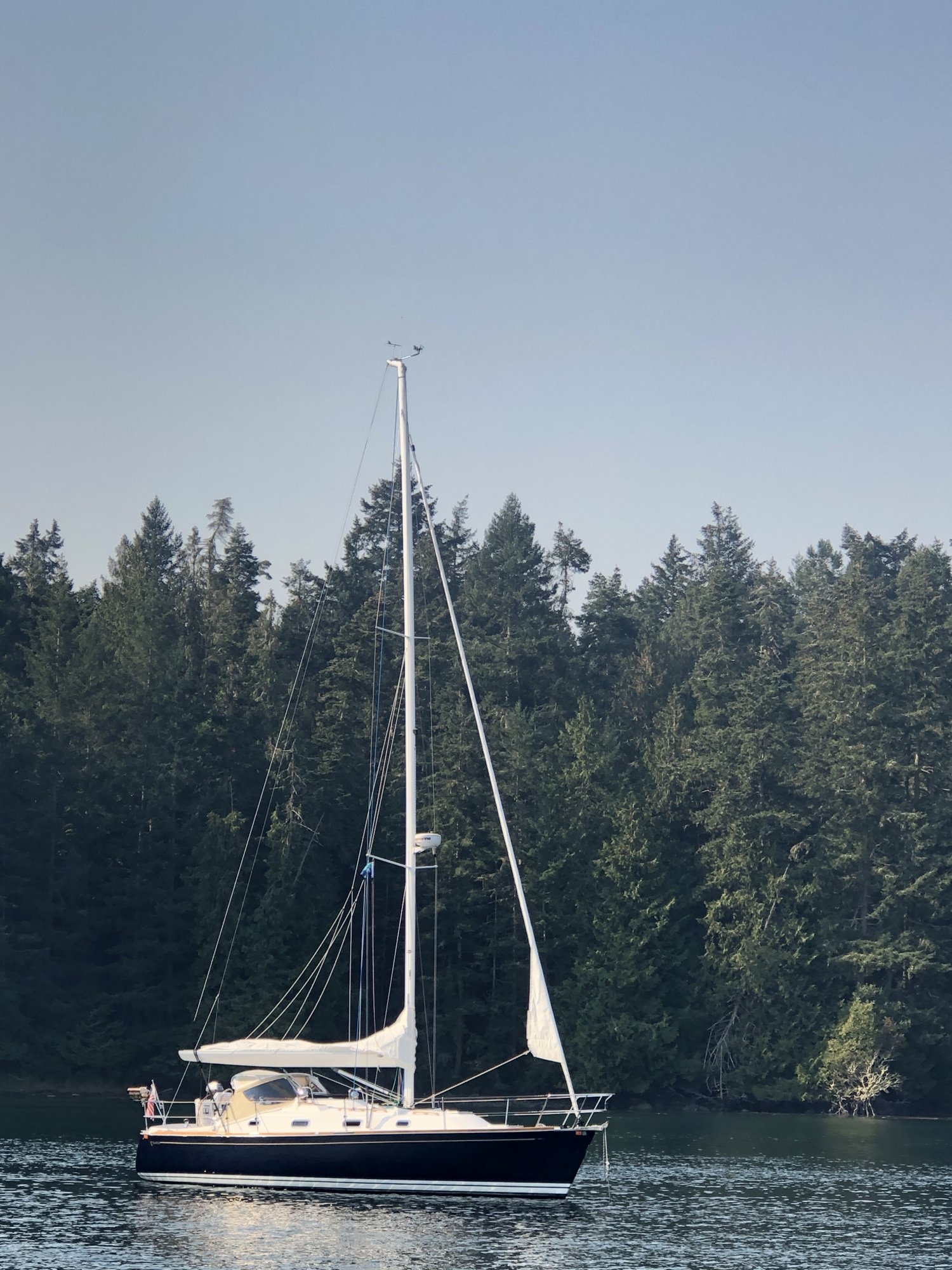

I thought of you as I read your review. We had a nice time in the cockpit, sipping rum and exploring our sailing adventures. Able to "socially distance" yet not have to shout. Way back in early covid days.
She was a pretty boat at anchor in Park Bay, San Juan Islands.

As I said, beautiful yachts. Here in an equally beautiful setting of the PNW. Notice she’s flying the SBO burgee! Thanks John!
