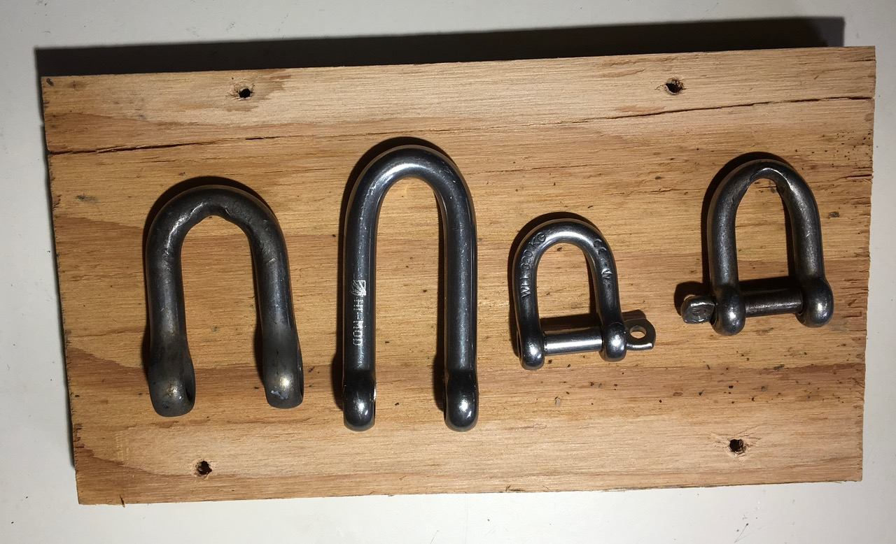

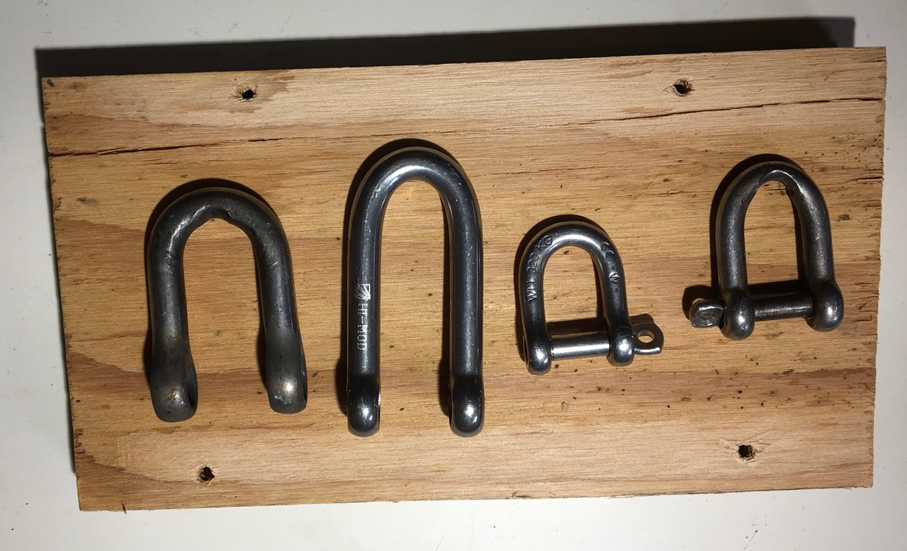

The rigid vang will support the mast, however, there are two issues to deal with, one is supporting the mast and the other is preventing or reducing the amount the boom swings while at dock or anchored. Since the rigid vang is spring loaded, it will cause the boom to bounce up and down, this wears on the vang and the shackles attaching the mainsheet to the traveler and boom. And, with all that movement, the vang may well squeak a lot.
It is best to stabilize the boom, a topping lift or using the main halyard is one part. The other part is using the traveller, main sheet, and a third line to secure the boom. The less the boom moves, the less wear on the shackles connecting the traveller to the sheet. Notice the wear on the first and last shackles, it's not the best photo, but there is significant wear and reduction in strength. Left unchecked the wear can result in a catastrophic failure in the shackles leading to a wildly flailing boom.

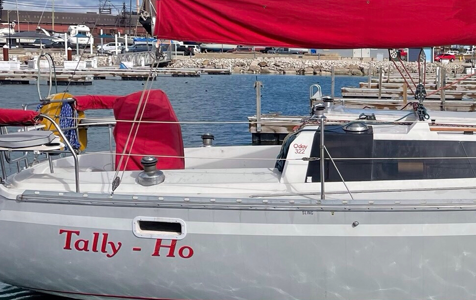

Hi Dave,
Yes, I do have a line that I use to keep the boom from swinging around when at the dock.
If you look at this photo, you can see a line (on old vang setup) that I use to hold the boom over to one side.
Greg

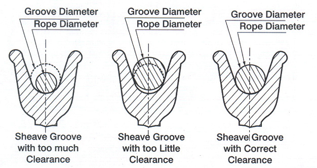

Size is dependent on the sheave. I suspect 5/16 to 7/16 is viable. I lean to 3/8th for feel.

measure the size of the old rope
The best is to measure the sheave. If you can’t do that then the scond best is to measure the diameter of the old rope.
Rope sizes in sheaves.
Sheaves for wire/rope halyards typically have a second inner groove in the center designed for the wire section of the halyard. For the wire/rope halyard’s on my boat, that is the way my original sheaves were designed. When I changed over to all rope halyards we sanded the sheave to remove that inner grove so the sheave would more smoothly handle the rope.
