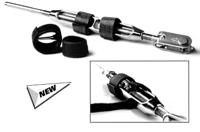

Some things to think about. If you are in a storm, wind and waves are big problem especially at night. With the rig hanging over the side, your boat will turn abeam to the wind and waves. Turing on the engine is not option until you clean the rig up. We had violent 4 foot disturbed chop which caused our boat (Sabre 28) to roll 25 degrees each way and pitch enough to bury the bow. A dangerous condition for the crew to deal with the rig. The drift pin punch is a good idea once you get rid of those pesky cotter pins which can be fun when the boat is bouncing all over the place. We had "wrap pins" which have velcro straps on all the turnbuckles. We ripped out the pins easily and unscrewed all the turnbuckles which worked brilliantly. Cutting things like vectran core halyards was tough until one of the crew whipped out his ultra sharp serrated blade rescue knife. Make sure you have a serrated blade knife for the hi-tech halyards and sheets. Our mast failure was catastrophic as it broke in 3 places and literally exploded as it left the boat. I like the idea of a 18 volt sawzall to cut away things like the foil or mast stub.
