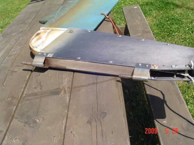

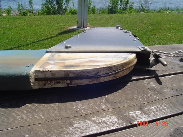

I suspect someday I will need to replace my foam-filled rudder (mine is probably the original rudder from Foss Foam Inc.) - but for now it is in good shape- and I am just a recreational good-weather only same-lake sailor. I am still using a rudder with the foam urethane core with fiberglass covering.

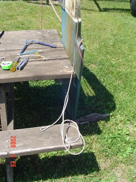

The rudder has the uphaul and downhaul pendants- which work with effort --- the raising and lowering of the rudder using these pendant lines have all of the already- discussed issues; Specifically, the downhaul pendant cleat sometimes fails and rudder raises a bit and creates weather helm, or floats to surface making steering very difficult, or the uphaul pendant line sometimes gets stuck in the rudder head and/or just needs tremendous muscle and leverage hanging over the transom in order to raise rudder.

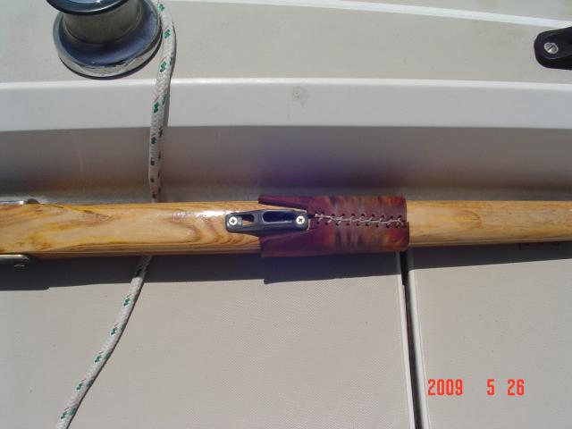

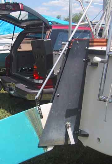

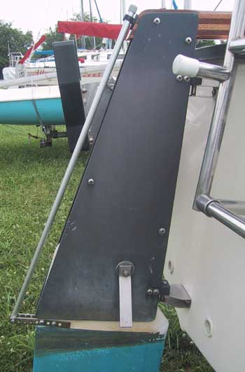

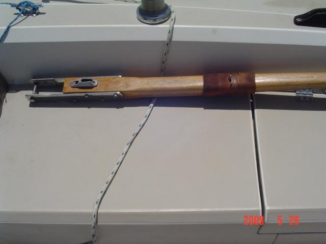

I am considering two options to improve the reliability of the rudder - specifically to more quickly and easily control the rudder. On the Precisionowners site, I found a modification using a rod attached to the rudder in order to push the rudder down and to pull the rudder up without having to lean over the transom. Pictures are posted below and here is the link: http://precisionowners.com/Pearce_rudderlift.htm
I am also considering switching out the stationary/traditional clam cleat that holds the rudder in a down position and replacing it with a clam cleat that is designed to release, should the rudder strike an object. Not sure this new clam cleat will work any better to hold the rudder down- however it may help to ensure the rudder does not break in case of hitting an object. Pictures are posted below and here is the link: http://www.clamcleat.com/cleats/cleat_details.asp?theid2=78
Question 1: What systems have you put in place to improve ability to raise or lower the foam-filled kick-up rudder?
Question 2: Do you think the precision owner modification would work better and more reliably to raise and lower a foam-filled rudder?
Question 3: a) For those who have used the CL257 - Auto-Release clam cleat , how do you like it? b) Does it work to keep your rudder down? c) Did the quick release work well? d) How did you go about setting the correct tension?
