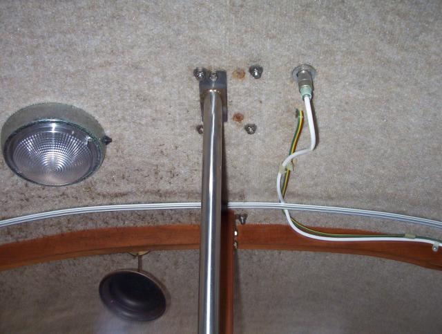

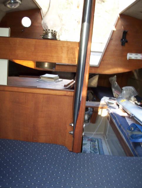

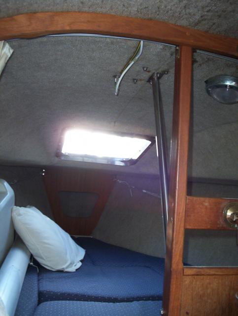

Oct 10, 2009
1,115
Beneteau 393 Muskegon
If it's the piece that is indicated in this picture, then it needs to be replaced. That's the compression post, and it supports the mast. I don't think it would be particularly hard to replace it, especially if it's already gone. Mine is made of hardwood- looks like ash.
