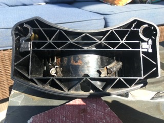

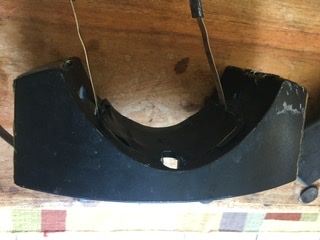

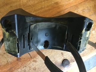

Ron, I was surprised too. Here are some photos fwiw.

That is not likely HDPE, it not commonly used for injection molding parts like that. It could be ABS, maybe polycarbonate...
For machining a new one, don't worry about the internal structure. Just make it solid. The ribs inside are only to make it moldable. Injection molded parts need to have a fairly uniform wall thickness then they add those ribs for strength or stiffness. Machining a new one you can keep it solid. If you tell the machinist how it is being used they will sort out which features need to be replicated and which don't.
If it was me, I'd probably print one. But then I have a 3D printer in my basement ;)
