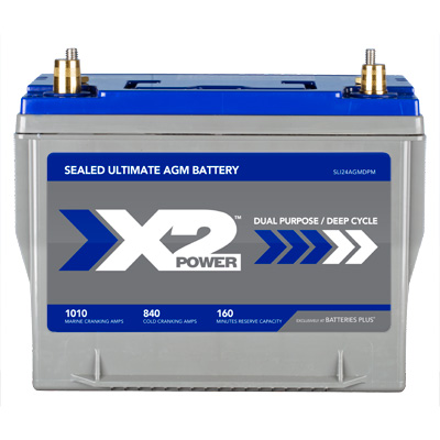

X2 Group 24 is what I placed in my 33.5 last fall when I bought the boat. Previous owner was a bigtime walmart/home depot believer as my boat is littered in non stainless steel and other non marine rated equipment. It had some walmart special for the starter which of course was dead as a doornail. I personally would never put anything non-marine rated in the boat, especially as the starter/backup battery. They come with enough cranking amps to start the auxiliary as well as enough amp hours to provide backup 12v supply to critical loads (such as fans and lights while working in the boatyard.) Marine batteries also have fully sealed and tinned terminals, not bare copper which is a very bad idea in a saltwater environment.
I will probably get a second identical battery to this and tie them together as backup for each other. Of course the secondary battery bank will be fully LiFePo4 and the two separate banks would be connected together with a DC-DC charging system so the aux can charge the primary while the solar chargers can charge the backup.
I could probably be wrong in this but I'd rather spend the money than being cheap.
