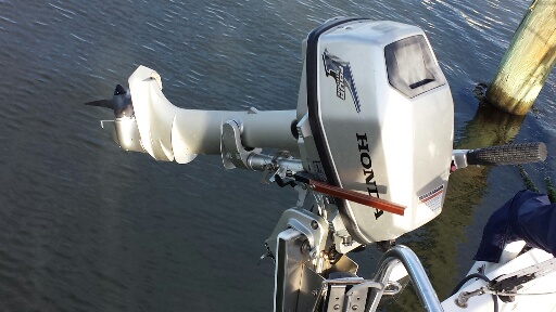

Whatever I make, for the shifter, I will post the Photos here. And would be glad to make copies for the other Honda owners!
I'm getting inspired - will probably just be a pipe over the top of the shifter with a few angles making it easier...

What about a remote shifter/throttle lever? you could mount it to the inside of the transom and them not need to reach over the stern. It would be out of the way on the stern.

I saw one if those ten years ago on a 27 footer. it looked like the arm off the motor attached on the port deck, pointing forward, six inches ahead of the transom.
I didn't like the look - but can sure understand the "need" now!

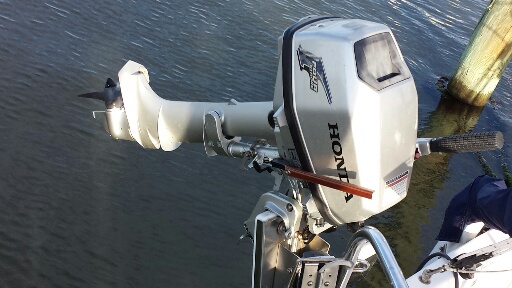

I got the shifter extension mounted but didn't get any photos, yet
works well, I can look forward and shift all I want - just a piece of leftover maple trim from our kitchen cabinets about 8 to 10" tall bolted to the outside of the shifter through the two holes already present in the shifter.
It is the Honda 5....
