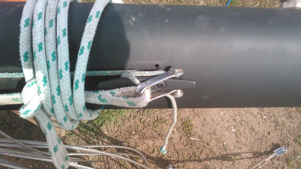

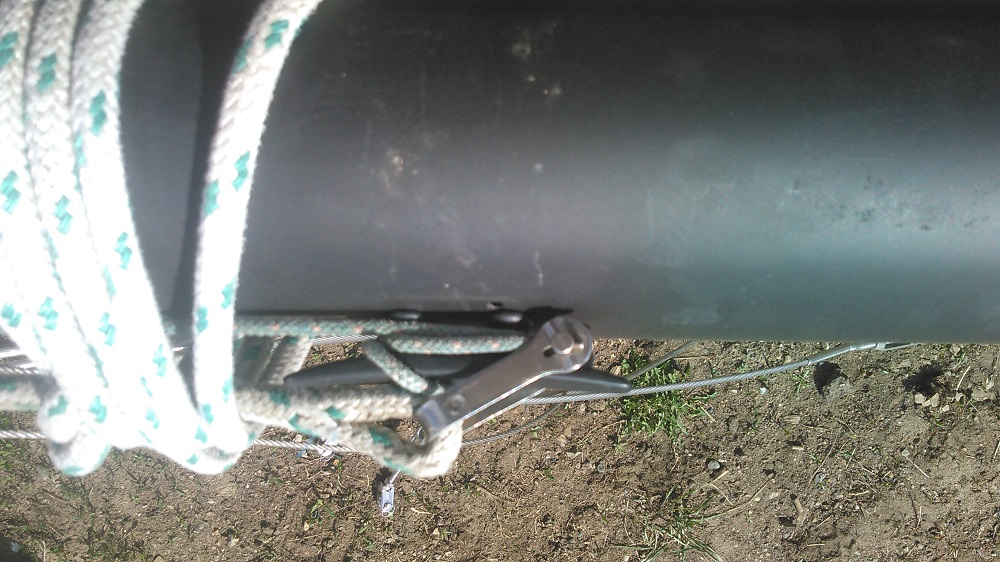

well my new halyard line came today. 5/16 vpc from Milwaukee rigging. $1.09 foot. I made my first spice (not pretty) and I forgot to put the shackle on. now I have to look around on the internet for a better way and if there is a specific slice for VPC. also I saw that the wand was better to use than the fid. looking into that also.

Just watched a video, the mistake I made was the second mark, I made it at the top of the loop instead of the bottom. (Pictures worth a thousand words) or two in my case.
