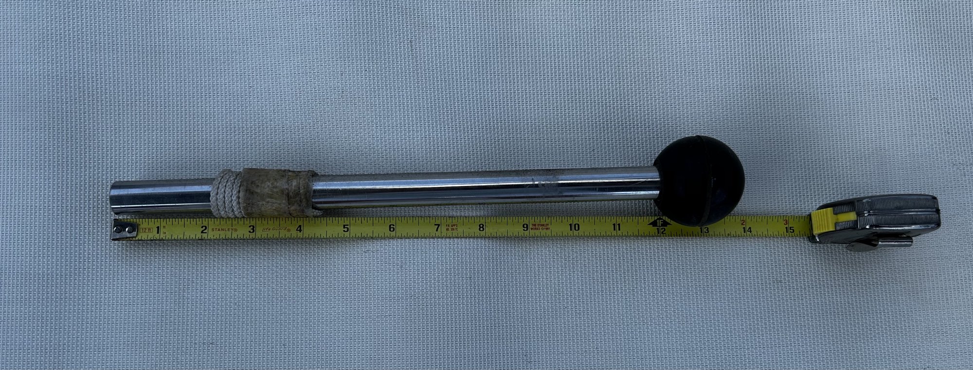

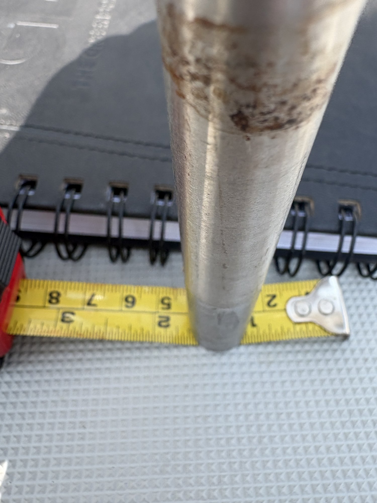

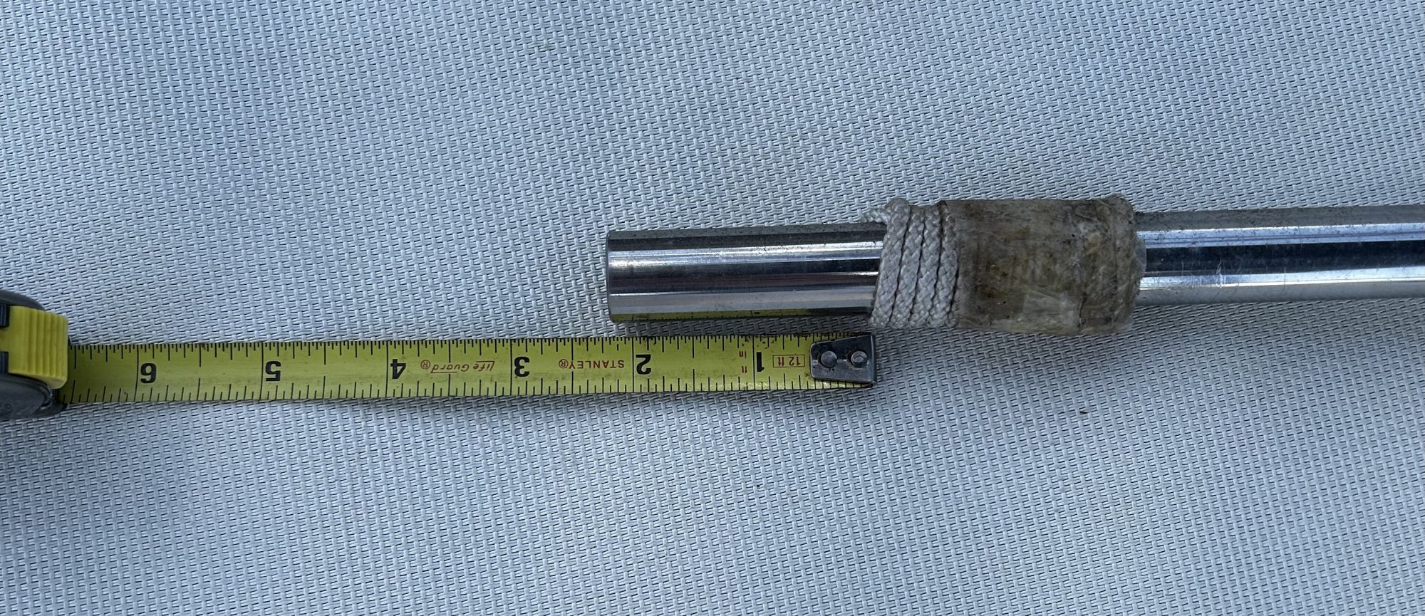

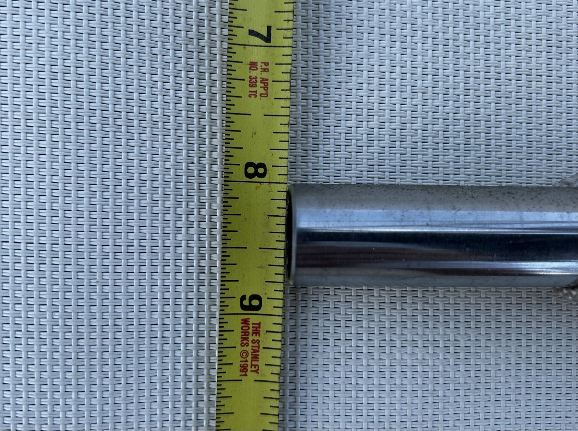

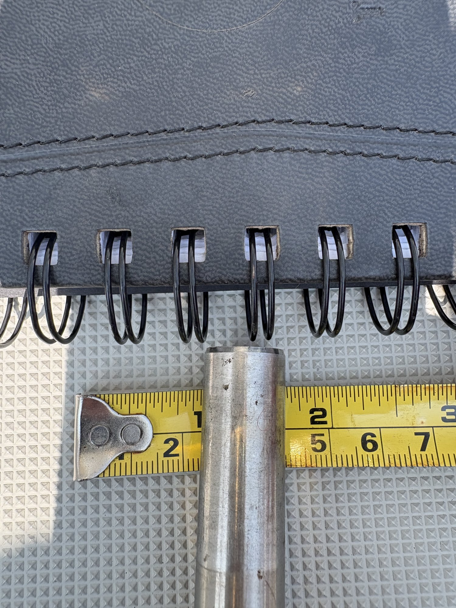

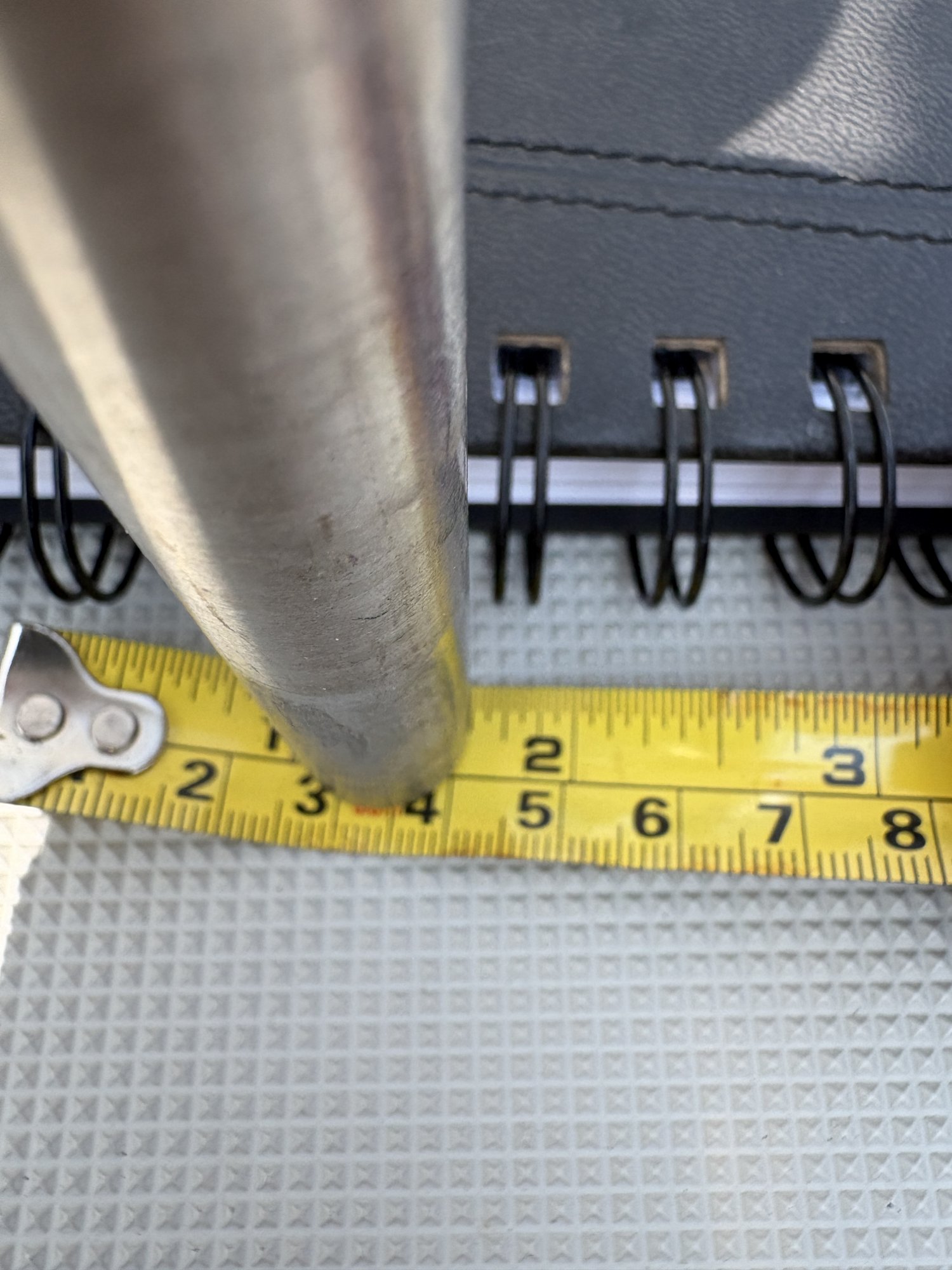

Here are some photos to help you out Dave…
Looks like about 1/2”, but slightly bigger. I don’t have my calipers on the boat.

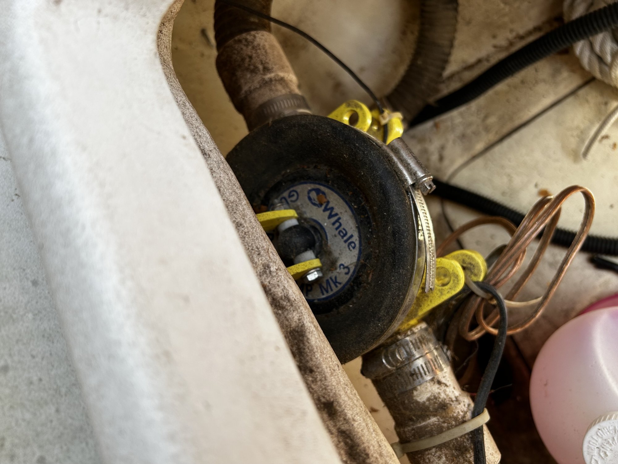

I am not sure what model I have, but took a photo of it too for reference.

Thanks Greg! I'll order a 1/2" stainless rod. McMaster has them for around $10 for a one foot section. The second handle you posted is what I had on my O'Day. The pump has a male fitting that fits inside a 3/4-1" aluminum tube that makes up the body of the handle

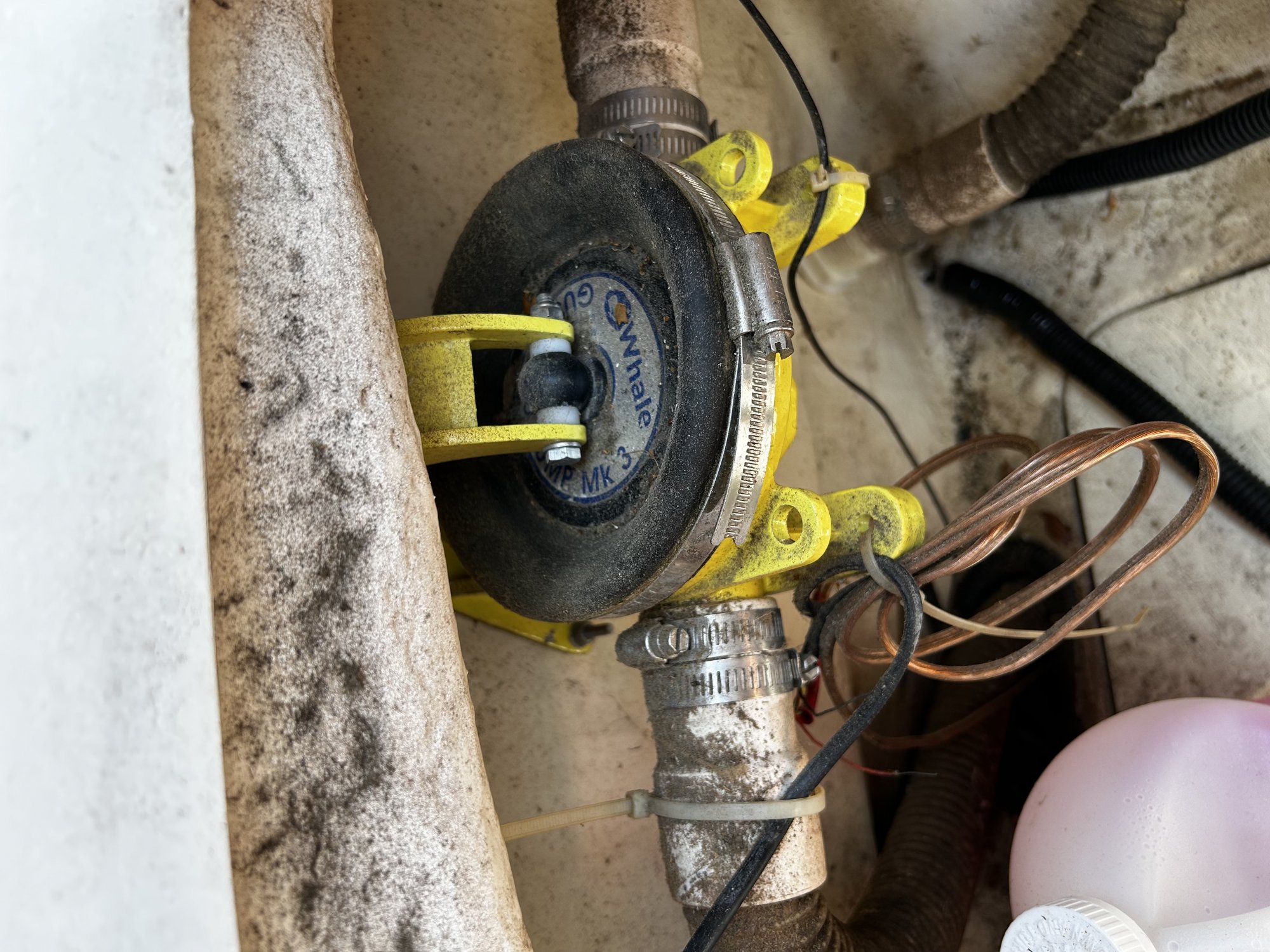

I was out on my boat today and remembered to get you some pictures of my Whale MK3 Gusher Pump. A different model than Gregs but may help you for a comparison.
