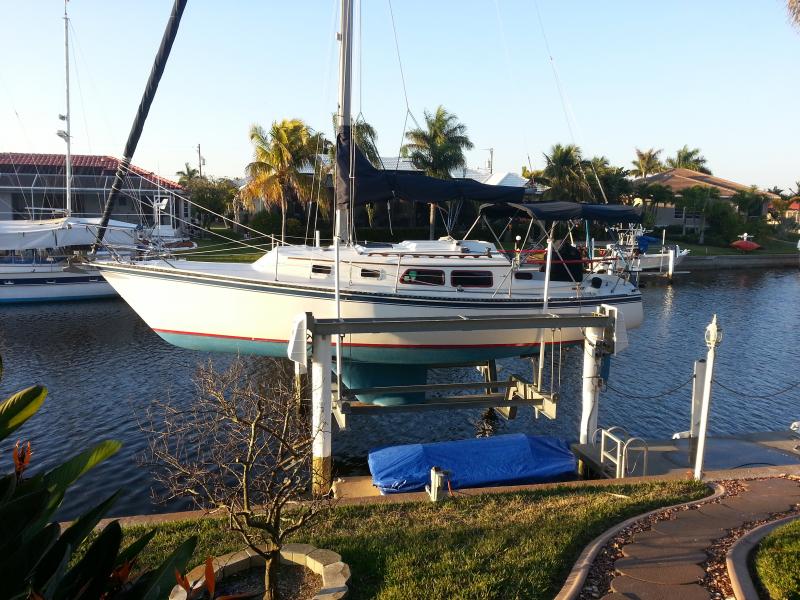

My boat is on a lift. So I guess the procedure is to clean it good and then put another coat of paint on since some comes off when cleaning.

so, where is your boat?.... on the hard or in the water?
if its on the hard, spray it and let it soak... keep it completely wet for at least an hour before scrubbing.... it will come of relatively easy.
now this may not be enviromentally sound practice now, but back in the late 70's when I worked in a boat yard it was a great way to clean the bottom of boats.
we used a garden sprayer with bleach in it.... wet the bottom of the boat. let it set for 15 minutes and then spray bleach on it.... dont let it dry. use a very fine mist of water from the hose nozzel to keep it wetted.... and between each wetting of the hose, wet it with the bleach....
after a couple applications and an hour has gone by, the stuff will wash off with a sponge... except for the barnicals.
a pressure washer also works good, and even better after spraying with bleach...
but short of ruining the entire atmosphere and the lives of all the people within a hundred mile radius, and anyone else who actually knows that you used bleach to clean the boat, a pressure washer will be the next easiest method...
