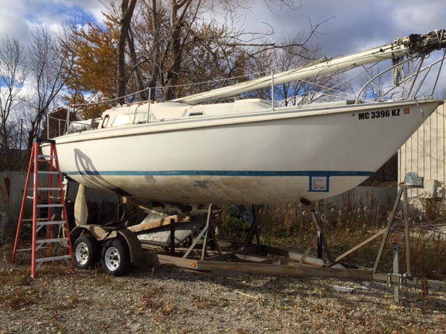

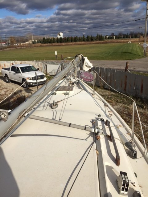

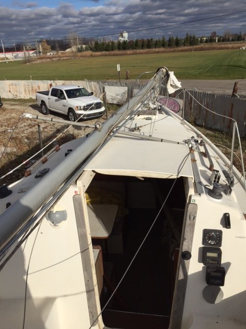

Well, I looked at the boat today....needs lots of love. My main concern is that the boat hasn't been in the water since 2011. The bottom has been soda blasted due to blistering. Fairly extensive but small, about 1/8" dia. Some fiberglas is exposed. I'll try to post pictures later. I pushed / pulled on the rudder and there's some movement, about 3/8" to 1/4". Gelcoat on hull looks very good, topsides has some spider cracking in the cockpit area. Couldn't look at the keel bolts, owner didn't want to pull up the carpeting on the cabin sole. He said he never replaced or inspected them. Interior looked good, relatively clean, dry and no signs of water intrusion around the chain plates, windows did not seem to be leaking. Owner claims he sealed them. Crib boards are shot, rotted plywood. Main sail and 155 furling jib are nice, still crinkly. Owner claims they've only got two seasons on them. Didn't look at the rest. They're a major brand but I can't think of the name. Tandem axle trailer looks solid, but a little rusty around the edges, Tires looked OK. Mast was straight. Rig looked in fairly good shape, no fraying at ends that I could see. Radio looked dated, I couldn't tell about the rest of the electronics. Owner is distressed, has to move it soon, loosing storage place. He was asking, $3500, I got him down to $2000. Too high?

I have to admit I don't know what the crib boards are - bulkheads? Those can be an involved repair but if access is OK not so bad. Maybe they can be sistered. Would be 1 -2 boat units if done professionally. It's hard to estimate. The spider cracking in the cockpit wouldn't bother me. It is listed as an iron keel but you didn't mention any rusting there. What was the head situation? The rudder post probably needs new bearings.

The crib boards are the boards that cover the cabin entry way. (That's all I've ever heard them referred to as.) Relatively easy / cheap to replace if you don't use exotic material. I'm pretty handy, have done it on my Cat 22. Iron keel has surface rust, owner had the entire hull soda blasted in preparation for bottom paint but never finished. There's some blistering that was opened up when soda blasted, none larger than 1/8".
I could move the rudder from below about 1/4" to 3/8". I've been lead to believe that is a common problem on these boats but bushings are available and easy to replace. It definitely needs TLC but I think there's potential. My concern is that is sat for 5 years. I know I'm taking a chance but if turns out to have major rot, I'll part it out and cut my losses.

I think you're good to go. $2,000 for boat, motor, trailer. You've don't this before so you are not going in blind. Yes, you're going to spend more than you'll get out of it (This isn't a business - right?). But you'll have a 26' sailboat with a good pedigree. A weekend pocket cruiser, a daysailer with benefits and even a club PHRF racer. And, it is a forgiving sailor which would be totally comfortable for family or entertaining friends who aren't sailors -although I don't know why you would do that.

I know it's going to be a lot of work. I just did the bottom job on my Catalina so believe me I'm not looking forward to doing it again. I'm hoping that all (?!!) I have to do to the bottom is fill, fair and sand, then epoxy barrier coat and paint. I've got a post on the "Ask All Sailors" page with more detail about the bottom. The replies so far have ranged from doom and gloom to "easy-peasy" so I'm hoping the truth lies somewhere in between. I'm retiring in January so I'll have plenty of time and I have the Cat 22 to get my sailing fix in the meantime.
