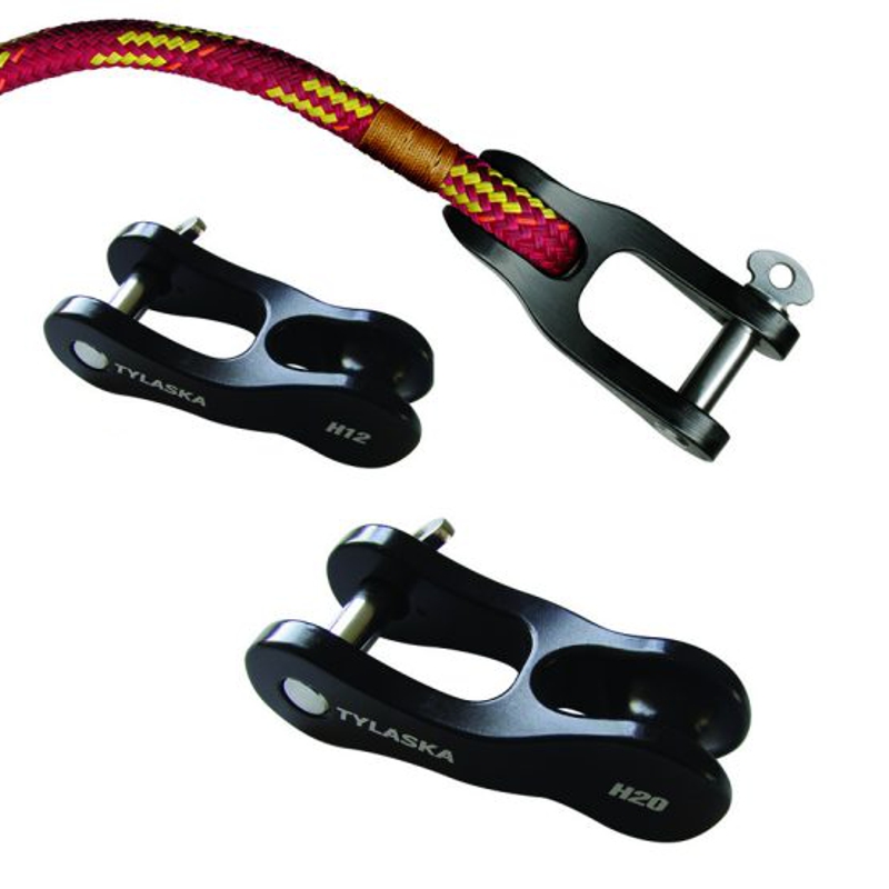

Hi,
I like Tylaska.
Barry

Tylaska are the cream, Wichard thimbles are nice too, nothing wrong with the more utilitarian Ronstan halyard shackles either, depends on the budget, but you can't really go wrong with any of those 3.

Admiral read that some snap shackles come apart at the wrong time.
She likes the tylaska
