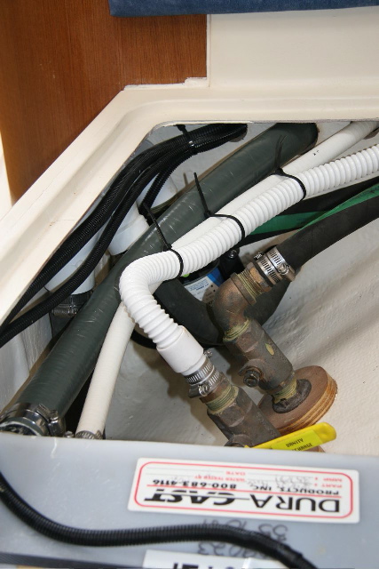

I Have This Hose And It Has Been Great.
On what, except that it has a lifetime warranty, are you basing your opinion that it's the best sanitation hose? Have you used it? Do you know anyone who has? Have you even read any reviews...ANYthing other than Shields claims for it?
Well, then let this be the first official review. I purchased the hose from WM.
I purchased 8 feet, needed 7 feet. I installed it myself, with two ss clamps on each end and it works great! It was hard to cut, but easy enough to bend around the small corner in the head.

Re: I Have This Hose And It Has Been Great.
I will get picts this weekend to post.

Re: Yours is indeed the first user review...
I only replaced the head to the holding tank. It was a white hose. The stench after leaving the window in the head open after a rain was terrible! I used the damp wet rag trick on the other hoses. I could not smell much foul oder from the others. They are black hoses. I am assuming they were replaced at some point. I have only had this hose in since April. Not everyone properly pumps out to the tank after using the head.. so if there is going to be an oder, I will know it sooner or later. If it doesn't work, I can always get my money back. But, it appears to have some promise. (Cross my fingers) Cuz, it is expensive.
*I was told about it from a guy that does repairs on boats for a living...
