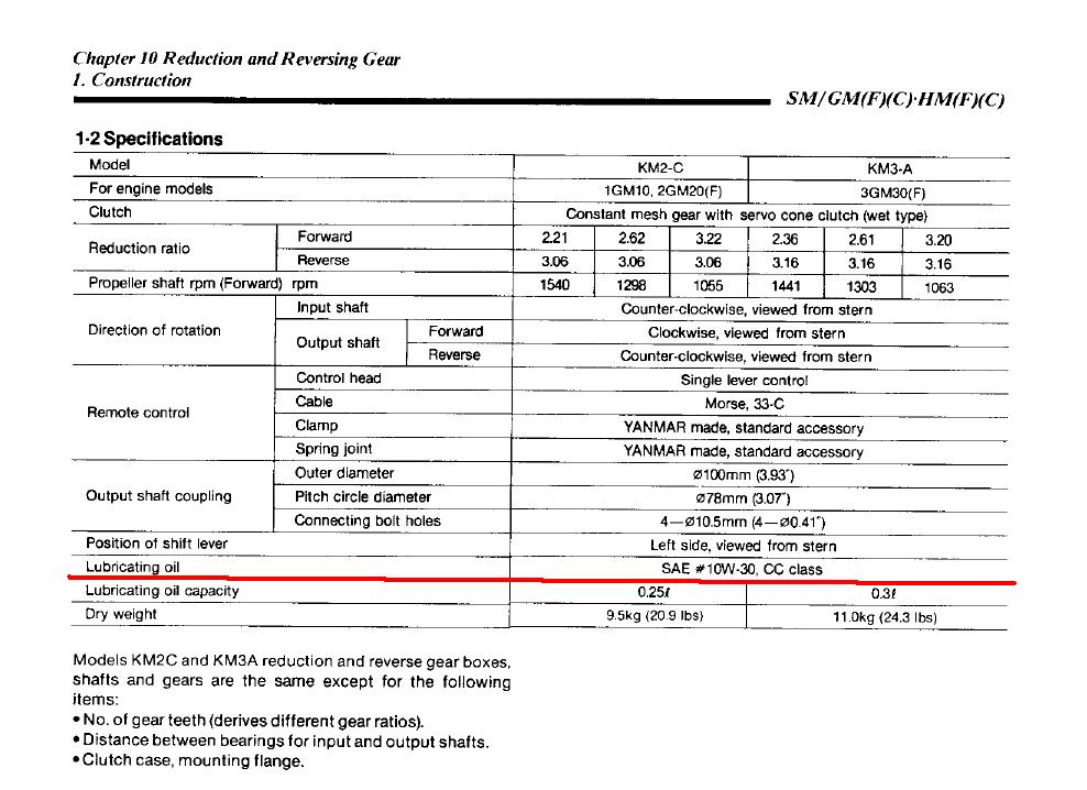

I did check the plate previously to discover the transmission calls for SAE 20/30 HD. It's a Kanzaki KM3-A. I'm just not sure if this means regular automotive oil or diesel oil. (Not sure what the HD stands for). The engine is a Yanmar 3GMF and I did wind up buying the Shell Rotella T1 straight 30 weight because it specified that it was designed for older engines.

Rotella or Delo or Delvac are all fine for the Yanmar; the list of API certs should have "CF" on it. The older ones do not want synthetic .. As Benny says, the 15/40 for the engine is perfect but don't go with the syn for the gearbox either, a straight grade oil is best .. like a 30 wt engine oil.. The multigrade oils (15-40) have "viscosity index modifiers" in them which makes them do what they do.. They are best for use in the engine.. The viscosity modifiers are sensitive to being sheared by the gear face contact, which gradually makes the oil go toward its lower viscosity rating.. so a 15/40 in a gearbox after a good bit of use will end up as a 15/20 or a 15/15.. and not so good for the gears. A straight 30 in the box will stay pretty much close to the original 30 with use. Any effect in real world terms? Probably not but that change in vis can be measured in the lab and I am not so keen on doing Kanzaki research ! Recap: multigrade is fine in engine, straight grade in the transmissions that call for motor oil in 'em.

When they say 20/30 it means that you can use either one single grade. In colder climates the 20W will flow easier. For engines with high hours a thicker oil is beneficial as it helps compression but in the transmission it really does not matter, I would go with a grade suitable with the temperatures the boat is going to be used in. 30W should be fine for temperatures above freezing. Diesel oil is fuel so use motor oil for the transmission.

Regular single viscosity engine oil. They typically get the HD rating because they reliably stay at the single viscosity. This is interesting because a bunch of us have Kanzaki transmissions that specify automatic transmission oil. In any case I extract and replace every year to make sure the additives stay fresh.

The fundamental difference in the transmissions is that the ones that use a friction disk pack clutch specify ATF.. the ones that use a cone clutch specify motor oil..

The 4JH2-TE Yanmar Owners manual that came with the boat stated to use engine oil in the Kanzaki transmission. That is what the PO used. Later I purchased a 4JH2-TE Yanmar Service Manual and it said to use ATF. Then I discovered the plate on the bell housing and it said to use ATF. So ATF it is.

Gunni, the KBW 20 is a multi-disk clutch type transmission hence the ATF.. The higher HP engines as in your boat dictate a smoother clutch than the cone clutches usually can be. Key is to use what the manual for your gearbox says to use.. The old Kanzaki units were in use long before a suitable, readily available "real" gear oil, like what Jim is talking, was available hence the recommendation from Yanmar for a straight grade motor oil for those old units. Remember too that gear oil numbers are different from crankcase oil numbers.. a 30 wt crankcase oil is about equivalent (in viscosity, not additives) to an 80 wt gear oil..
