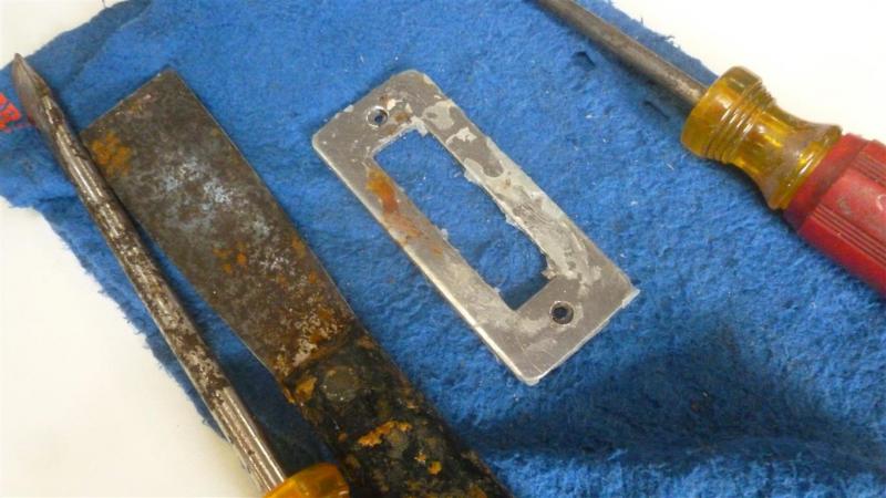

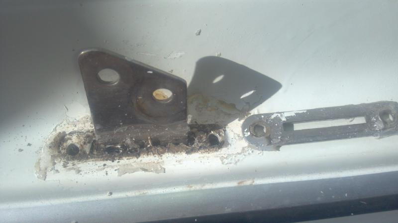

It took me 45 minutes to clean this little chainplate cover.
ARRRGGGGGH :eek::eek::eek:

a little bit of heat will let the 5200 loosen its grip, and for something small like the chain plate bezel, let it soak in gasoline (or ether is best) for about 20-30 minutes and the silicone will soften and come free.
and you would be surprised and impressed how fast a small fine stainless grill or welding brush will remove the silicone and 5200. its no work at all...:D

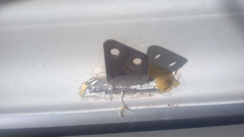

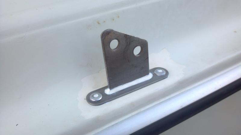

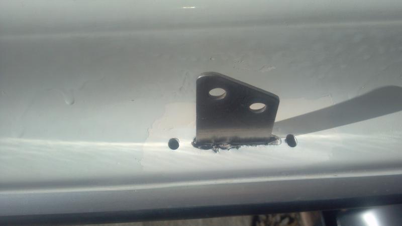

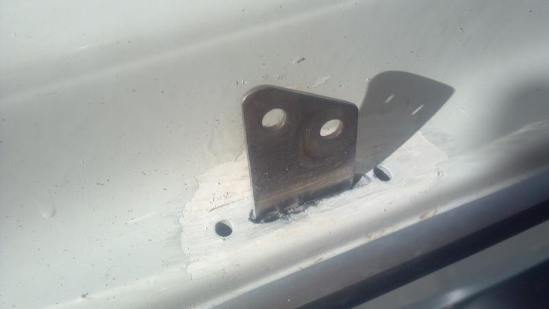

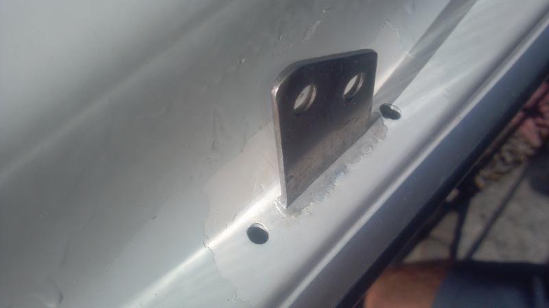

the photos are of when i repaired the chainplate leaks on the 25... once i scraped away the bulk of it, i used the wire brush to clean it the rest of the way... it does an excellent job of it.
and i suspect the reason the previous owner couldnt get it to seal very long (at least 4 layers of various products), is that the hole in the deck that the chainplate protrudes thru was too big... it allowed the chainplate to flex too much in the hole and breaking the seal.... i filled the gaps on both sides with epoxy putty to stop the movement, then used 4000UV to seal it.
no more movement and no more leak...

If you wire brush anything that will go back on the boat, it is best to use stainless steel wire brushes, or, you have to be absolutely careful to get 100% of any bits of the wire brush residue off of the item before reinstalling it. I am talking about itsy bitsy pieces that you don't really see at first, or even third, glance. The non-stainless bits will rust and may leak and stain the deck (or wherever). I carry stainless brushes on the boat for that purpose and I use the brass ones if I don't need that much effort.
Regarding solvents, the chemistry of the goo when it is uncured is not the same as when it is cured. I have never seen acetone soften cured 5200 up enough to make much difference. It is amazing once it is cured. It is just elastic enough to resist scraping and even bead or sand blasting. Blasting can sometimes work though but you have to take care to not dull the bright side if that is important. Also, you don't really have to get 99.9% of the old goo off (except for silicone). You do need to get enough off that you have a good seal all around the perimeter of the item. So it has to be removed to the point that any remainder if not "proud" to the sealing surface.
Silicone is a menace on boats but once you use it for a particular part you have to actually remove the surface material of both the part and the deck by sanding or other abrasion. There are some products that advertise as removing silicone - they don't remove that last bit that is at the surface of the materials - and that is where the new stuff won't stick. It looks clean but it isn't. I am not even 100% sure that new silicone will stick that well to old cured silicone.
I believe that 5200 is a polyurethane adhesive only, i.e. it does not contain silicone. Heat will soften it but it will not remove it. A heat gun is useful to be able to stretch or shear the seal to remove the part so long as it doesn't damage anything around it. It won't release it from the material unless it never cured properly in the first place. Also, 3M says don't use alcohol to clean the surfaces you are bonding with 5200, and that bare metal should be primed with a suitable primer (see 3M site). I haven't ever done that and don't know anyone who has but that's what they instruct.
