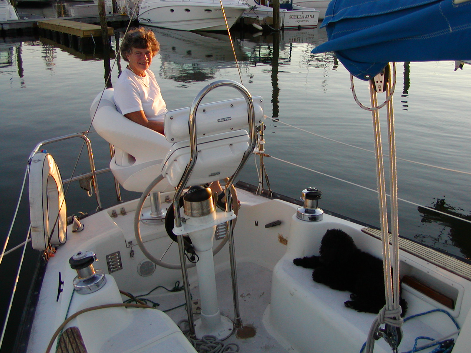

idk about cup holders, but I definitely need better seating at the helm. Essentially stood for a week plus coming up from Ft. Lauderdale.

I hear you with the seating! A PO bought a nice set of BottomSider (now out of business) cockpit cushions, but the one for the arched helm seat won't stay put.
