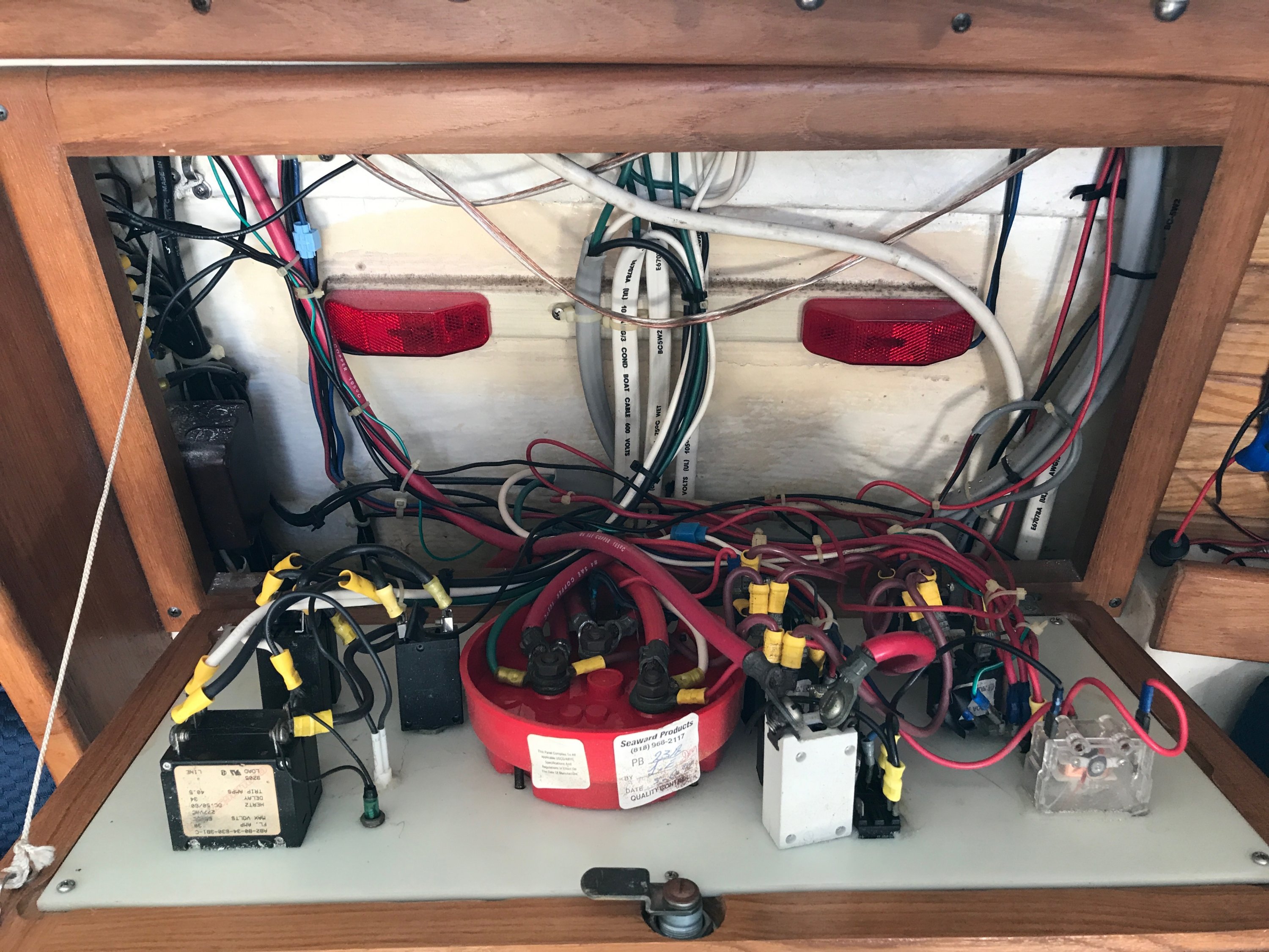

Here is one area I want to neaten up. Hard to see to the left is a very overloaded DC negative bus bar. Over time I want to add another DC neg terminal strip, put in a terminal strip for the positive runs between the loads and switches and add an always up ATC Fuse block, Blue Sea #5025.
The other panel will be in the battery compartment holding 4 ANL Fuse Blocks connected together with copper bar to create a positive bus bar, ACR and a negative bus bar.

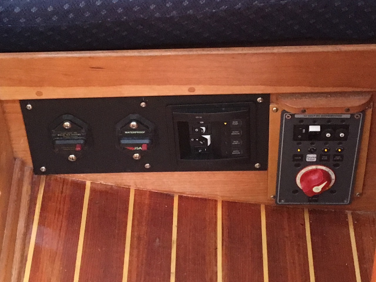

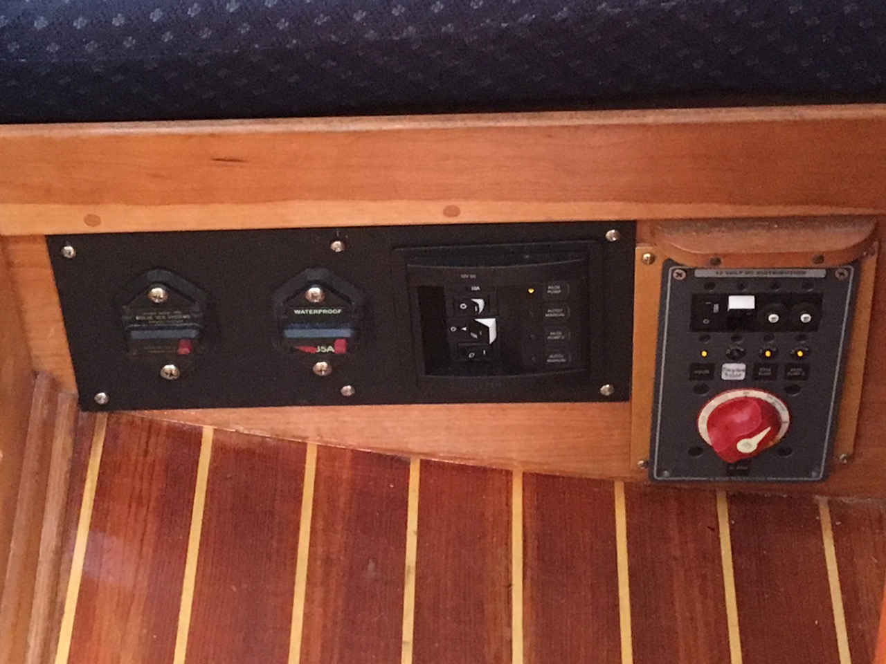

Take a look at the Blue Sea 360 Panel Wizard. It makes for a very neat installation, albeit more expensive than a DIY solution. I've used a couple of them in different places.
Here's one installation. The black panel is 3/16" black starboard.

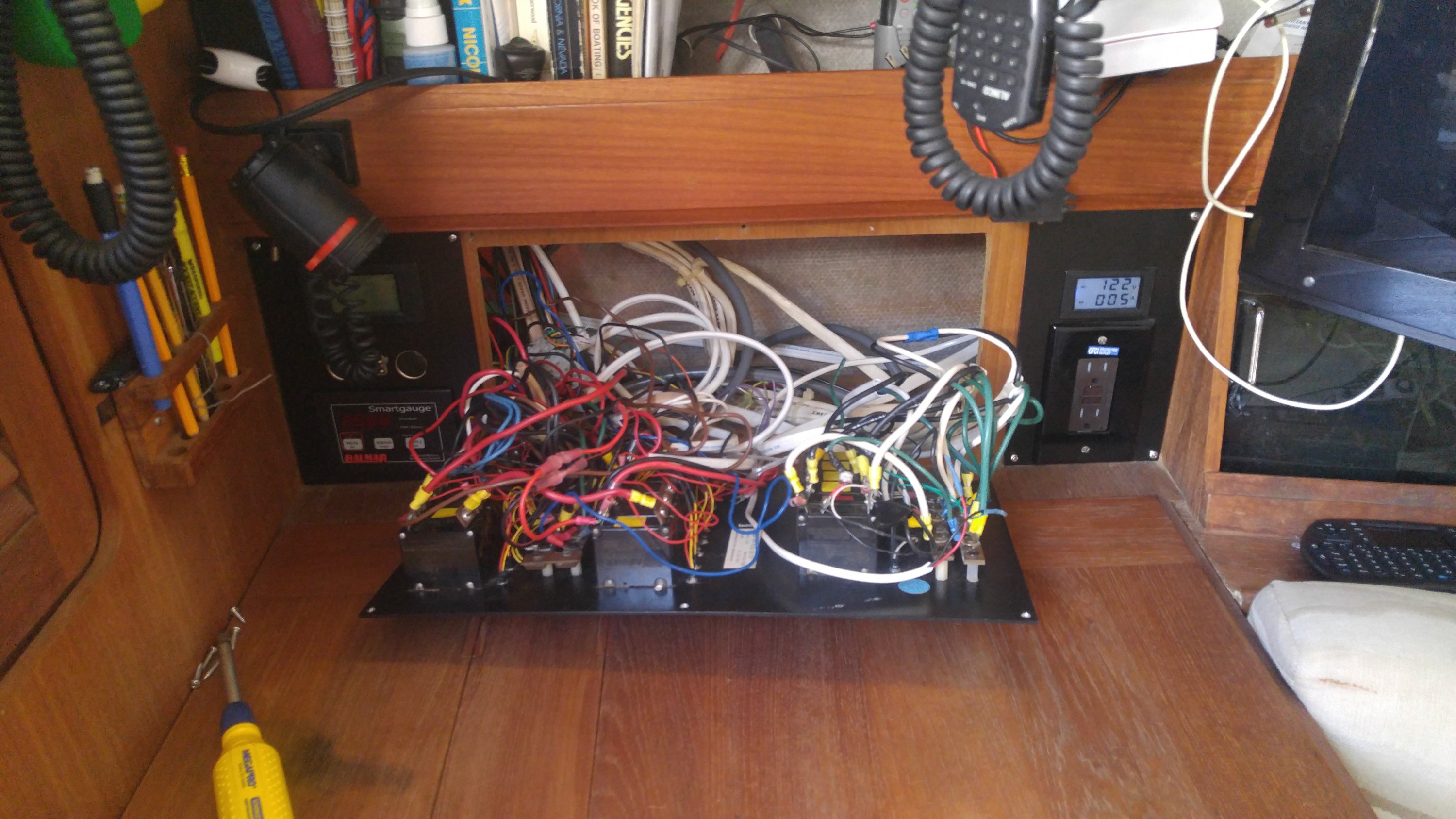

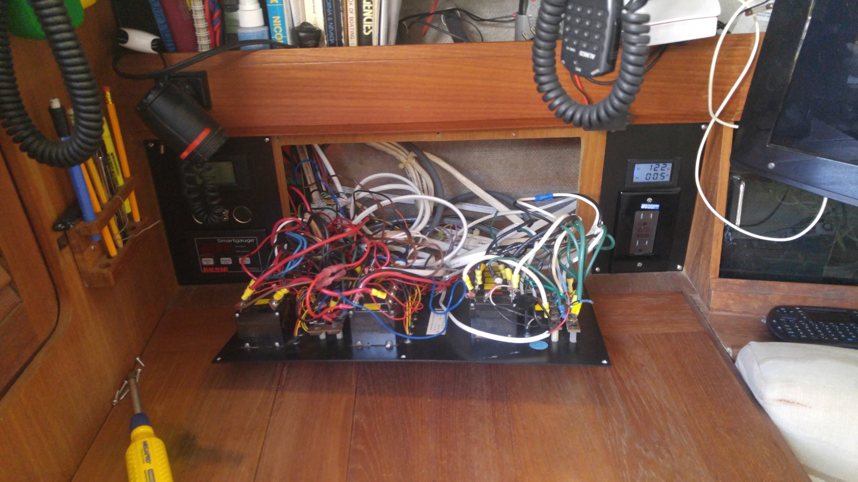

Just to avoid confusion I think Ward is asking about what is referred to as a Back Plane..
This would be an example of a back plane shown during the wiring process...

Ward - hope your plan includes getting rid of those trailer tail lights that illuminate the panel. I replaced them on the Catalina 28 with a short strip of red LEDs. That saved a lot of battery power and improved the look of the panel. For the backplane I used 1/2 plywood painted white screwed to strips of ply epoxied to the hull.
Beautiful layout. I have been wanting to clean up my mostly stock electrical panel for years (aka the "rat's nest"). I've slowly been accumulating the parts, but the layout has held me up. My first step would be to move all the ground wires to a bus bar on a back plane. That could at least move 1/2 of my 12V wires away from the backside of the panel. The mixing of 120V and 12V has always been a concern.

Ward, granted that you can always make the lines lay down in a neater pattern. But as old boats go, your structure is not on the Oh My God rating scale. It is a lot better than most.
