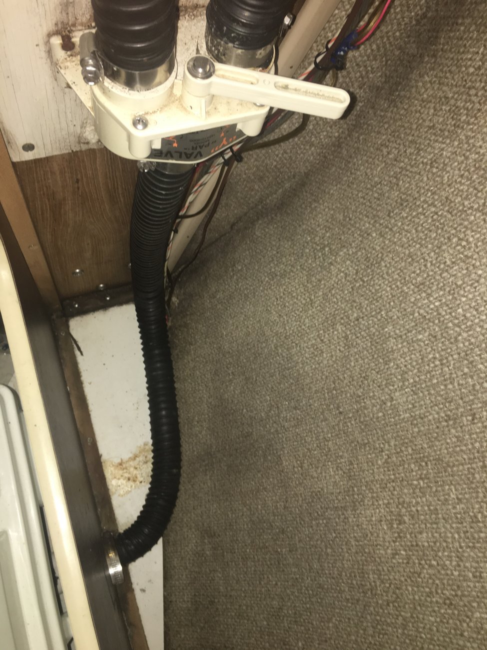

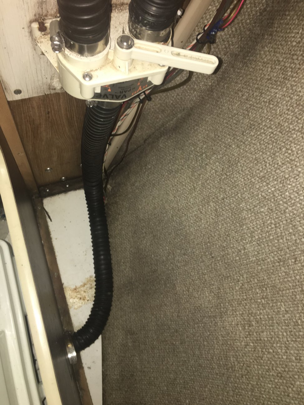

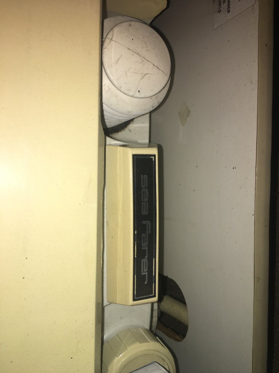

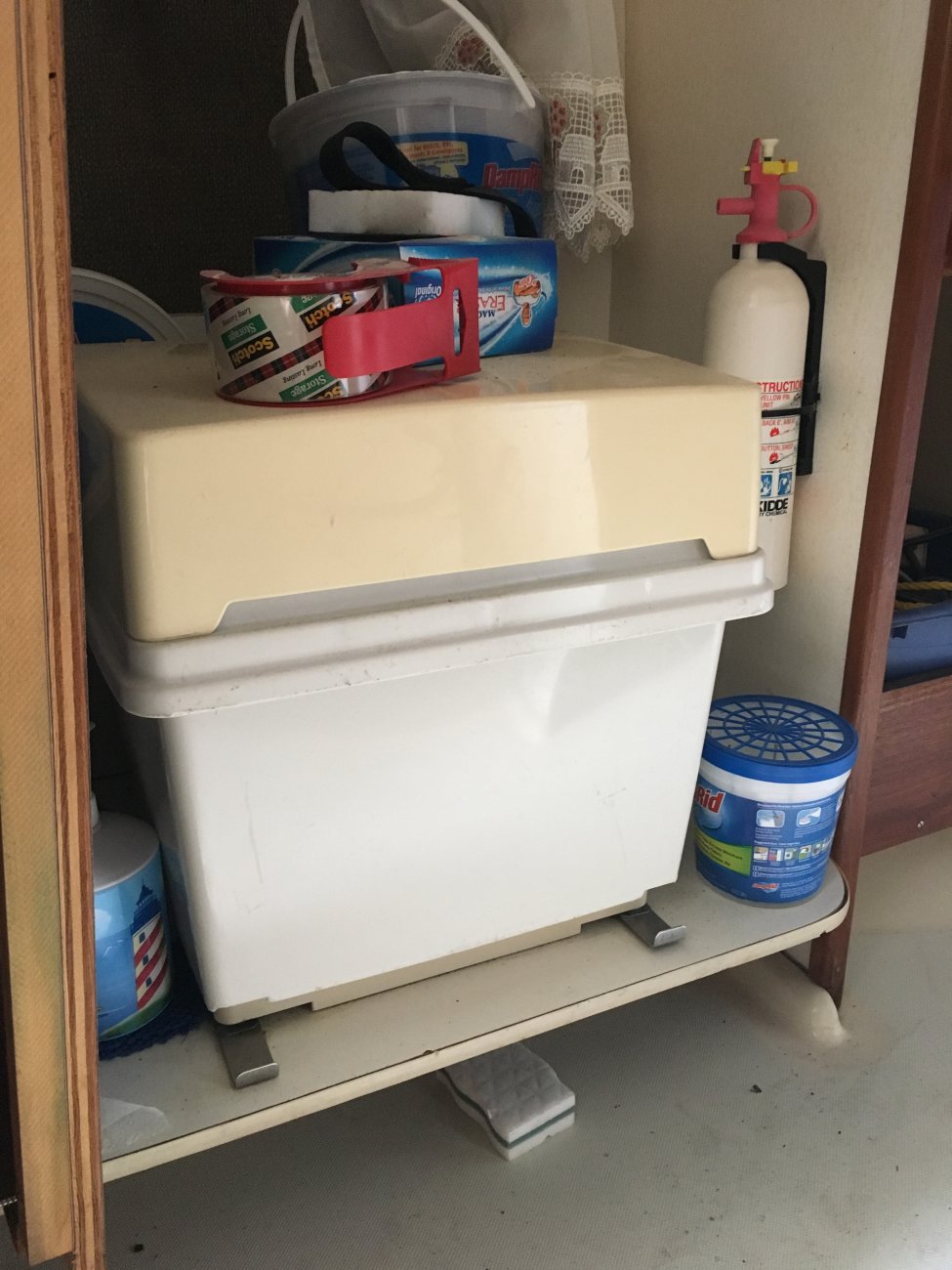

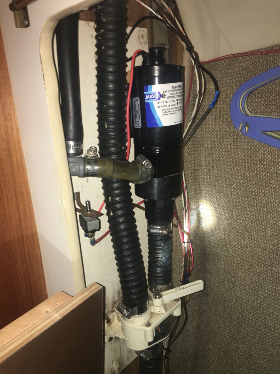

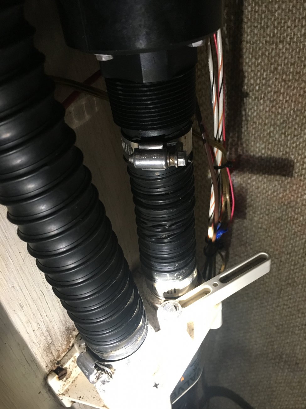

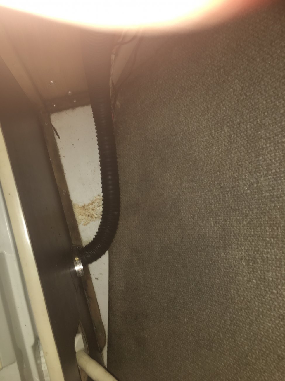

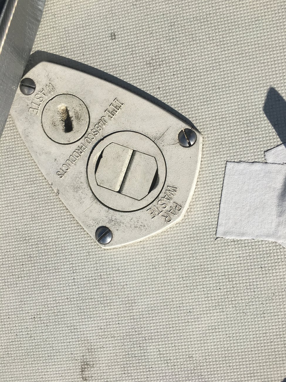

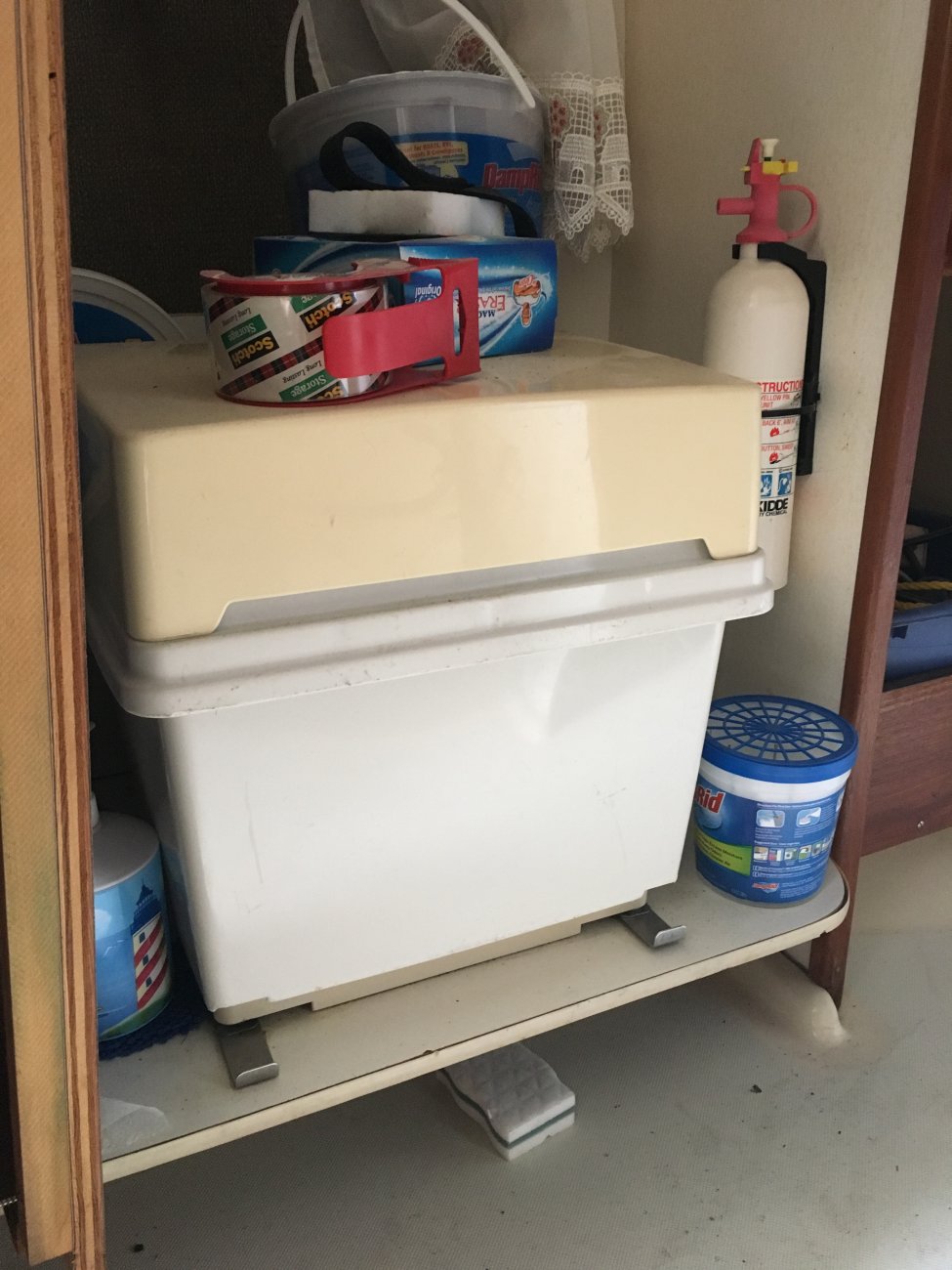

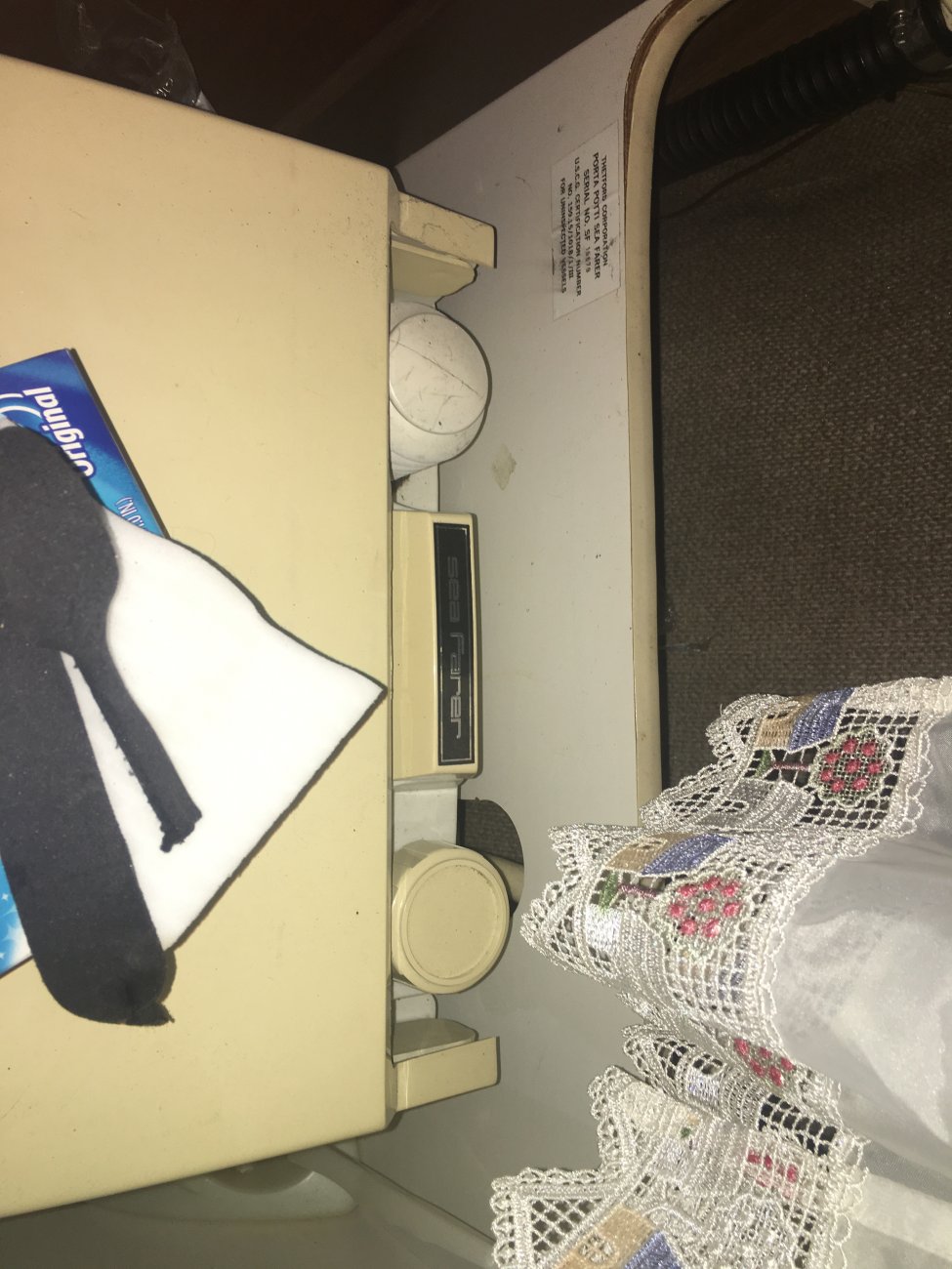

I finally got some pics this weekend. I'm left with more questions than answers. I'm wondering why the macerator is leading to a deck fitting?

You may be correct. There's two ports on the deck plate. One is for pump out and I suspect the other one was originally intended to be for ventilation?? It was made by a reputable manufacturer so I'm wondering what they're supposed to be used for
24,589
Perhaps the design is so that you can empty the thick sludge into a bucket and save the carrying it on and off the boat where "spillage" would be "Nasty". It is a porta-potty setup with an external pump out. You can suck it all out or you can pump it out. Looks like you have some of the best of both worlds.
Just be careful when you turn on the pump.. If pressure builds up you might have a big problem.
OMG...I know why! I first saw one of those deck fittings (I've only seen two till now) in 2011 and had to ask some of my gurus what the heck it is. One of 'em had been an engineer with Jabsco in the late '70s when somebody there came up with the idea of creating a single deck fitting that could either be a pumpout fitting (larger opening) or an overboard discharge fitting for a macerator pump (smaller one.). Once I found out what it was I nicknamed it Jabsco Poop Shooter. Jabsco quickly abandoned it because trying to shoot a tankful of waste out a deck fitting was a disaster! Forgetting to make sure it was on the lee side of the boat when using it had predictable consequences...even making sure to put it on the lee side wasn't much help if the wind--even a slight breeze--shifted even a little bit. There were a number of blow up disasters trying to pump through the deck discharge plate and apparently putting it in the side of a boat (I saw a second one in the side of a Grand Banks trawler...owner wasn't using it and didn't have a clue what it was) didn't work any better because of "blow back" so it never went into full production. Yours is only third one I've ever seen and the only one I've seen that still had a macerator pump connected to it apparently still in use judging by the new looking condition of the macerator.
I'd remove it, fabricate a cover for the hole, and install current deck discharge fitting and if you want to discharge overboard, install a below-waterline thru-hull with seacock.
What's the "system" in photo #7?
Btw...I do hope you're planning to replace ALL the hoses...corrugated hose has no place in a sanitation system. I'll be glad to help you spec out a system the right way.
And I'd love it if you could email two photos to me--#2 and #3. If you don't already have my email address, PM me and I'll give it to you.
