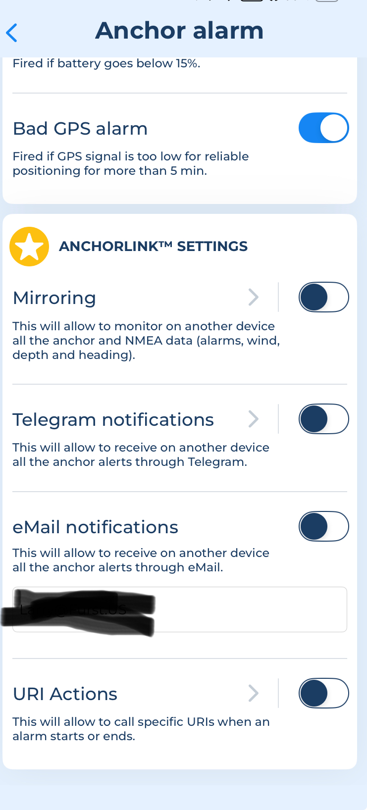

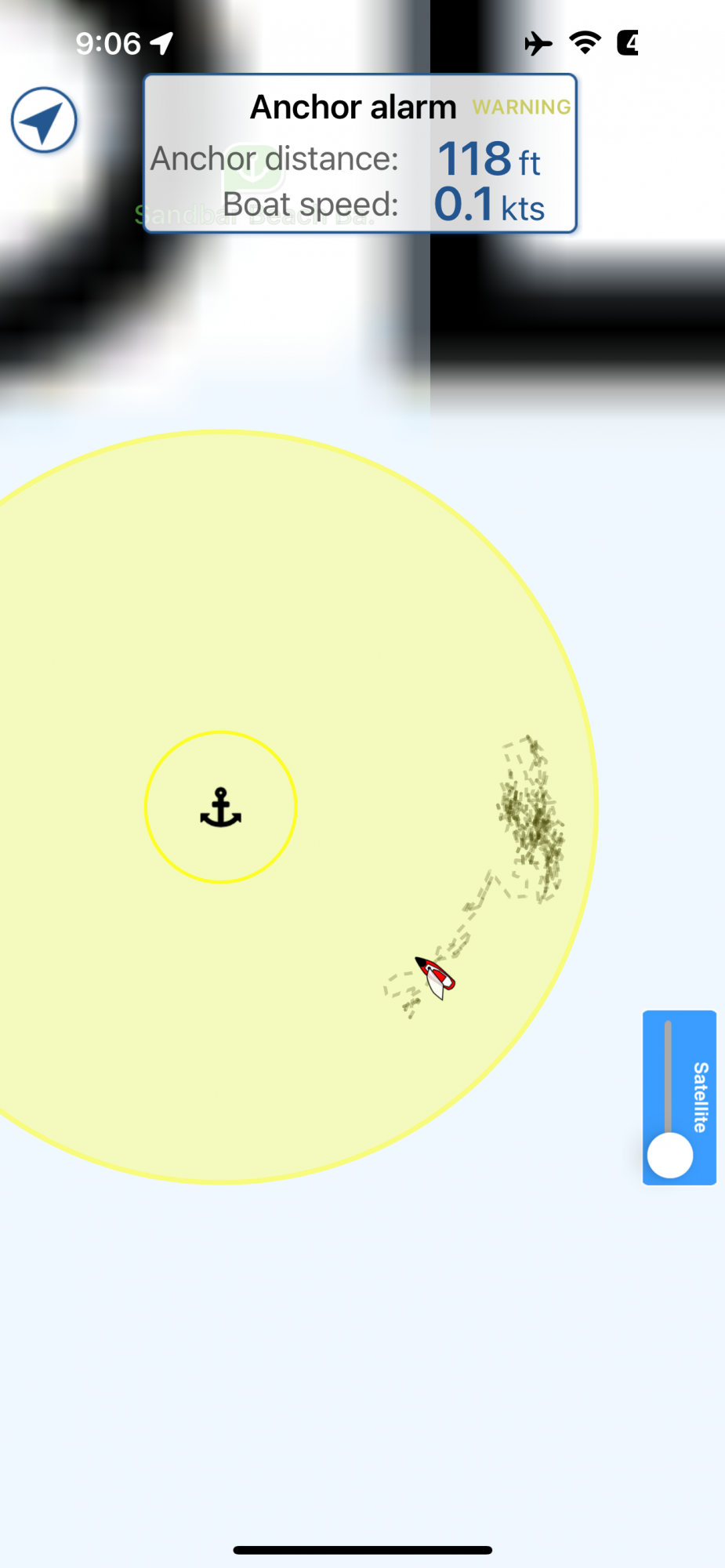

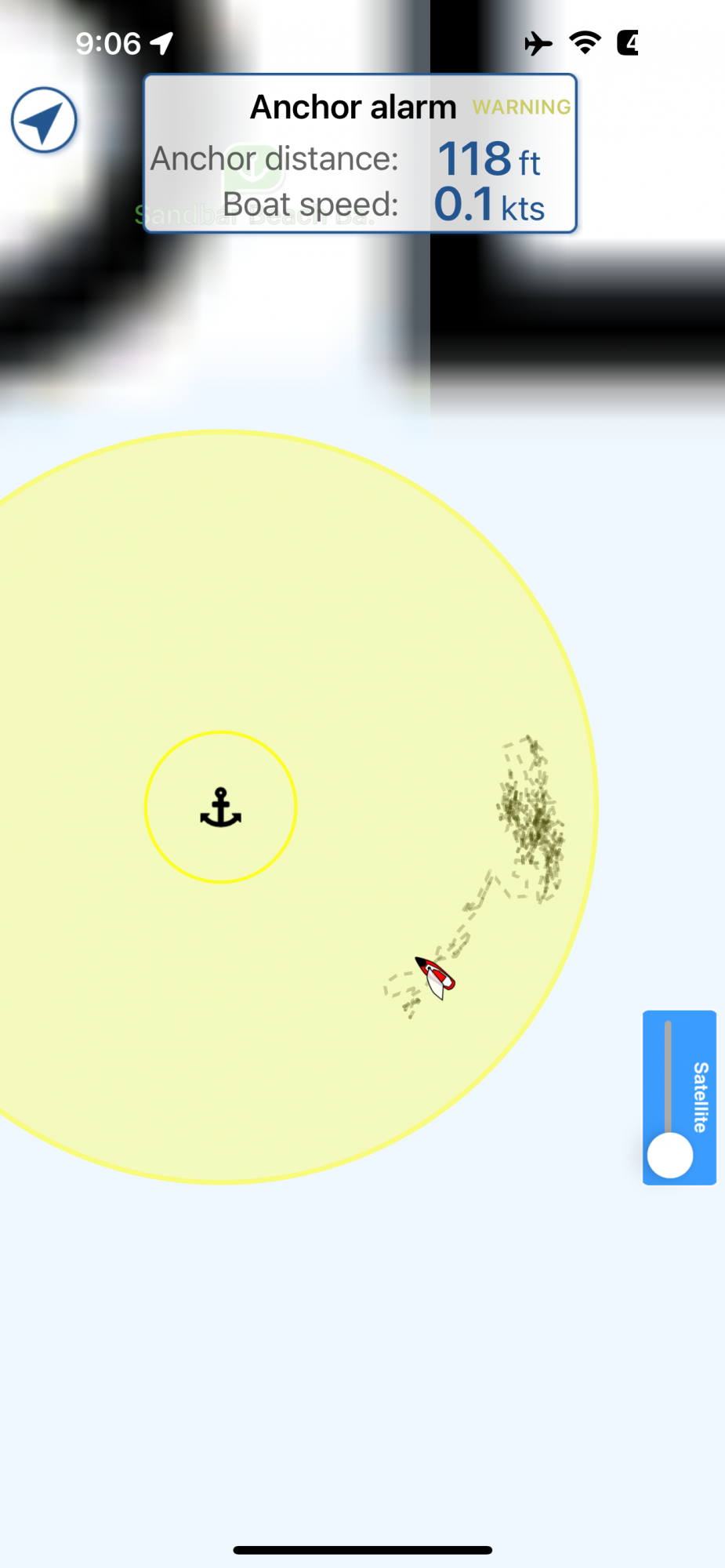

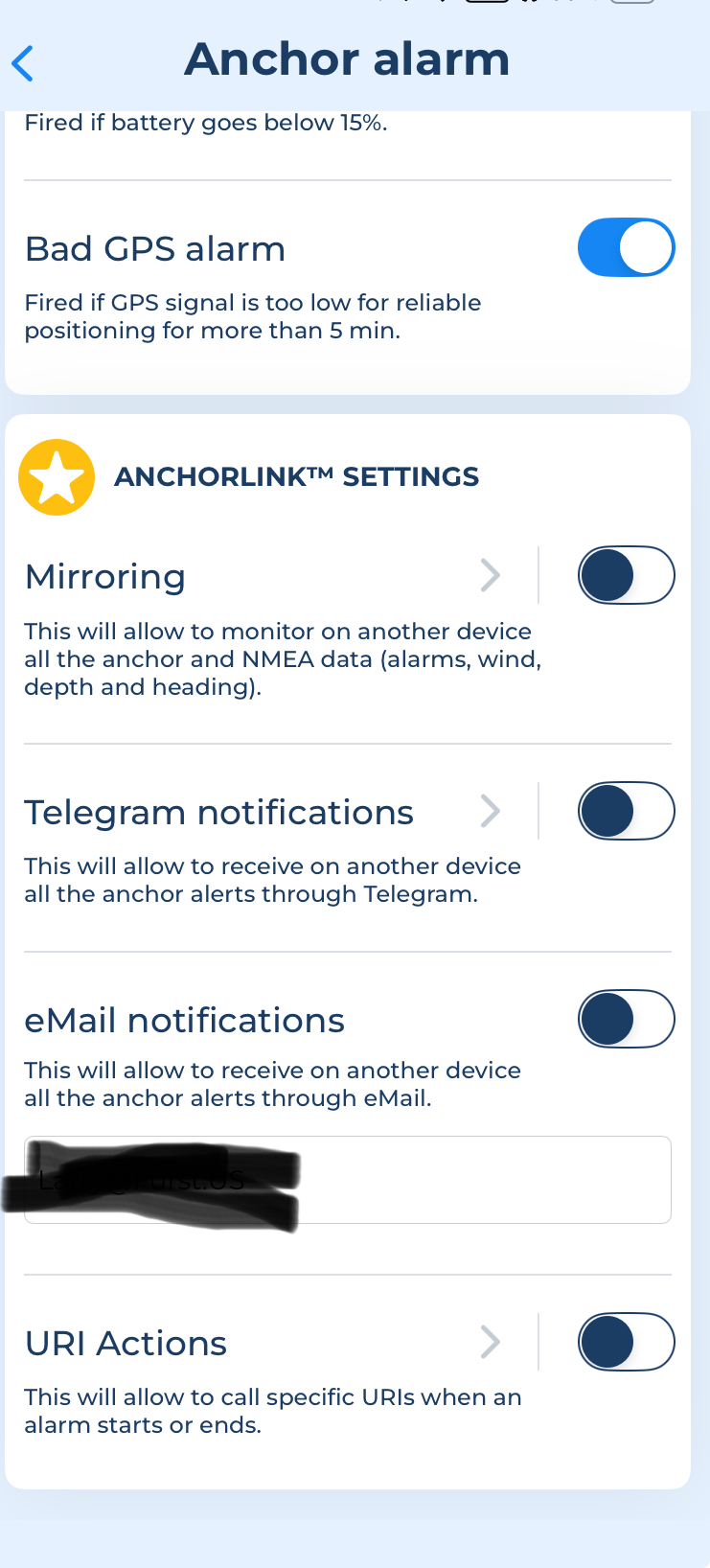

I love the Aqua Map anchor alarm function. I use it locally on my phone and when I leave the boat use it on the iPad with remote display to my iPhone using the app’s “Anchorlink” feature. The app has a setting that allows you to prevent the iPad from sleeping while the app is open.
How I use it:
My iPad runs the app and connects to the onboard wifi, and is kept plugged-in to power when running the Aqua Map app with anchor alarm. It’s also connected via Bluetooth to a dedicated external Garmin Glo 2 GPS (because iPad internal GPS is not reliable and occasionally “sleeps”). I have a small inexpensive 4G router in the boat with SIM card (my Starlink service is paused, but I use that when cruising). Amazon.com
I receive any anchor alarms remotely if the app is running in background, and can check the status of the boat at will by opening the app on my phone.
I can also check the boat and surroundings visually using my onboard Reolink and Ring cameras that are inside and outside the boat, and would receive motion alerts if anyone were to board the boat (and talk with them via the camera).

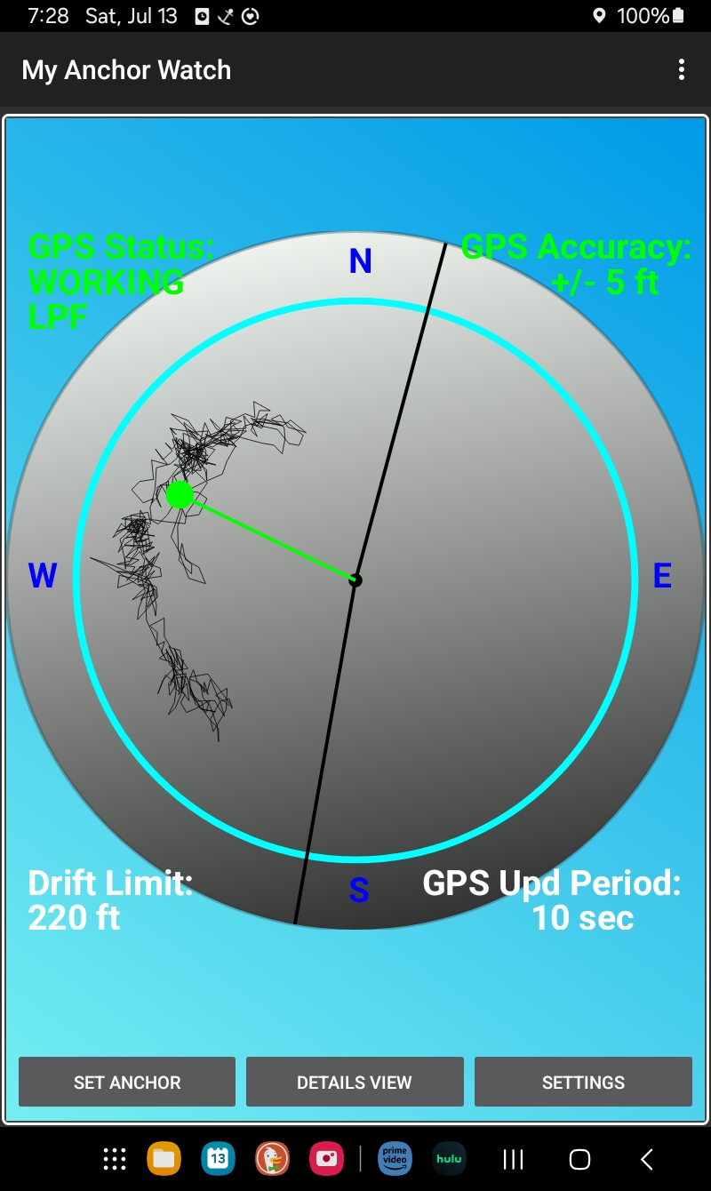

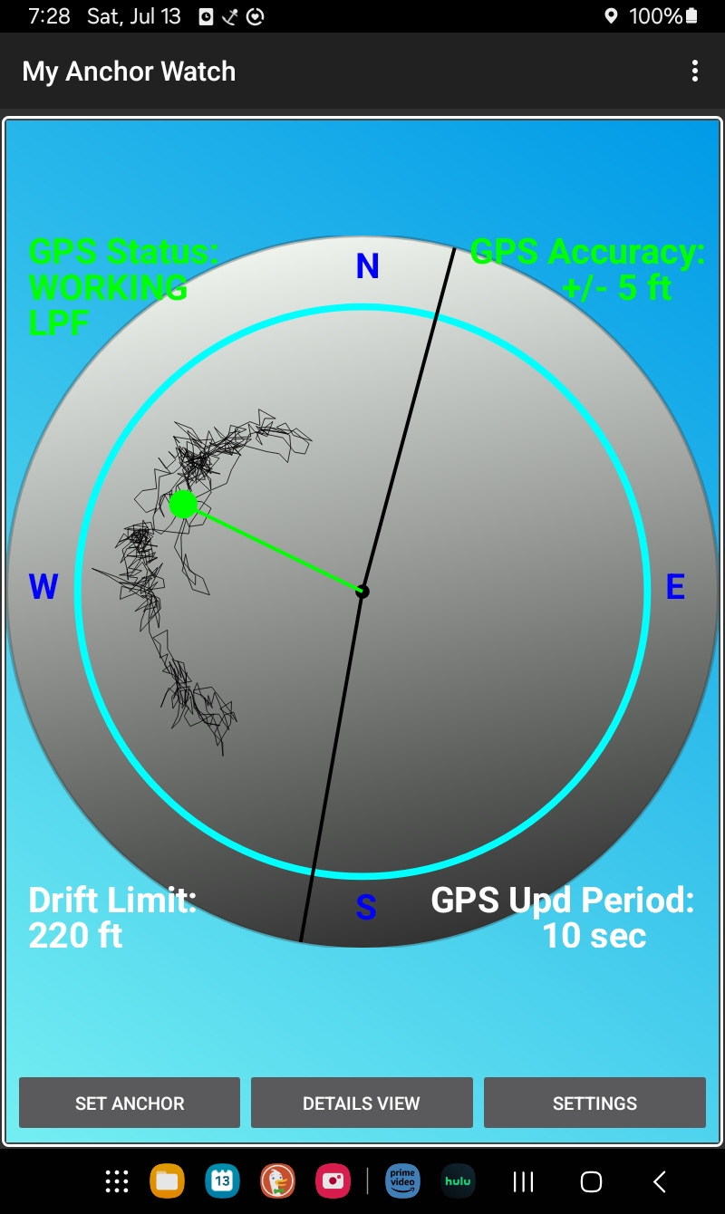

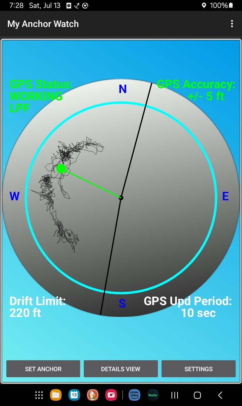

My favorite isn't available anymore, the developer seems to have disappeared. It was called "My Anchor Watch" by SjaellSoft. The features I liked were
Ability to set anchor position after you are anchored just by entering bearing and range to anchor. If you guess wrong, it was easy to adjust.
Easy ability to adjust warning and alarm zones and swing angles.
Easy ability to compensate for GPS accuracy, update frequency, loss of GPS alarm, etc.
Great drift log that showed my track all night.
Very reliable, I never had it fail once.
Still looking for another one.

Aqua Maps has all of those features, and more.

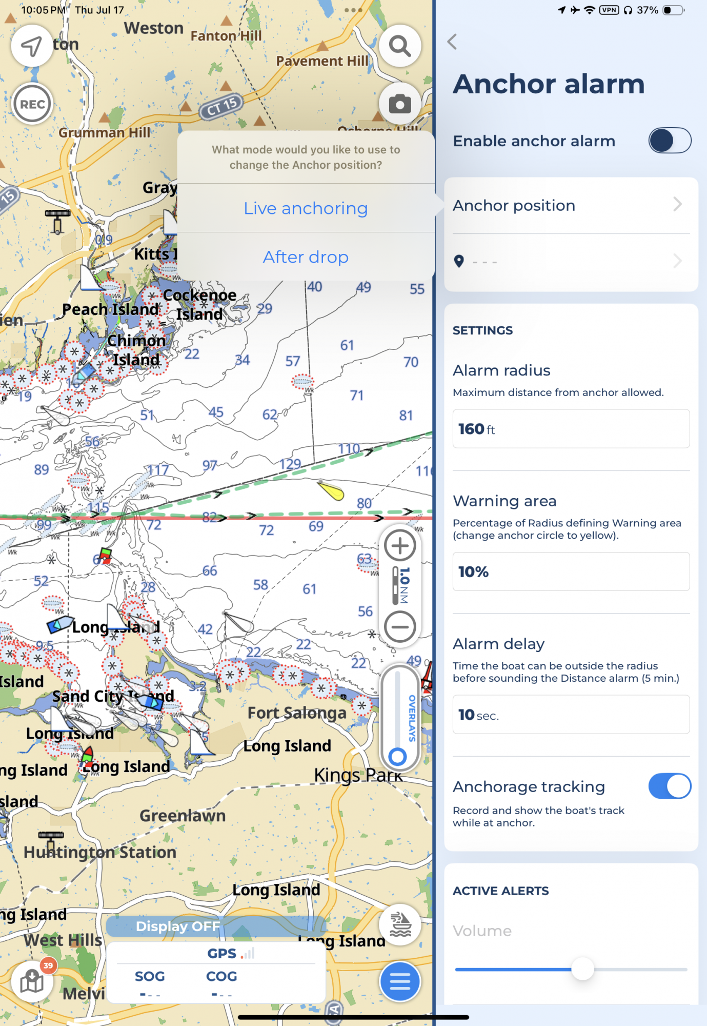

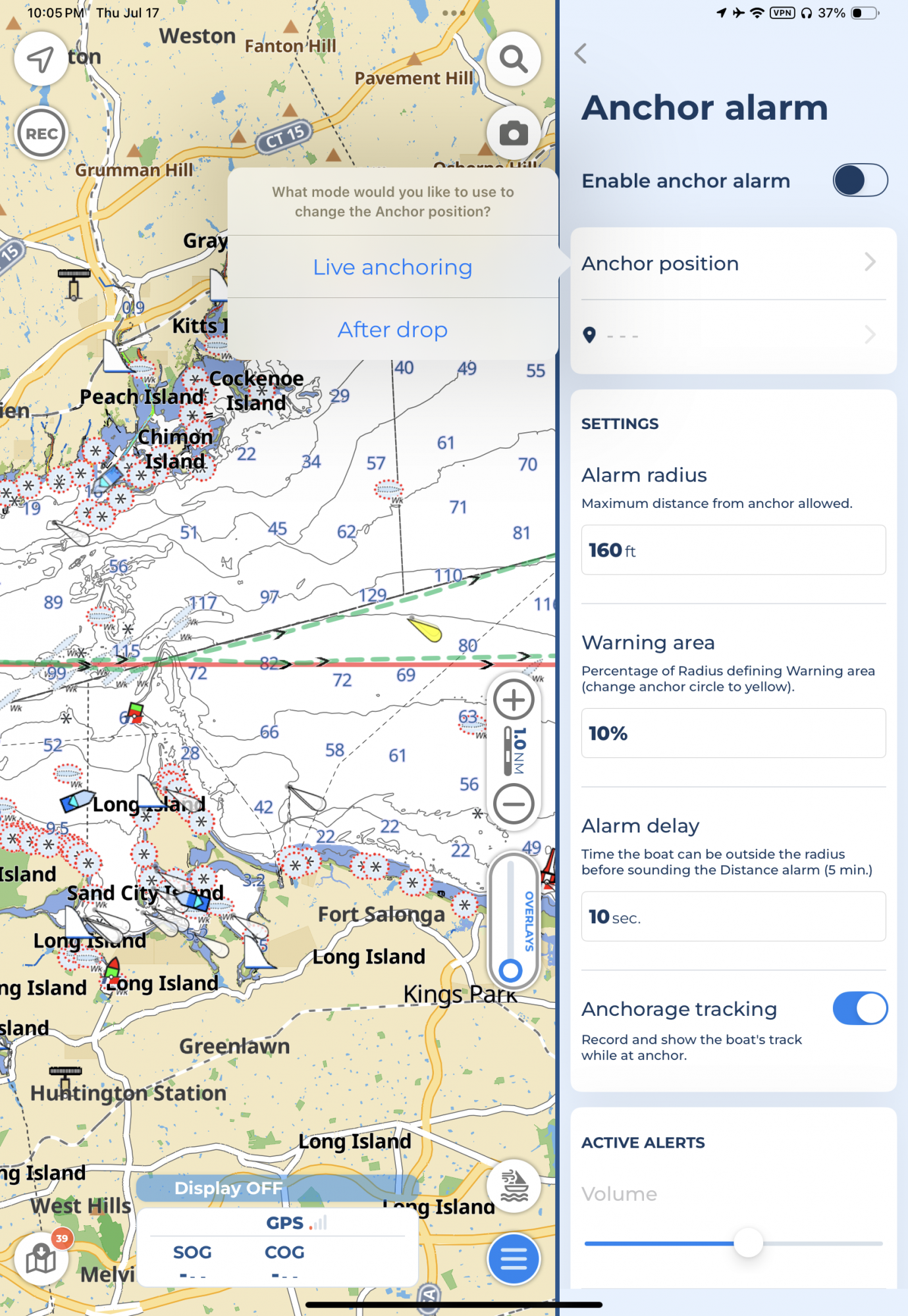

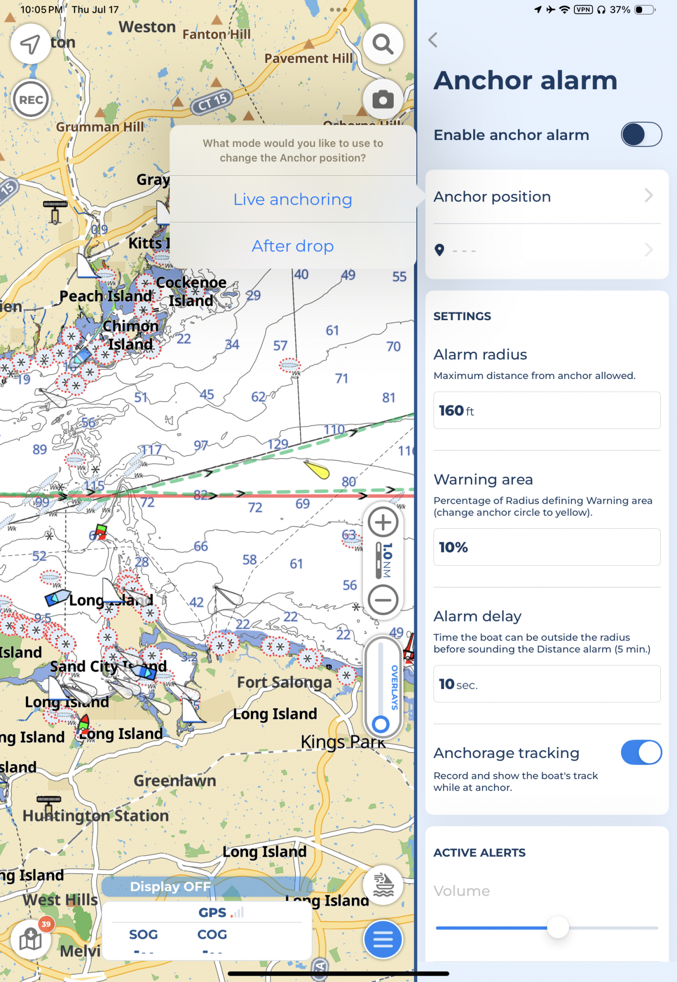

Where is the swing angle? I couldn't find where to set that.
Start using the anchor alarm function, then to set anchor position choose either live anchoring or after drop. You can then set (and edit) position, bearing, and distance. (No GPS position in the attached screen grab). No swing angle limit - you are setting a radius from the anchor position. If you‘re concerned about wind shifts you can set the anchor distance to be closer than it is, and swinging out of that circle will set off your alarm.

Ah , well. Maybe they will add that feature soon. I almost always use it. None the less, I'll give it a try.
