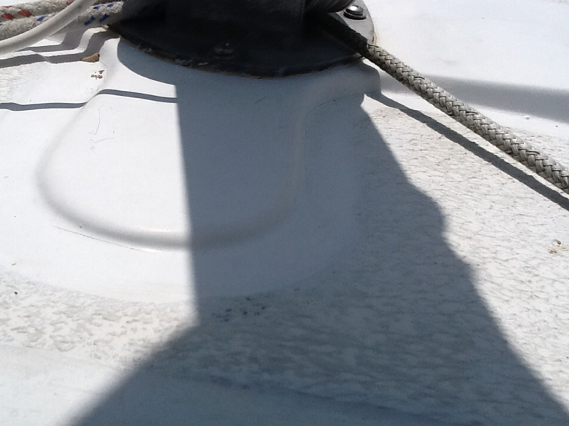

1981 Hunter 27 Cherubini Does anyone know what this tongue of raised fiberglass aft of the mast step is for? I would like to install a large pad eye there to attach Cunningham and boom vang blocks. Is there likely an aluminum plate embedded there? Thanks.
23,519
Tap gently with a rubber mallet. Only YOU will be able to hear the results. :) We can't from here...:) No clue why, but it's there, so it's a reality, right? :)

its unlikely that its got any metal there, i had an 81 h27t, if someone has re-done the mast step area in the past, or if it sounds like the coring is wet then i would hope it would be /was re-done with resin impregnated foam core, thats what mine had and it was solid as colorado bedrock, i would be totally confident putting a pad eye in my old 27t, however i went with a dual continuous line mainsheet system that removed the need for a vang, and the cunningham was a moot point since the boat doesnt race phrf just use the halyard. i would spend more energy making sure the step is solid and working up your reefing system.

It looks like it came from the factory the way. Some sort of reinforce ment for the area of the mast step. Tongues also extend on both sides.

Drill a small hole in the fiberglass and check. Place a piece of masking type and drill through it to prevent the fiberglass from chipping. Fill it with epoxy later.

Thanks! Maybe I'll wait on the Cunningham and vang until I get new sails, and try either a traveler or Rufus' mainsheet idea before I drill any holes or attach any new hardware.
23,519
Benny's right. again, but have the drill go backwards first to avoid chipping the fg.

Regardless of what might be underneath I would only add a padeye with a suitable backing-plate and through-bolting. I am almost sure that there is no aluminum under there.
May 27, 2004
2,059
FWIW... Hunter used plywood to beef-up the mast step/winch areas. Many of us have had to dig out rotted plywood and fiberglass and rebuild the area.
