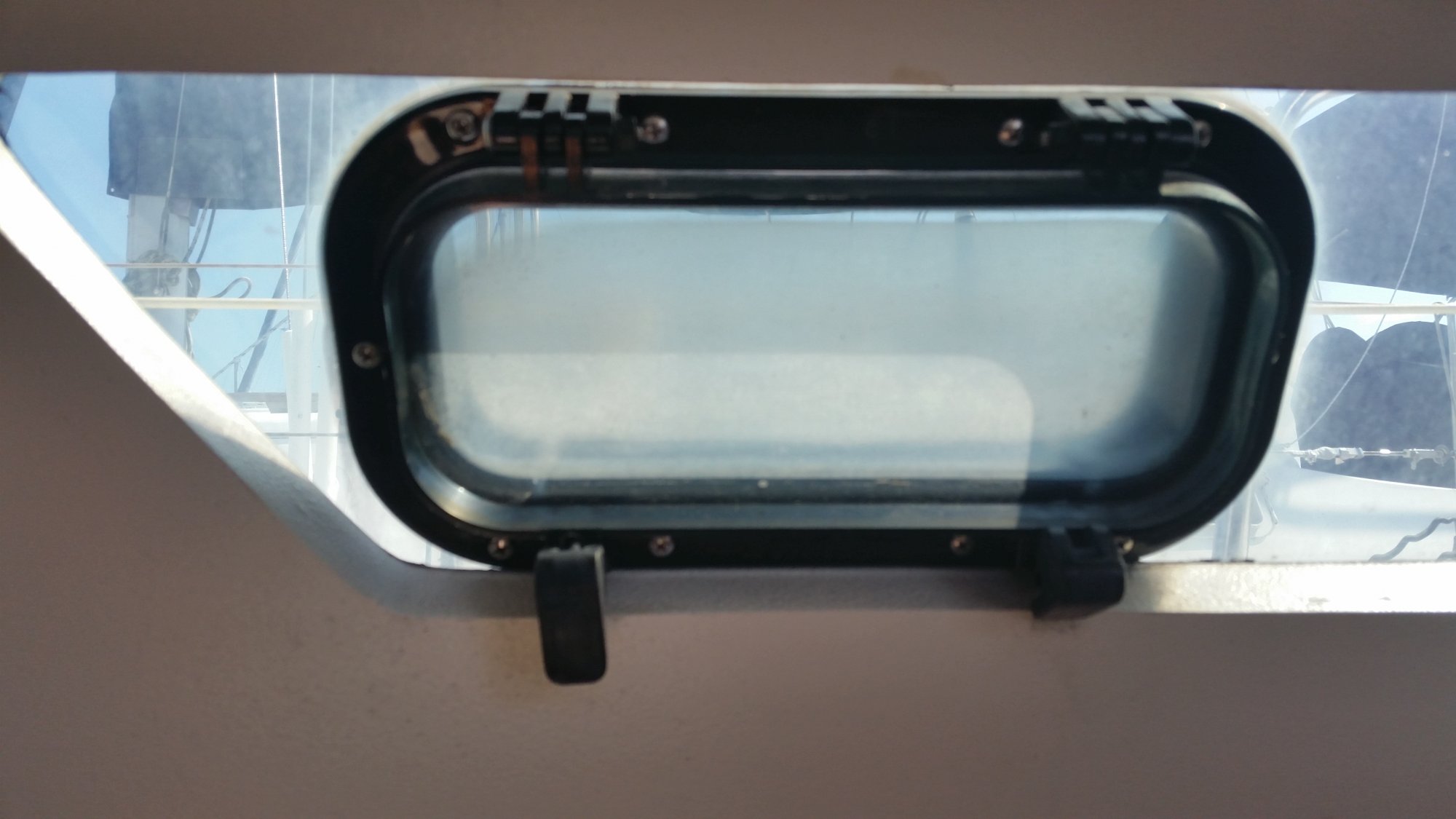

I need to replace the gaskets, screens and lenses on these ports, but have no idea what they are. Pretty sure they are not Lewmar. Any thoughts?

It's a Beckson Newport. Personally I hate them and want to do something different when the time comes. Bomar or Newfound Metals maybe

The name of the Manufacturer should be printed somewhere in the frame. Check Bomar-Pompanette LLC. They have Gray, Hood and other assorted fabricators.

If it is the same one that is above the stove, it is a Beckson C-310 CP-26 10 x 4. I replaced mine in 2015 because a crew member turned the close knob too tight and broke it out at the mount. I tried several different repairs, gave up and bought a new one. At the time it was $175. Expensive at half the price.
I'd very much like to meet the engineer that designed it and let him/her know they need another line of work.

Thanks All. Definitely looks like a Beckson Rain Drain (Opening Ports by Beckson or PO310). Since I am not in love with them, just need to repair or replace perhaps I will consider alternatives.
FWIW, it looks like this site carries all the replacement parts I need. Big item is a new lens as one is cracked, but the screens and gaskets are pretty reasonable. Just going to double check the sizes and get them.
