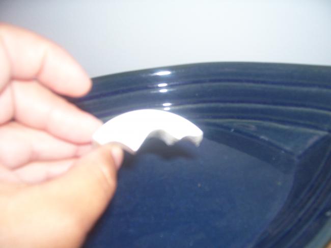

Hi guys and gals! This little white piece came off I believe off of my roller furling main?I believe it to be broken in half and I got only one part of it. How important is it? Does anyonne know what this piece is? p.s. I didn't do it;) My Thanks, B/Seadance

Got to do a Harken tour because of some friends and noticed their furlers are shipped with plastic spacers for protection. If this is a new boat or a Harken unit, my guess it's a spacer someone forgot to remove during commissioning.

Insert for aluminum tube??
My roller furling had a little plastic insert to match the round tubing on the end with the bearings to the rectangular cross section of the aluminum track. When it broke the bearings were off center and I couldn't use the furling. I had to order a new one. My roller furling is a SeaFurl 5. Your's might be simular.

Don's right, since only YOU know what
kind of furler you have, go to the manufacturer's website (unless you already have a manual and parts list) and find out what it is. You didn't mention the brand. Or check with someone on your dock who has one and really knows about the equipment.

I don't recognize this piece, there was a broken sheave in there if I remember correctly. Not sure if thats it or not. By the way, this is a Cruising Design furler.

Maybe it didn't belong in there
in the first place :). Does it work better now? r.w.landau

Reefing furler
Check to see if you can still reef the headsail. After a very similar looking piece fell out of mine, I now have two sail positions....in or out...:(
