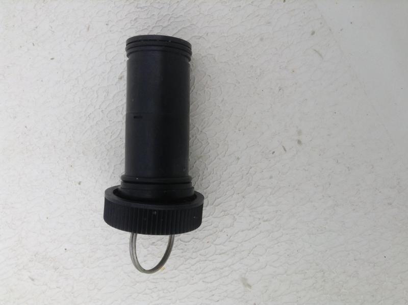

What is this part?
Sep 14, 2013
26
Hunter 26 Harbor Town Marina, Lake Allatoona
When I recently bought a 1994 H26, I found this part in the lower step with the water ballast valve. It is plastic and has O rings at upper and lower points and is 1.5 inches in diameter. I can't figure it out. Any ideas?
Sep 14, 2013
26
Thanks. I am pulling the boat out soon and will check it out.
May 6, 2012
303
Hunter 28.5 Jordan, ON
You're welcome. You would normally replace the thru hull with the plug before hauling out, to protect the paddle wheel/axle from damage from the travel-lift slings.
Jul 6, 2013
9
Hunter 29.5 Lake Perry
You can also pull your knot meter out with your boat in the water and replace it with the plug. Clean your knot meter at your leisure and the swap them back out.
Les
May 8, 2004
375
Hunter 27 Bellingham, WA
You can also change it while underway. Just go full speed under power and pull your knot meter. Very little water will come in and you can then insert your plug.
