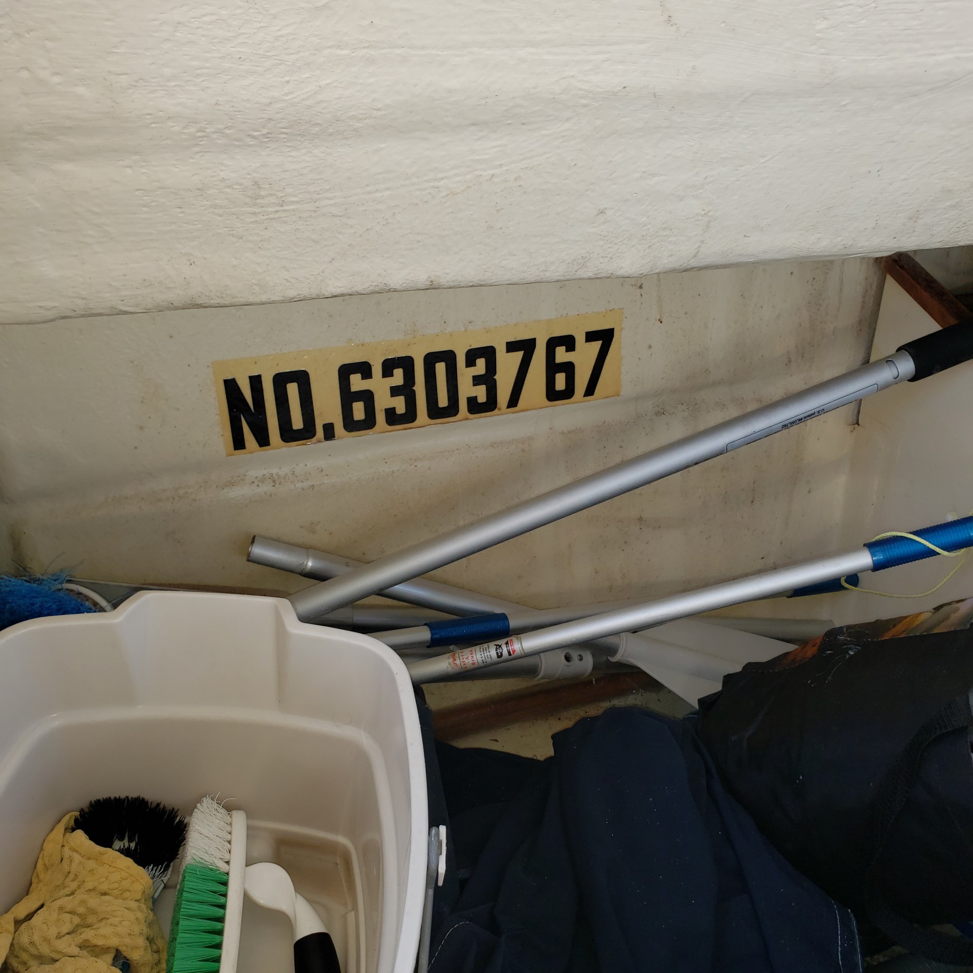

Hi all,
I recently purchased a 2007 sailboat. In the cockpit lazerette is what looks like a coast guard documentation number... but isn't.
The boat was documented by its original owner. The correct official number starts with 119. Second owner had it removed from documentation. I just successfully re-activated the documentation status ( with the original official number). I have all of the paperwork showing this history. I bought is from the dealer that sold it to the original owner.
So, what could this other number be? It is not a legitimate official number according to searches of the coast guard database.
I'd like to put my correct official number in that spot, but don't want to make it look like I've tried to hide a previous number.
Any ideas?
Thanks!
DougM

It certainly looks like a USCG Documentation number.
If it can be removed easily, I'd pull it off and put the correct number there. Is the correct number anywhere on the boat?

No, I haven't found the correct number anywhere on the boat.
Very weird.
Please note that the CG has an active list (searchable on line) and an inactive list of Document numbers.
You may need to send the CG a letter or an email asking the question. This may take a bit of time.
If you have now a documented the number with the CG any previous number is inactive. If you are sure that the State recognizes you as the owner. Then you are within the law to alter the number, in fact you must place the documentation number on the hull to comply with the rules of the CG.
It sure looks like it could be a previous CG documentation number.
Not sure about others, but my Documentation number has 6 digits.

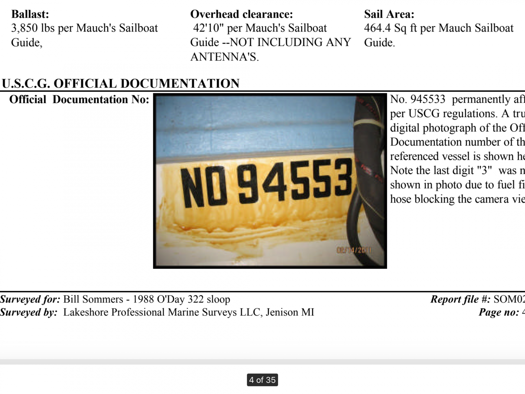

Not a Hunter, but this is in my port lazzarette...
noted on my survey as USCG registration number...

I have a 7-digit USCG documentation. “If it looks like a duck, and quacks like a duck...” With what looks to be 3-in numbers, fixed to the hull, beginning with “NO”, it’s a duck. Question is, why is it not your duck? :doh: I think I’d remove it and put the numbers there that match your documentation certificate. Otherwise, who knows what might follow if you are boarded and the numbers do not agree.
24,767
Notable is what looks like UV faded Epoxy painted over the numbers. An attempt to make stick on numbers “permanently affixed to the hull”?
