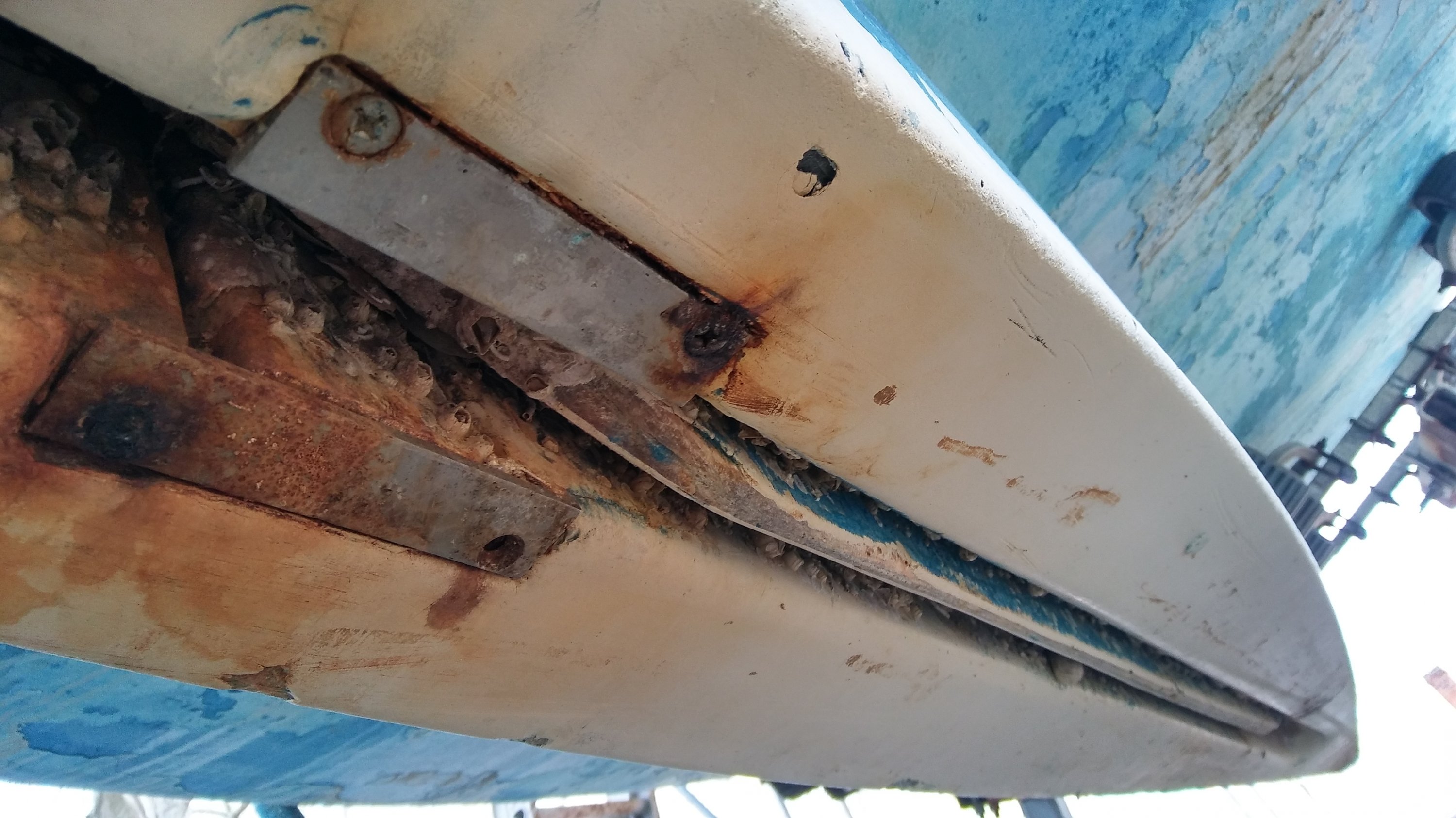

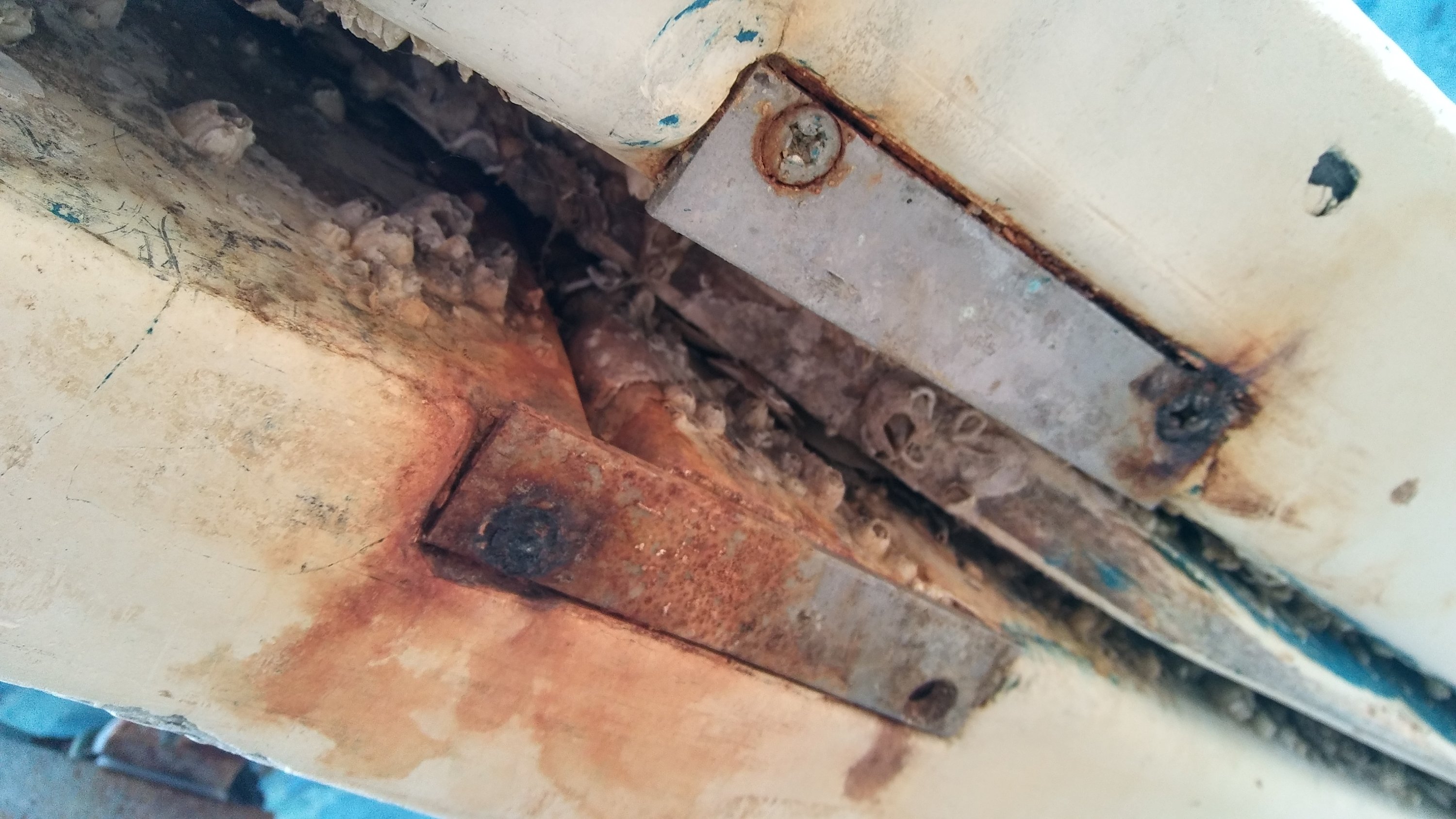

Hello! and thanks for looking! I may have finally found the project boat I've been searching for. 1983 O'Day 23. There's no core rot, anywhere in the boat. Some of the plywood covers and bulkhead walls need replacing. The previous owner demasted it under a "low hanging" bridge. I can redo the tabernacle and rewire the whole boat, re-bed, paint and everything else. The only thing I'm not sure of is this. The swing keel is stuck up in the shoal casing which I'm assuming isn't lead but cast iron. I'm thinking it will drop if I take a thin saw and remove the barnacles and rust. However, as you can see from the pic. The two stainless pieces and their associated screws are pretty rusted out. What do these things hold in? What do the screws, screw into the cast iron? What kind am I going to find up there? The whole cast iron rusted out? What the worst and best case scenario for $$$ and time to repair? ALL suggestions welcome. Seller is moving and is motivated to

I think the shoal keel is lead. The fiberglass centerboard is held in place by the two plates at the bottom which hold the two wedges above the plates which hold a pin at the top. My guess would be there is a pin up there which is rusting. I thought those pins were Delrin. If the shoal keel stub were cast iron, wouldn't there be rust all over the centerboard?
Anyway, you can rest easy. Keel and centerboard maintenance isn't too difficult.

Keel is a fiberglass shell molded as part of the hull, ballast is made up of lead blocks set inside the keel shell and surrounded by poured In resin.
"Envelope “ keels. Boat hull & keel is one piece molded. While boat is still in the mold, pre-cast lead ingots (4 piece of lead) are placed in the keel void; glassed in place with resin; then the completed unit is extracted from the mold. An efficient, no maintenance way to attach keels.

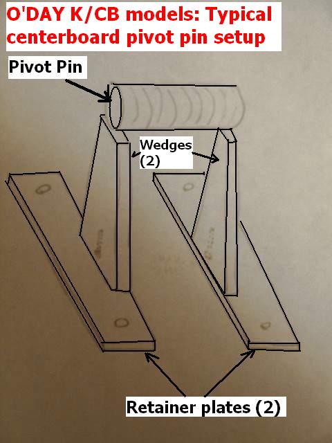

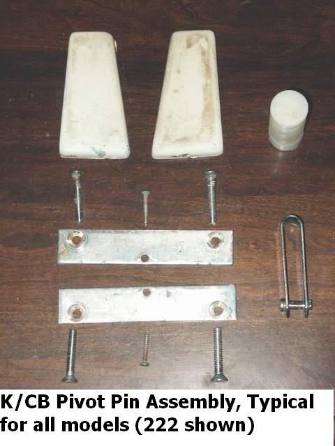

The Centerboard (NOT swing-keel) is a fiberglass molding, weighted with about 15# of lead inside. Those 2 stainless-steel plates are screwed into a pair of metal plates embedded inside the keel shell, they hold in a pair of fiberglass wedges that in turn hold the CB pivot pin. See drawings below. Pin was originally plastic, rust could still be from the stainless steel, not all stainless is rust-proof, in act most is only rust-resistant. I think metal strip or very thin saw blade will help remove all those barnacles, I use a piece of steel strapping with a tape wrapped end for a handle an work it back and forth between CB and trunk sides. The DS II CB trunk is just wide enough for my CB and it doesn't take much scum and algae to "gum" it up, although since I rarely raise the CB all the way (I'm on a mooring), I almost never have it get stuck during the season.

Thank you both for yuur insight. My question is, If we are dealing with lead here and not iron, Where is all the rust coming from? Those screws should be stainless???

As I say, "Stainless-Steel" is not rust-proof, it is rust-RESISTANT. There is also always the possibility that a previous owner replaced the original Stainless screws with plain steel screws. From the pictures, I suspect that is what happened. Stainless-steel can actually "rust" if sealed off from oxygen, such as can occur if painted over or coated with anything that would block air/water from reaching the surface, as it is a thin layer of oxidation that keeps stainless "Stainless".

Ok best case scenario would be that the previous owner, used bad screws and once I get them out and clean up the centerboard I screw new SS screws in and all is well(?) worst case would be what? the plates the screws screw into are also rusted, and they dont hold the new threads? The plates are sealed into the lead keel so getting to old ones out and replacing them would be a big issue? yed?

If you find the plates rusted, you could easily re tap to a larger diameter size. You won't know exactly till you disassemble it.
Your keel is encapsulated lead, your centerboard is fiberglass with some lead weight added.
Should not be too hard to fix.

I agree with Sunbird that the rust is from the plates and screws. Not sure what metal the screws go into but mine came up with rust around the head, not the threads.
I think your biggest problem will be getting the screws out so you can put new ones in. I suspect if needed you could up a size, tap new threads and be OK.

I bet those screws are the rust. My freshwater O'Day 25 had nothing like that. I'd remove the screws an drop the whole assembly, make sure the line in the cockpit is not tied off. Then clean out. I would not be too agressive with a saw blade, damaging the centerboard could be 1/3 of you purchase price.

The reason those 'stainless' screws are rusted is because not all stainless is the right kind to be used under water. Those screws are probably 304 stainless. 304 used to be used in topside hardware and wire rigging. 304 is actually stronger than 316 but not as corrosion resistant. For underwater applications only 316 SS should be used. When you replace the screws make sure you buy the right kind.

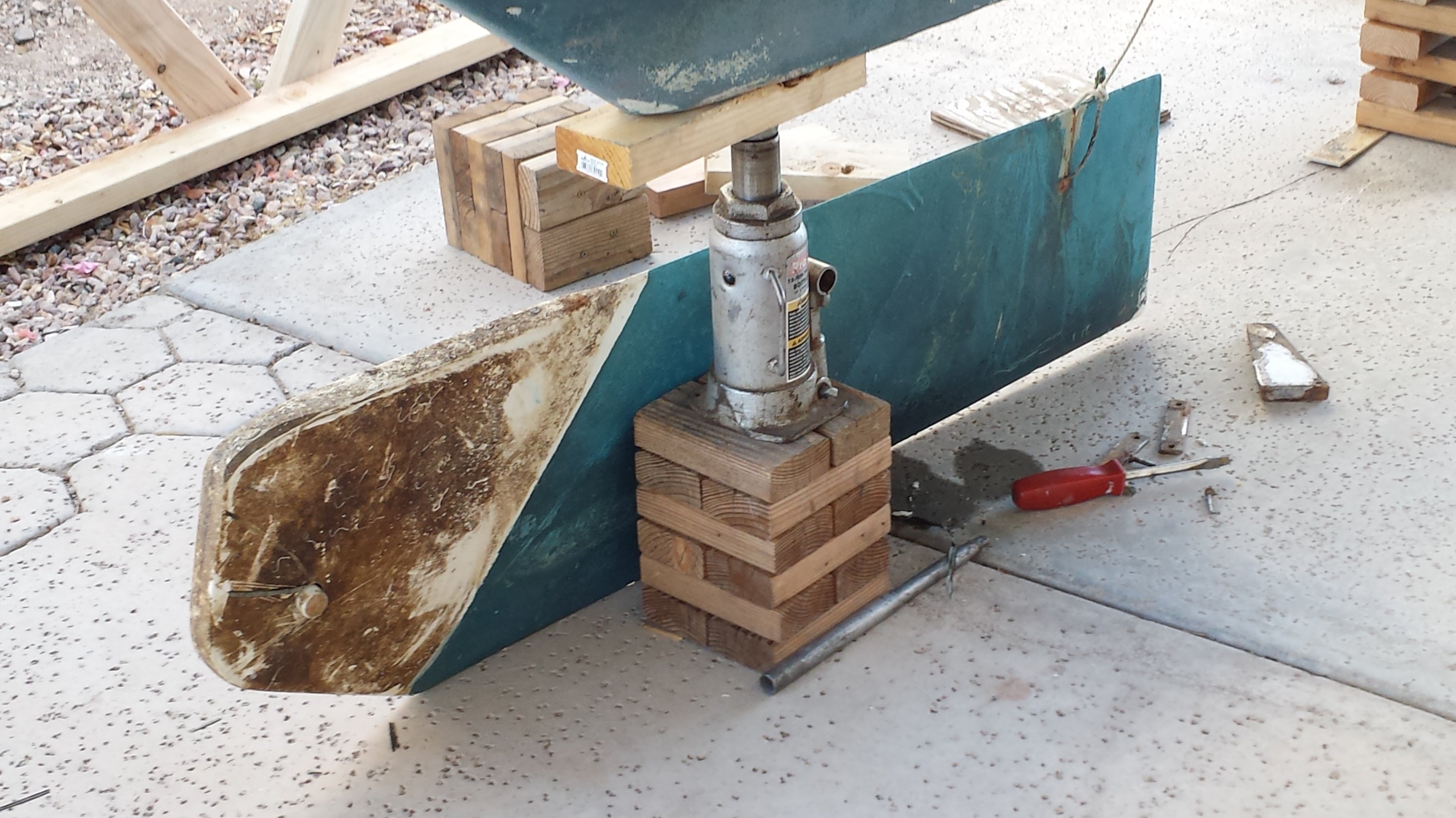

Here is what it looks like when you get it out. Maybe someone replaced the plastic pin with steel or there is a broken off saw blade in there. Good luck.
