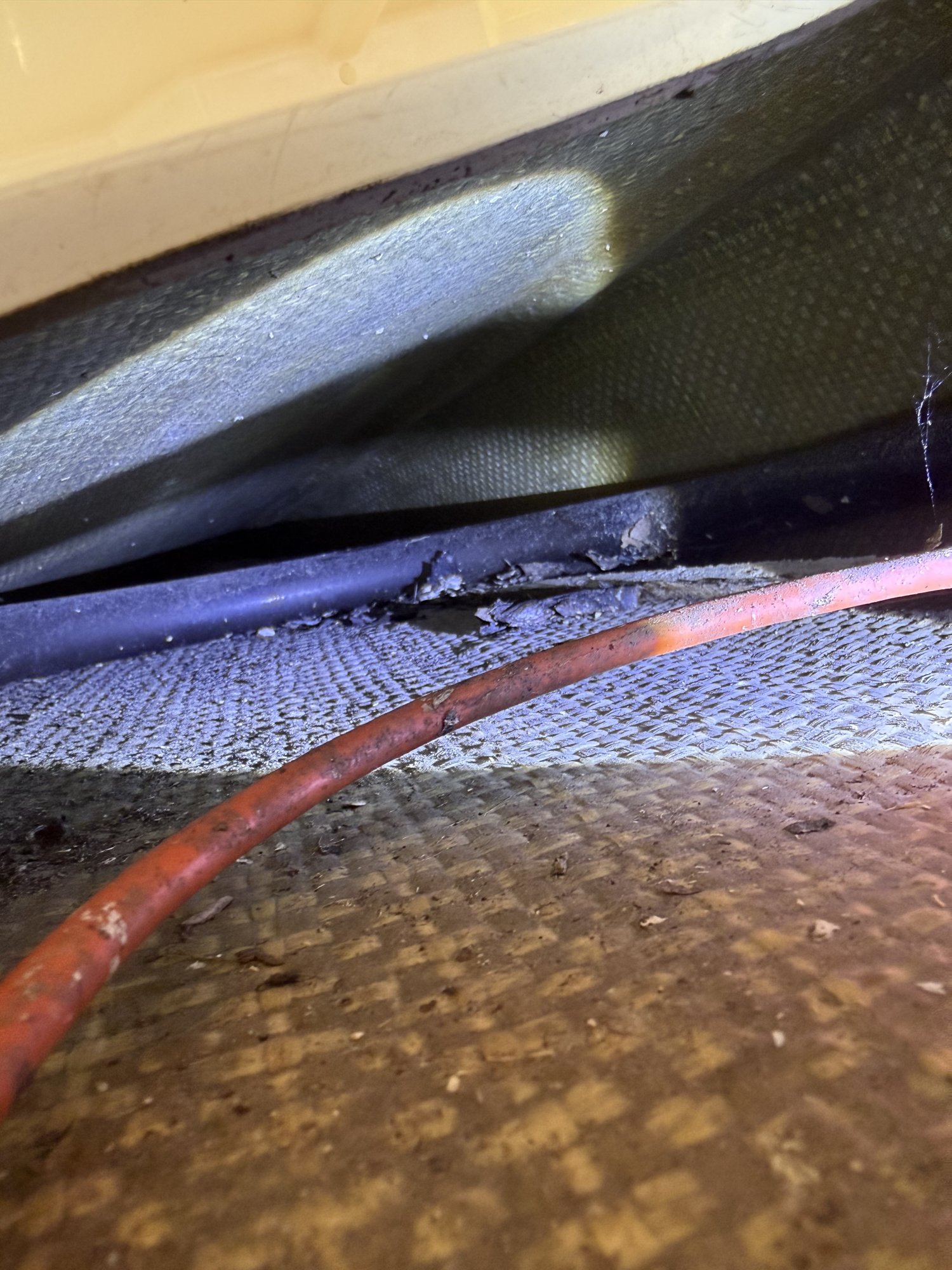

So now that I’ve got that all out while cleaning my new found treasure I ran across this 1.25” clear hose in the bilge under the aft birth on the starboard side. One end is not connected to anything and the other end goes up over the water ballast tank and disappears just aft of the water ballast fill valve compartment. The sailor in me is freaking out at the thought of an un-terminated hose just lying in the bilge. I’m thinking… maybe a vent for the water ballast but why so large, there is already a vent with a boat plug in it next to the ballast fill valve and why would it not connected routed overboard? Any ideas would be greatly appreciated.

And you can't see where the other end goes????
What happens when you yank on it?

Assuming the mystery end isn’t accessible, try blowing compressed air into it or pulling a vacuum on it, either of which can indicate a path to its source.

Hoses in a lazarette often are cockpit drains. Did you look up for a nipple that it might have been formerly attached to? Might help with your accumulating water problem.
Are there any thru hull or thru deck fittings in the vicinity?

It’s attached to something at the end circled. No hose Is visible from the port side bilge access.
I thought about pouring water in the freezer end and opening the ballast valve and see if it come out. Was hoping someone would say “Oh yeah, that’s the Johnson rod hose and it’s supposed to be there like that” or something. Might have to do some more digging.

The PO didn't want to snake his hand under the tank either?!
I've never owned a water ballasted boat is I can't help you there. Good luck.
After 8 years in the Navy I don’t tell anyone some of the places my hands have been so yeah I snaked my hand in as far as I could and no luck. The water originally came from a disconnected cock pit drain hose and 10 years (I’m assuming) of rain. The previous owner noticed the trailer sticking up in the air when he was driving by where he was storing it.

Run something up the hose like string trimmer line. If it stops somewhere you can't see cut it and attach your drill to it, you'll be able to hear it flopping around.
I’ll give that a try.

That was my first thought but I don’t think so. It definitely connects to the top of the ballast tank. Now I just can’t imagine why MacGregor would attach an un-terminated hose lying in the bilge.

I think you might be right. Poured water down it with water ballast valve open and water came out. My question is who thought it would be a good idea to vent the water ballast in to a bilge with no bilge pumps. I think I am going to run it over to where the sink drain is and “T” it into the sink drain with the appropriate check valve of course. Don’t need water coming in when the boat is healed over.

If it is really old hose you may want to replace it so finding the other end is kind of key. If you remove cushions and hatch covers and maybe floatation foam you should be able to find the other end. If it is the vent pipe it may have once run to the anchor locker. Some people run a hose there to avoid having to use a plug.
