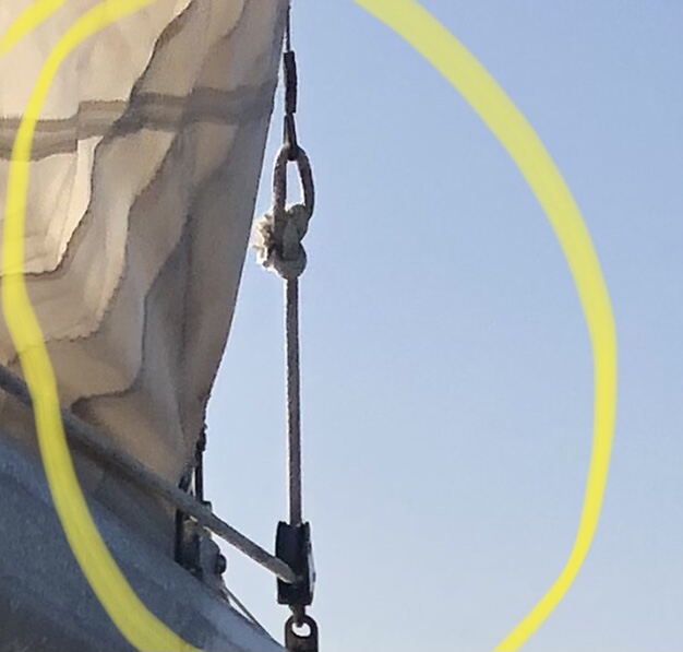

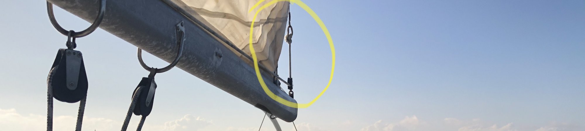

Good evening folks,
Was just wondering what this piece of the boat was called and whats the use as well? It looks like the line will gave way soon so I was going to cut and put a new knot on. Any suggestions any which knot I should use?
Thank you.

Thats the topping lift, that holds up the boom. In your case it is an adjustable topping lift.
I like to use a halyard hitch, which is a compact knot, when possible but you could also use a bowline.

Thank you sir, and is this piece used to raise and lower the boom for angles of sail or reefing or what exactly?

A goofy arrangement for a topping lift, but not unusual at all, wire/rope combination. You can run it as a halyard, better in my opinion, but there is really nothing wrong with that, as Kings mentioned, it is only for holding up the boom when the sail is down.

Its main purpose is to keep the boom up out of the cockpit when the main is lowered. When you raise the main it should become slack. Some prefer the boom to be higher and out of the way when not sailing so you may be adjusting it often.
It's not used for angles of sail or reefing, except to keep the boom from dropping into the cockpit when you ease the halyard.
I set mine to keep the boom above the dodger. When I raise the main, it is slack so it doesn't need further adjustment.

And it looks like it's tight with the sail up. It shouldn't be, that adversely affects the sail shape. Slack it off a little, the sail should take all the weight of the boom. If that makes the boom too low with the sail furled, that's why it's adjustable.

It just holds the boom up at a desired angle. Can be used to clear cockpit headroom at anchor. It also supports the boom to allow it to be used as a crane arm to lift supplies into the boat. Some even use it to clear the front of a bimini top at the expense of sail shape.

Thank you very much guys, very informative. I am self taught and mainly just use the sheets and halyard for the most part, just noticed this the other day and thought it didn’t look good, fraying and such. Will definitely give it some slack, would have never known!

Converting your topping lift to a halyard makes no sense to me because the adjustment is at the leach end of the boom.
As to what kind of a knot, you may like the looks of an eye splice on the end of the new line instead of a knot.
