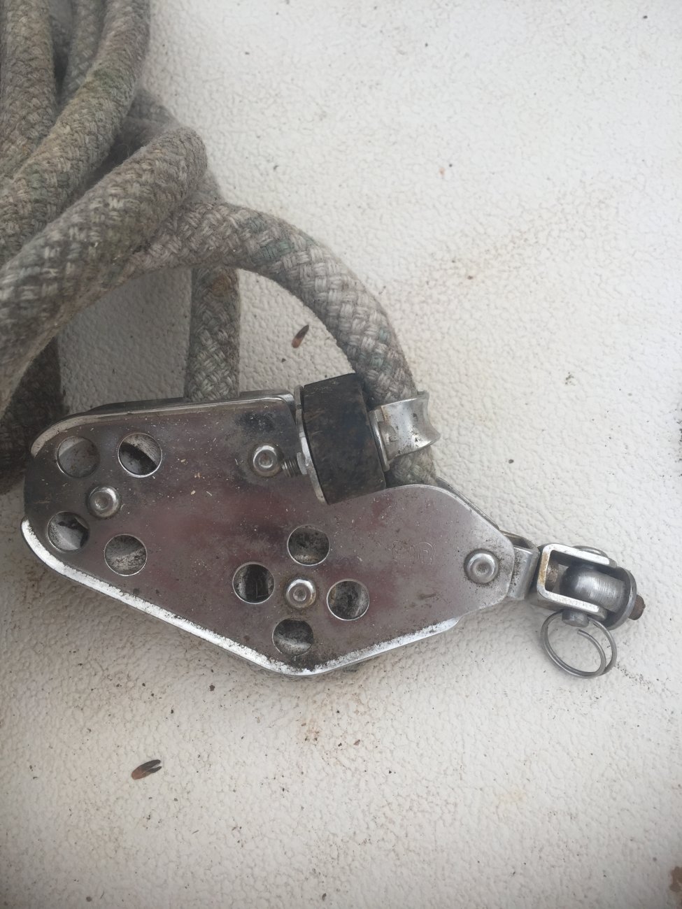

What is this and how does it work

It is called a "Fiddle Block" and it is usually used for holding sheets in place. Looks to be broken though
Aug 3, 2012
2,542

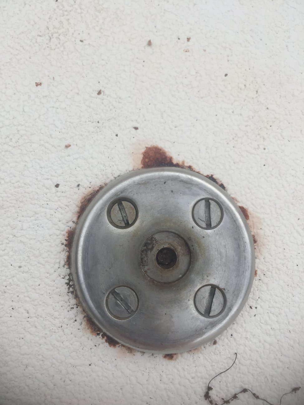

Looks like that was a standup fiddle with a cam cleat. Looks like it was for your mainsheet. You can find those parts at Schaefer Marine, Harken, Ronstan and many other places. The pin at the bottom usually has a spring where it attaches to the deck to keep it somewhat upright. The plate can be removed in order to replace the pin and spring. Then you can rebed the whole thing. I would guess that one is a Schaefer.

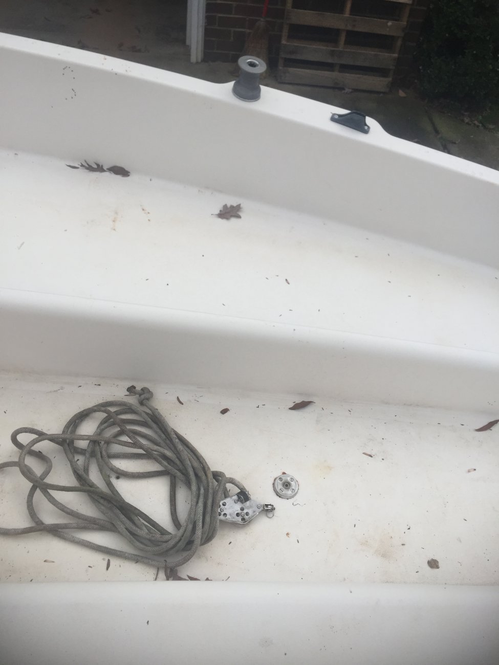

Yes. That is your main sheet (the rope that controls the boom) tackle. The part you showed us in the picture attaches to the cockpit floor. The other end to the boom ... I"m guessing about mid-way in the boom is a bail (a metal loop) and a shackle is used to attache a second block (pulley) to the boom.

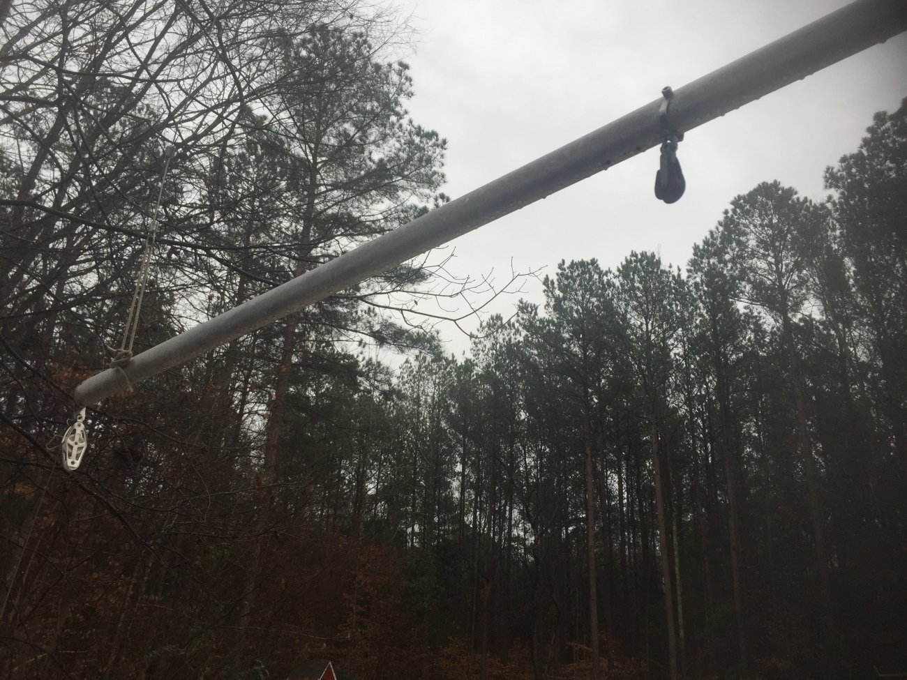

Here some pic. I feel like I'm missing something
Okay so the main sheet (rope) goes up through that block on the boom and then down to the cockpit floor where that fiddle block is supposed to attach. But your's is broken and needs to be replaced. The sheet comes out of the fiddle block and through the cam (the clamp). You pull the line and it brings the boom to the center of the cockpit.... or you release the cam, let out some line and the boom swings out from center line. That is the mainsheet control for your boat. It lets you spill wind as needed or trim the sail to the right angle.

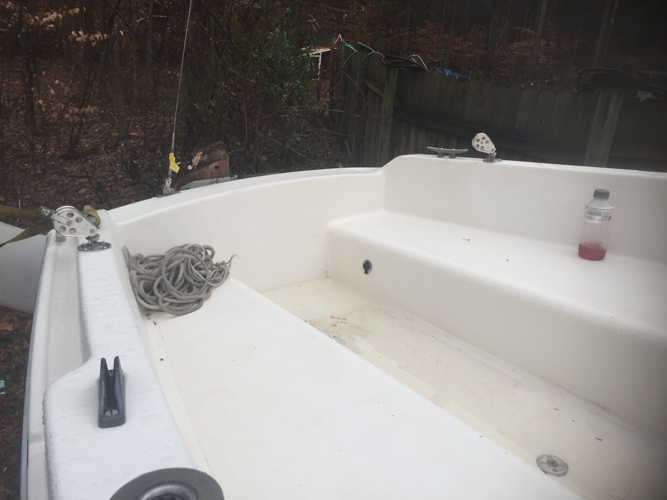

Your main sheet should tie off to the loop ,on top of the block on starboard, run up to the boom, down to block on port side, back up to boom, then forward to the single block, then down to the fitting that is broken . That's what my old SJ 21 had anyway

That makes sense. It would seem I don't even need to use this tho. I could run the sheet to the port and starboard pullies in the back of the cockpit then to the back of the boom. It would take everything out of the way.

As it is, you are already lacking a traveler which will make sailing to windward less efficient. A traveler is a device that lets you adjust where the fiddle block is in relationship to the center line of the boat. When sailing to windward, you move the fiddle block to the windward side of the boat thus allowing you to pull the boom fully to the center line of the boat. With the current configuration of your boat, you already will lose a few degrees when trying to get your boom to center line, if you use the spinnaker blocks, you will lose a few more degrees. So yes, you could do that but you will not be happy with your windward performance.

Anyhow, that's the basic idea. The spring at the base of the block keeps the block from falling over and hockling the sheet when tacking. That's the part that's missing.
