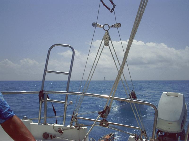

I mean what is the advantage...? I have seen single line hydraulic pull downs, glorified turnbuckles with big wheels, and all sorts of contraptions to "squeeze" a split rear stay...
What for and when do you yank it...??

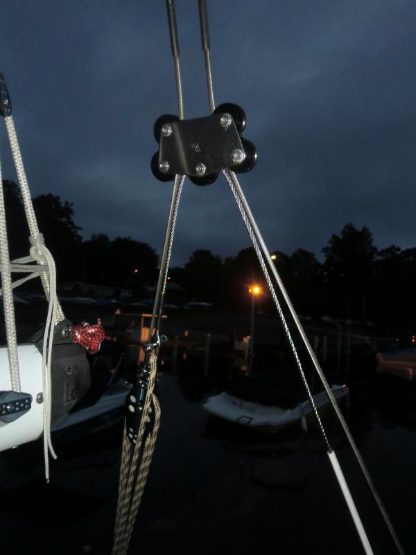

I have a masthead rig and several years ago I did add a squeeze type tensioner (like the one in your photo) to improve upwind performance by reducing the jib's headstay sag in anything more than a light breeze. The advantage is noticeable to me.
I also had been uncomfortable cranking down really hard on my bow/stern turnbuckles and maintaining the higher tension 24/7/365. When not at the boat, then tensioner is relaxed.
Philwsailz, you are right that a backstay tensioner on a masthead rigged boat doesn't induce the mast bend effect as for a fractional rig. But it does induce some since the lower forward stays tend to keep the middle part of the mast from moving back as the aft stay tension is increased. But the extra induced bend is only an inch or two on my boat. Probably has little effect on my mainsail trim.
