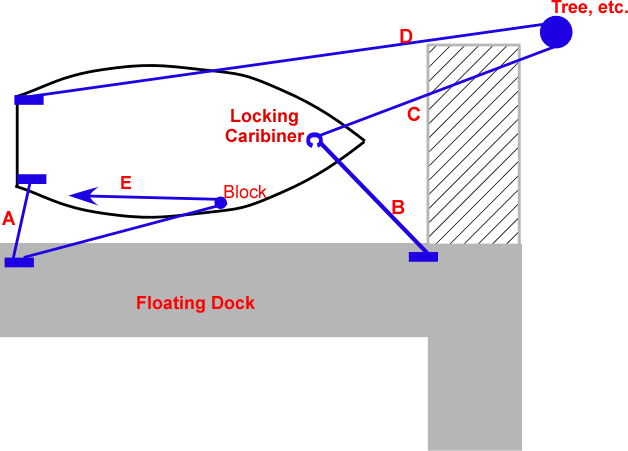

Mr Bill is correct. With the dependence 'solely' on the fenders to keep the boat 'away' from the dock, if a fender ever becomes 'displaced' (no longer between the boat and the dock) due to wave action ..... you're going to have to consider the possibility of some future gelcoat, etc. repair.
Thats why I recommended using straining lines (Line "E" in my previous diagram) to keep the boat 'off' the dock.
Some folks use 'dock wands' .... stout and long and tapered fiberglass 'rods' which are 'base connected' to a spring ... like holding the boat off the dock with a fishing rod and line ... the line connected to the boat, the rod 'well bent' so the boat is kept 'off' the dock by the action of the spring and bowed rod trying to 'straighten' themselves out.
Dont depend on 'fenders' to stay put in a storm.

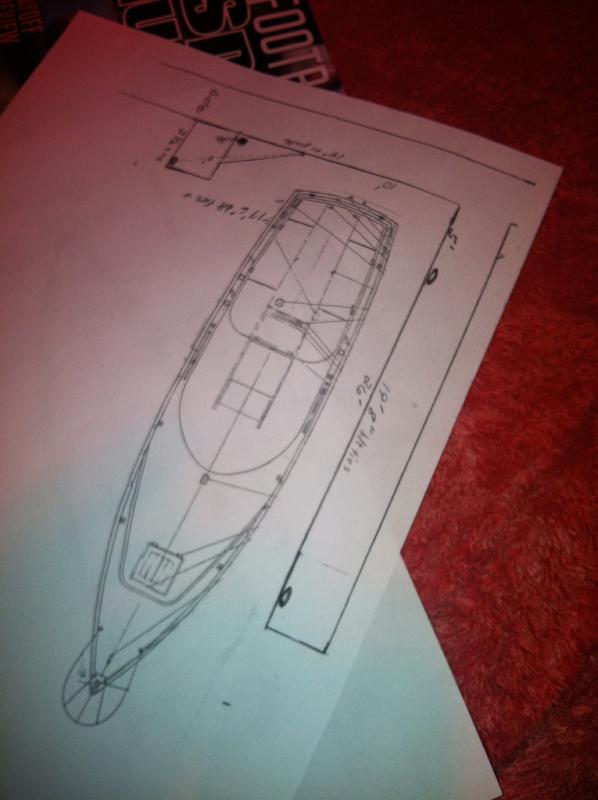

As the new guy on the dock, I think it vastly important that I not attract attention to myself too much, by going past accepted traditional approaches to simple things like docking the boat. Putting whips on the dock may work, looks interesting, but I am not going there. Not till someone already there try's it first. Braiding dock lines is as radical as I am prepared to do my first year. Lol
I already will have the odd boat on the dock, mixed in with $40,000 boats well above my pay grade. I need low profile solutions.
Oct 6, 2011
678
CM 32 USA
This drawing is to scale for my 30 foot Clipper Marine and my dock. I have a short finger that should be just fine to keep the mooring lines snug and keep the boat off my finger dock. The main finger dock is 26 feet long and the stump finger is a little over a yard long.

I believe I will do a rendition of this posted diagram. That should work well with my situation.
I will keep some fenders on the dock, and maybe add some bumpers as well, just to cover all bases.
I will be using 1/2" nylon double braid mooring lines, and also one spring line to keep me well clear of the main dock.
