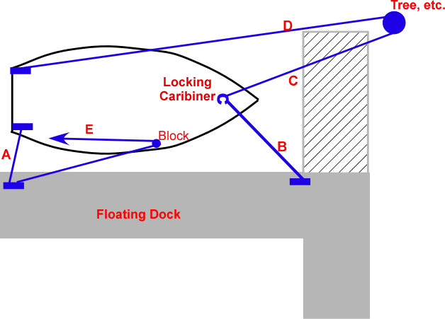

Here's a successful way to tie up to an end floating dock or a floating dock that has no center-end piling between two floating docks/piers. Note: this method will NOT work with a 'fixed' or non-floating dock.
All lines are set Tight and with the boat 2-3 ft. off the long portion of the dock. Waves will cause the floating dock and boat to 'rock' but will be closely 'in time' with the boat for most 'lake' applications. In this configuration you need NO 'fenders'.
If there is 'face' portion of the dock in front of the bow all the better - just tie off to a dock cleat; if not use a tree or other immovable object to tie off to as shown .... the important aspect is that the tie-off points on the portside (as shown) are well off (at an angle) the centerline of the boat.
Set-up:
All lines are left tied permanently to the DOCK, etc. The bow-lines (B & C) are terminated to a shackel or locking caribineer for the attachment to a bow fitting or bow eye ... so that the 'connections' are the SAME each and every time you tie-up. Use 3 strand / twisted NYLON dock line - 'stretchy'. Use a figure-8 knot to attach the shackle or locking caribiner ... so the shackle doesnt slip between "B" & "C".
1. center the boat in the slip and with the boat's beam/side about 2-3 feet AWAY from the dock .... attach all lines to the boat except "E". Lines "A" & "D" are attached to the boat cleats with spliced eyes .... shove the spliced eyes though the base hole of the cleat and simply 'loop' the end over a cleat horn. Make all adjustments on the 'dock cleats'. Will take some 'figgeting' to get this alignment 'right' with the boat centered and @ 2-3' from the dock.
2. Fully Tighten line "E" (attached to a block connected to a side 'shroud', etc..... the boat will now move 'astern' and the stern will swing 'out and away' from the dock; "B" & "C" will hold the bow in position. Fully tighten line "E" (like how you pull a bow string) and cleat it .... I use a jib-sheet cam cleat. Line "E" controls the tension in *ALL OTHER LINES*.
2a. "test" the tension in all lines by forcibly pulling the boat TO the dock... pull the boat towards the dock with extreme force ... if the boat cannot possibly contact the dock when under such force - thats about the correct tension in "E".
3. if line "D" doesnt have enough 'side pull' (to keep the boat 'off' the dock) attach a block to the base of one of the portside shrouds/ chainplates and then run line "D" back to a stern cleat ... all set-up adjustments are made from the dock cleats (or immovable object) with the exception of "E" which is adjusted when you're ON the boat.
Only in 'storm conditions' will you need 'fenders' as the lines will stretch. Otherwise the boat will 'roll' with any waves and the amount of stretch in 3 strand nylon line will be 'automatic' to keep the boat centered .... and will keep the boat off the dock! Obviously you need 'strong' cleats on both the boat and the dock .... and the floating finger pier 'hinges' have to be intact and strong.
Ive been tying up my large sport-boats on floating docks in this manner for many years, only during STRONG winds/waves do I add 'fenders'. The good thing about 'end' floating docks 'on lakes' is that they are usually at the ends of the general docking area and are usually in a 'more protected' placement.

I have a tie point about where the letter "D" is in your illistration. I think your instructions would work. When the marina owner sees this, he will raise my dock fees because it works so well. lol
I may go with fenders and pull it tight to the dock. That would make access to the boat a little easier for old bones.

Walk down the dock, grab, or step down on either of the stern lines (per Rich's diagram) and the boat will spring to the dock for you. No chafe. Take "Line E" to your winch and you can adjust the distance from your boat.
